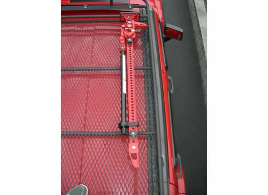

No judgement either way… this was almost 20 years ago on my H3. I made homemade clamps from pipe hangers with heater hose spacers and quick spin knobs. This was my final configuration after using different variations of the clamp idea in other locations.
