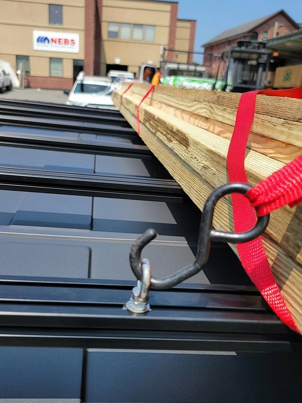

Using a "lifting bolt" (eye bolt with threaded stud) to strap down lumber:

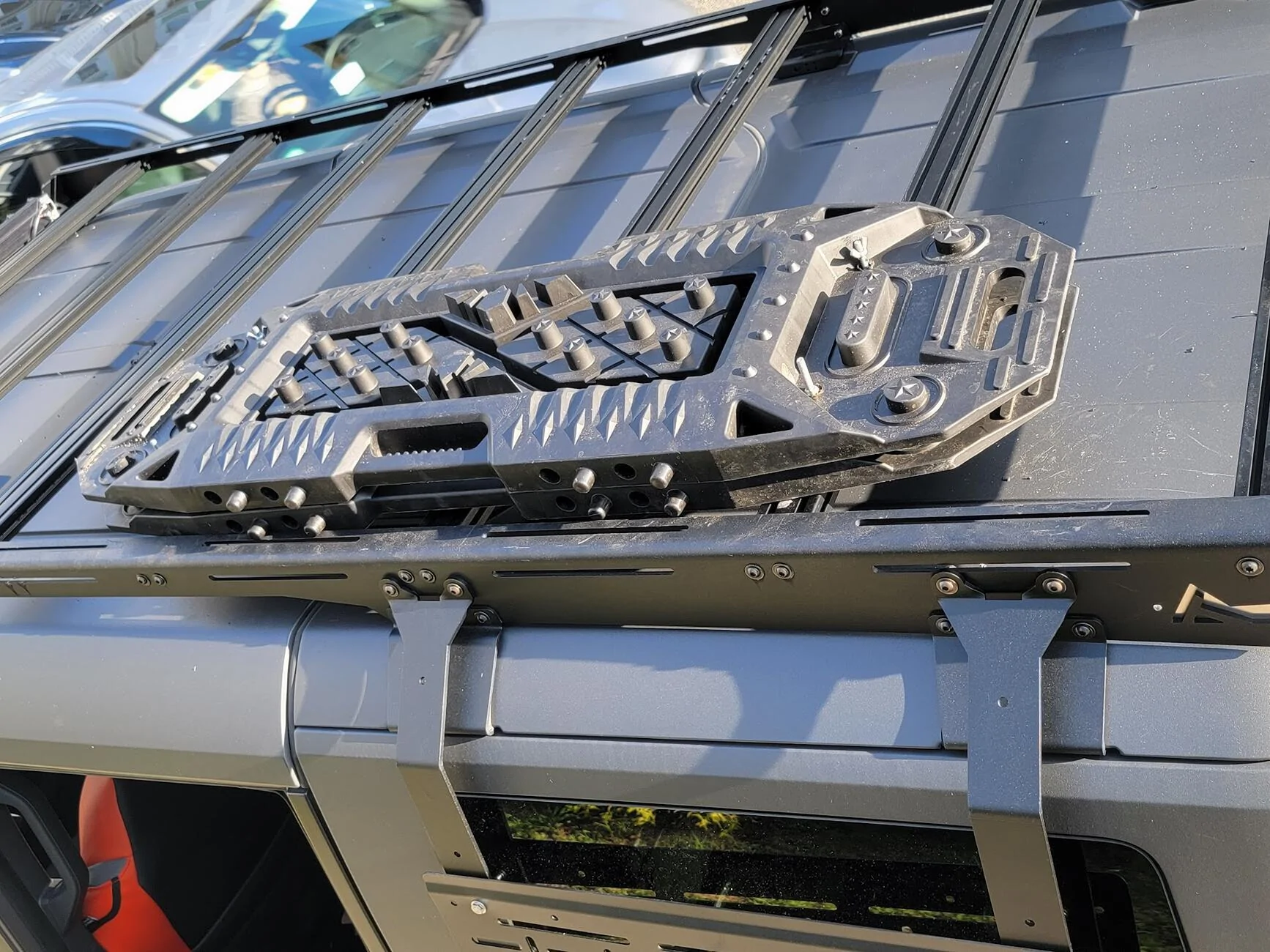

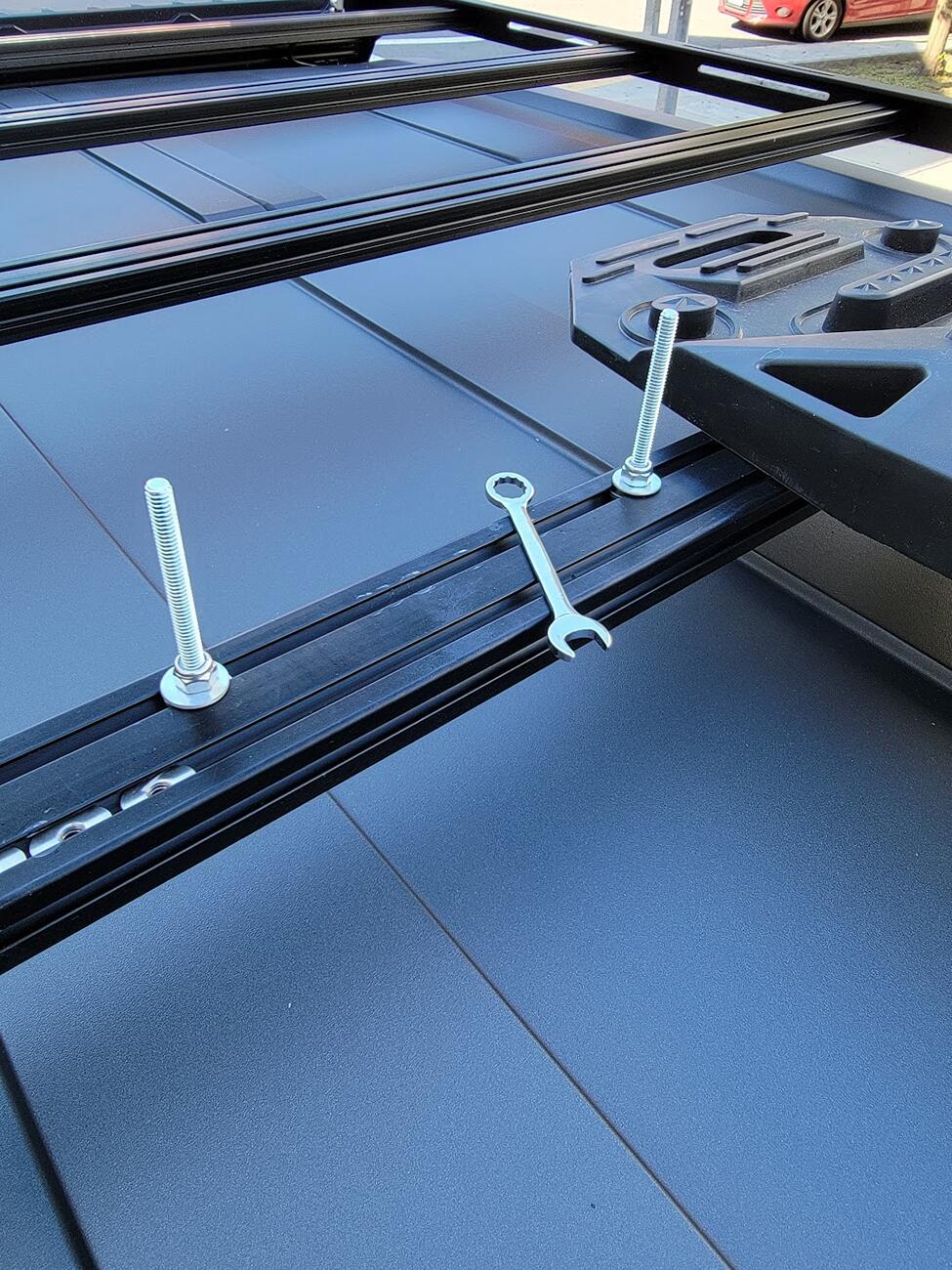

Using threaded studs to secure recovery boards. The install is: 1/4-20 stud screwed into T-nut, rubber washer, stainless steel washer, 1/4-20 nut.
Ford Bronco Trailrax Mounting Question 1722439062475-74
Now, with the recovery boards mounted:
Ford Bronco Trailrax Mounting Question 1722439276208-r3

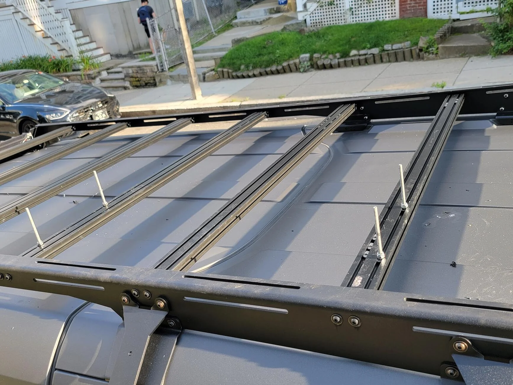

My set-up in progress. The thing is, be imaginative with common hardware. You don't have to buy expensive mounting plates and attachments. Everything comes off when I return home from backtrails, and goes into an organizer box. I use a commercial carwash, and I couldn't go through that with those studs sticking up!

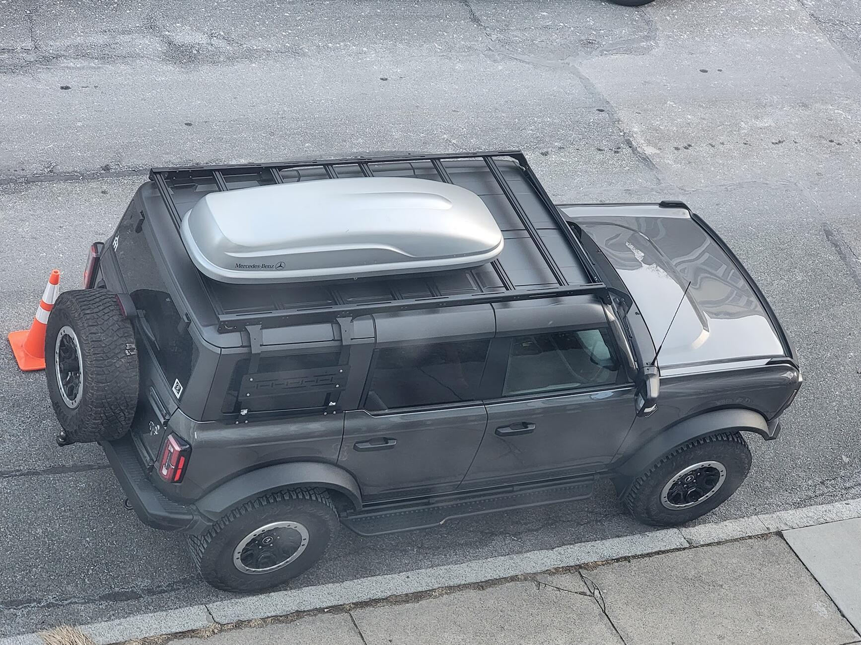

Lastly, my roof box. I abandoned the M10 hardware, and drilled a 1/2" holes in the bottom of the box. Getting it onto 4 posts is tricky; I recommend three people. But I mount it over 2-inch threaded studs, then put down a good, wide fender washer, then a 1/4-20 twist knob.
(It's a Thule box. The guy I bought it from [I'm cheap] put a Mercedez Benz decal on it--Mercedez is is thing.)

Oh--just noticed this unread post. My mounting system is as follows:
1) my stainless T-nuts are permanently in the crossbeam slots.
2) I take a 4-inch 1/4x20 threaded post, and put a 1/4x20 nut on it, about a halp-inch from the bottom-facing end.
3) I put a stainless washer next to the nut on the threaded post, and a rubber washer next to that. Thus, the washer and nut have a little padding between them and the aluminum crossbeam.
4) Now I screw the threaded post into the T-nut finger tight.
5) I repeat that three times, approximately where the holes are located in the bottom of my roofbox. (Carefully measure and plot out your front-to-back distances. The left-to-right locations can be more flexible.)
6) As it's tough to get the 4 posts lined up correctly with the holes in the roof box, I get a friend (or two) to jiggle and manipulate the roof box until all four threaded posts have worked through their assigned holes in the bottom of the roof box. The roof box is now mostly "set."
7) I use a skinny open 1/4-inch wrench and tighten down the 1/4x20 nuts onto the cross beams. (All four posts) (Note: You're tightening steel down onto aluminum--careful with the torque!)
8) Inside the roof box, I put wide 1/4-inch fender washers on the exposed threaded studs, then tighten the whole thing down with 1/4x20 knobs.
The whole system is pretty simple and straightforward. I do it in about 15-20 minutes. The trick is having a friend or two carefully lower the box onto the threaded posts while I jiggle them this way and that. A step-ladder or two is a big help.
