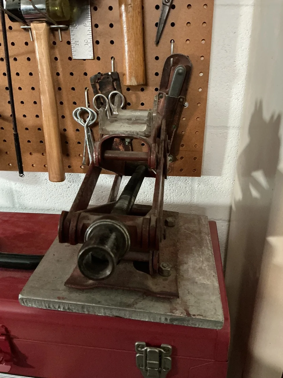

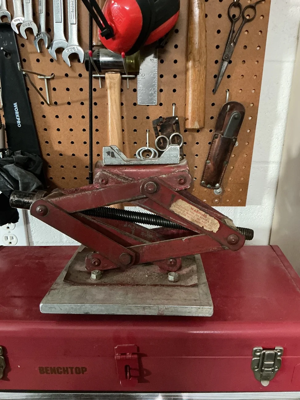

I use an old scissors jack. Aluminum base added for stability. Channel iron cut out for axle cradle and bolted to top of jack.

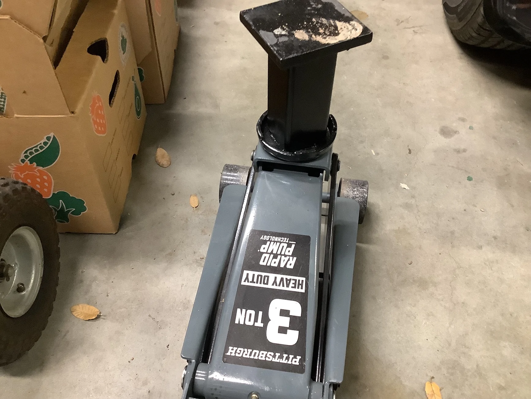

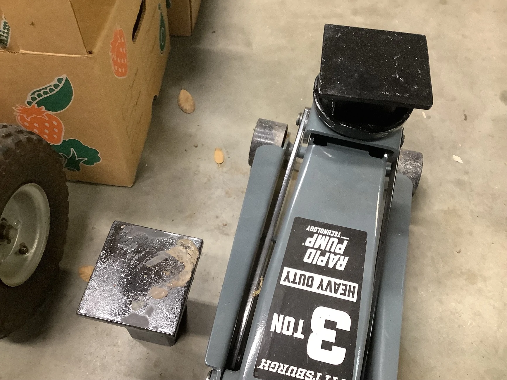

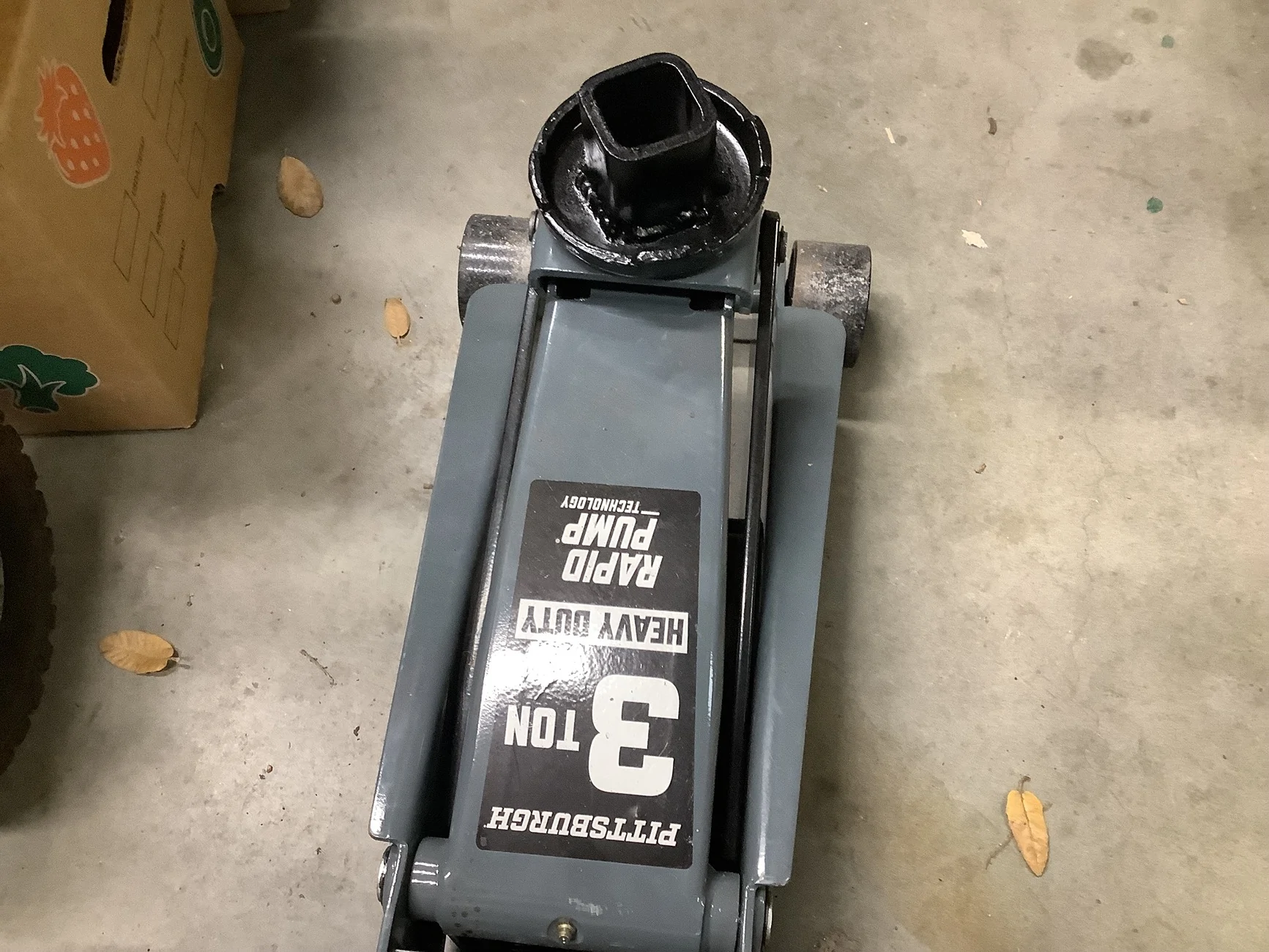

Maybe overkill…
