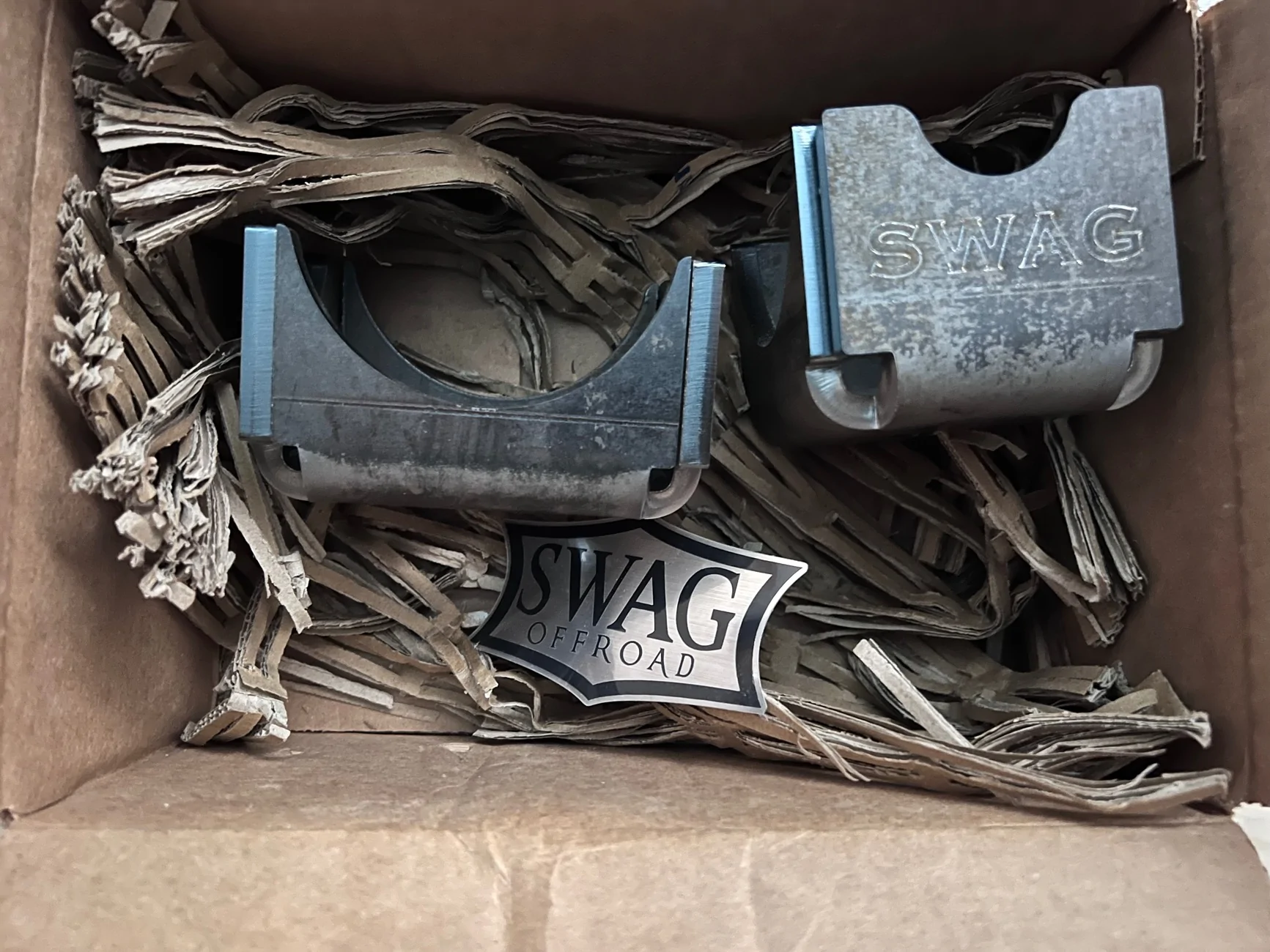

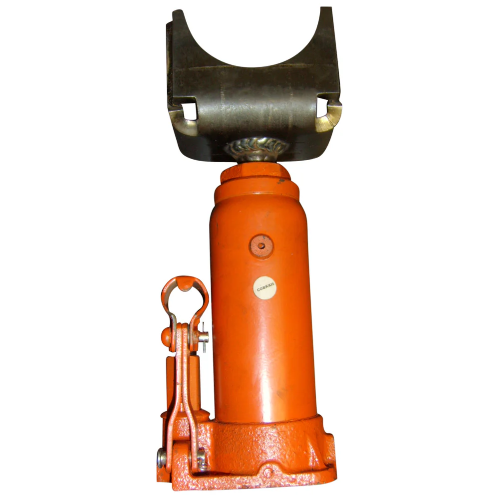

I purchased two of these to
1) to weld to a new ‘High Lift’ bottle jack looks like all high lift are at least 20 ton
2) fab/weld adapter for a floor jack
by lifting at axles you don’t need to lift as high as a body lift
https://www.swagoffroad.com/product...cradle?_pos=6&_psq=jack&_psid=8de54050c&_ss=e
If only someone made such an adapter for the front tires!

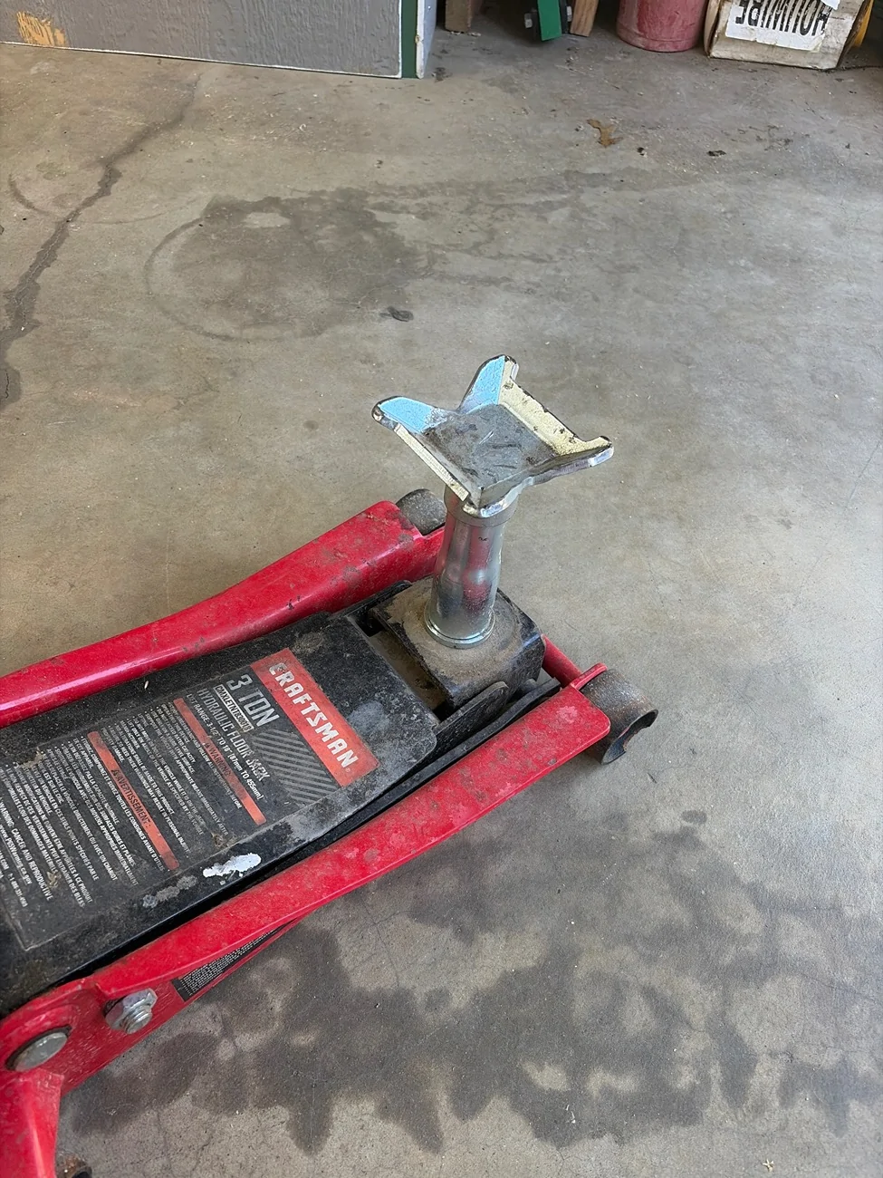

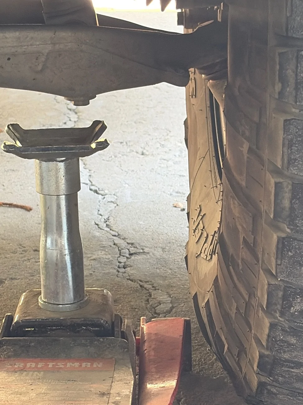

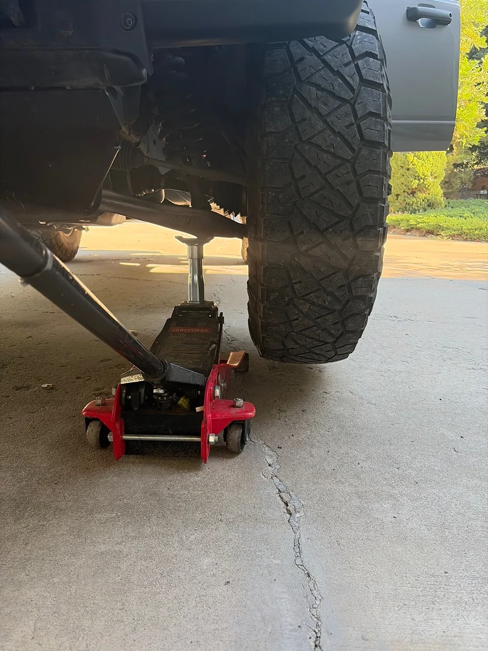

@Brian_B Could I get a look at what your jack/extension pad looks like that "can catch a shock mount bolt and not slide around"? I'm going to at least try to use the LCAs and I'd like a reference for what that looks like. As of now I'm thinking about a custom welded extension with bolt cutouts
Brian_B
Sep 14, 2023
63
8,732
15,557
Central CA
Will see what I can do for you tomorrow morning
