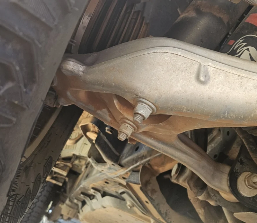

Thanks! It seems that my bolts extend a bit further than yours do:
Ford Bronco Bottle Jack Lifting Points? 1784908354606-qk
I'm coming up with some crazy ideas but I think I can make it work... just need to heavily verify before ever actually taking the wheel off

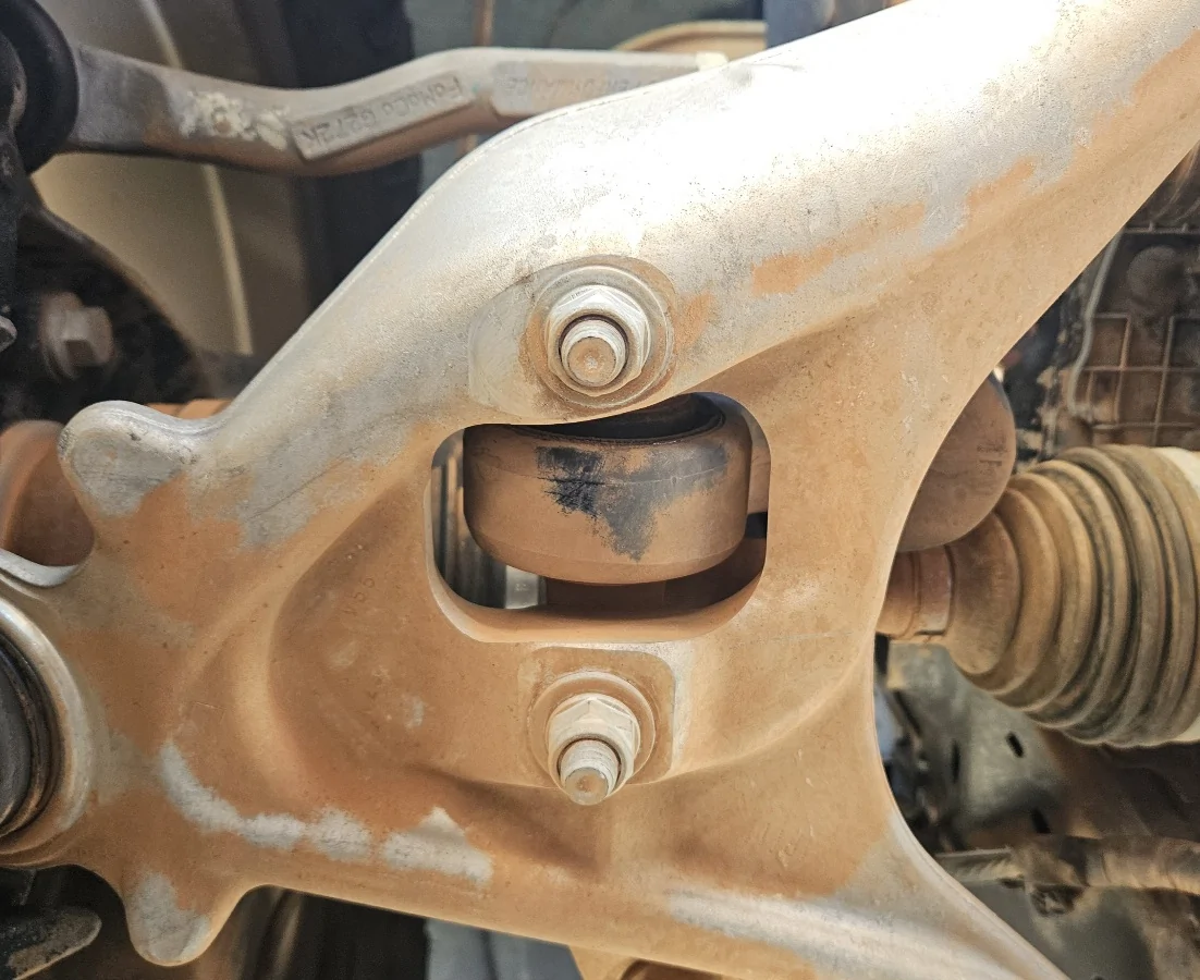

I installed my bolts facing the other direction so the threads weren’t hanging down in the rocks

Oh! Now that you mention it that's definitely an interesting design choice.
I may have to do the same. How intensive of a process is that?

Well it was when I was installing new coil overs… so was just part of the install. On stock I can’t recall if those were pressed-in studs or actual bolts that you could just flip.
If they are bolts it would be super simple - just do one at a time and Bob’s your uncle.
If they are pressed in I would just leave them alone and let the rocks take care of grinding them down for you - or you would need to press them out, which would require removing the shock (or at least dropping the LCA off).

Yeah, stock is pressed in.
There is a reason I didn’t flip mine with aftermarket coilovers though. Can’t remember what it was. Maybe I didn’t like how close the bolt was to the boot with the 32 spline CV’s? Hmm. Not sure
