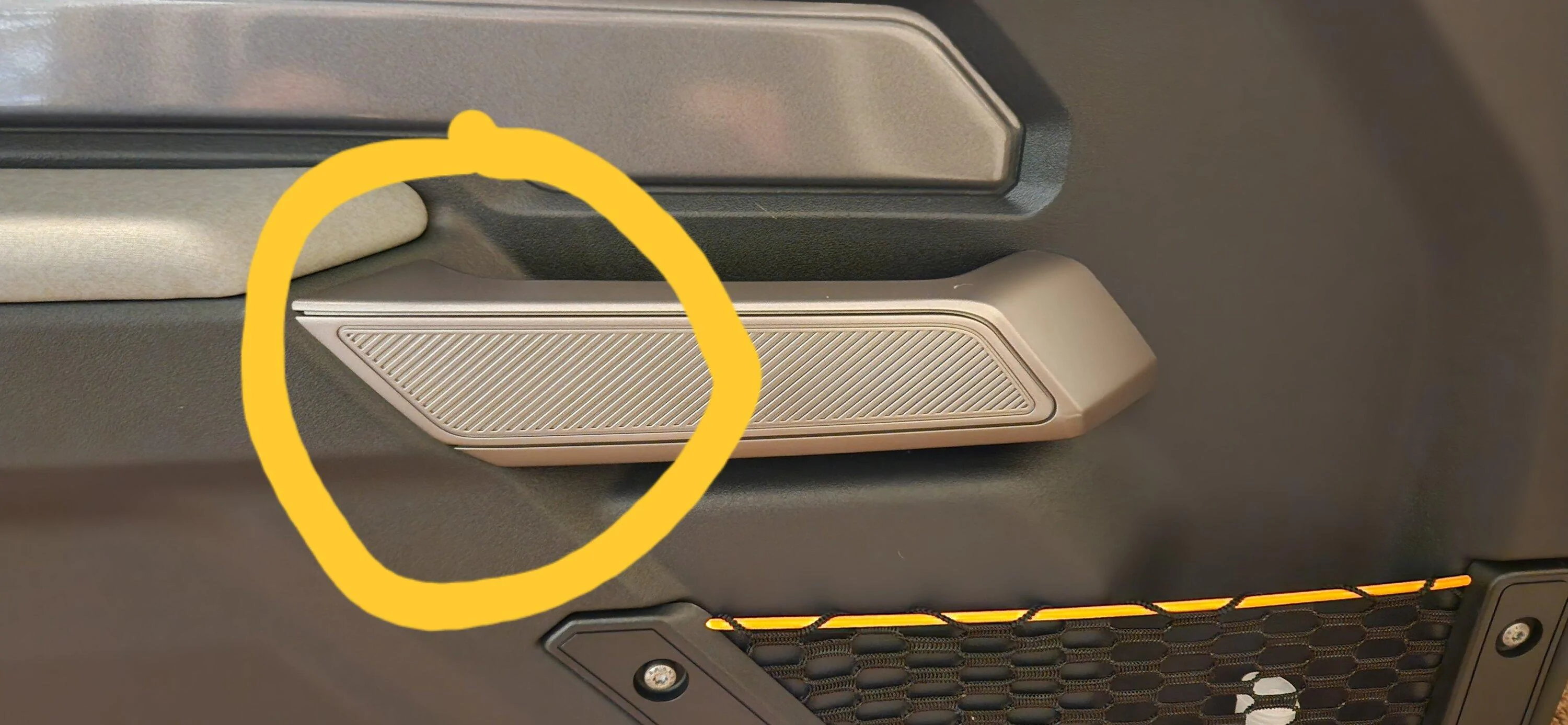

So I have noticed on my wife's bronco the anchor the hold the bolt that holds the panel to the door has broke. The panel pulls away when shutting the door. It's a metal clip with a foam pad on it.
I just need the anchor to replace the broken one.
Anyone have the part number or a better replacement?

There are like 4-5 different clips on the doors, but I think you're talking about these guys???
Ford Bronco Need a little help 1722777915121-cn
If so... W719435-S439
