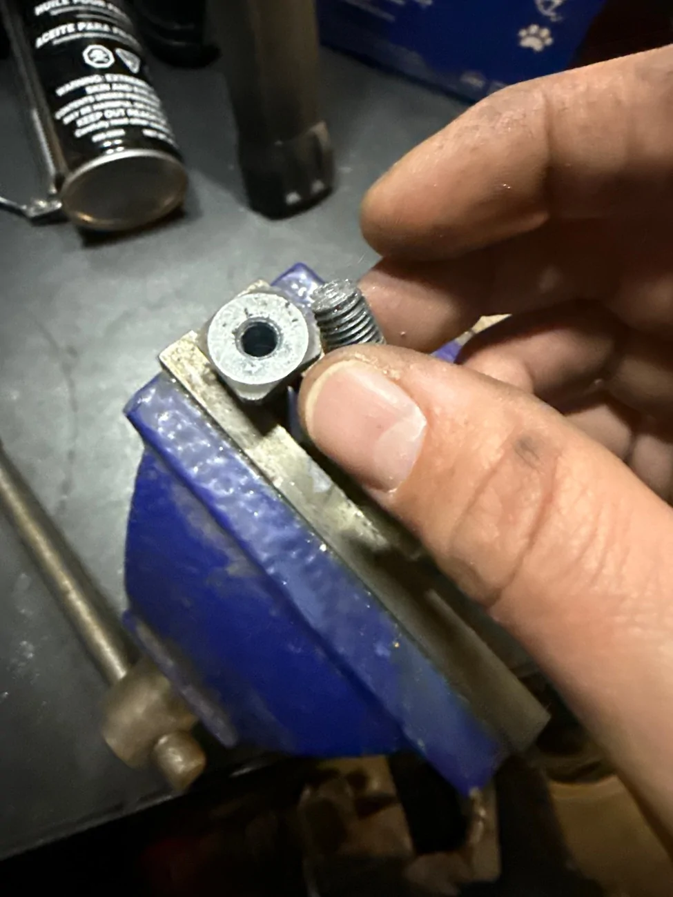

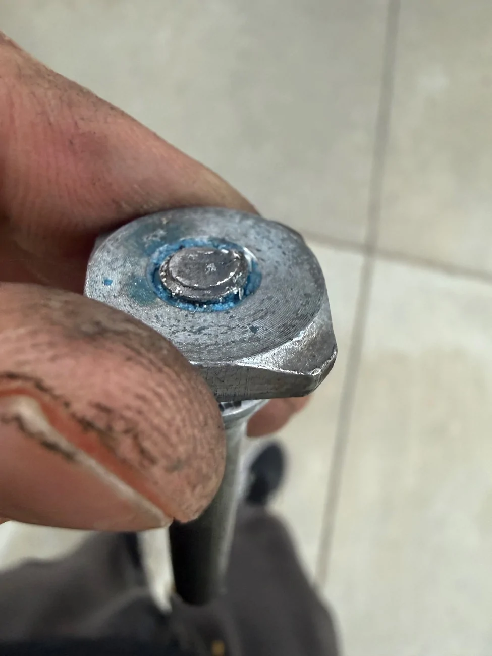

I snapped a guide pin bolt on my rear caliper and ford says they don’t sell them and I have to buy the whole assembly. Anyone know where I can just get a new guide pin and bolt? Is the front the same as the rear cuz they sell a front guide pin kit.
How about a picture of the damage?

I’ll check rockauto, but the fronts are different than the rears and the only kits like that I found like that were for the front. 15mm front, 13mm rear.
Ford Bronco HELP!!! Snapped a bolt IMG_8180
got it out though..
Ford Bronco HELP!!! Snapped a bolt IMG_8181

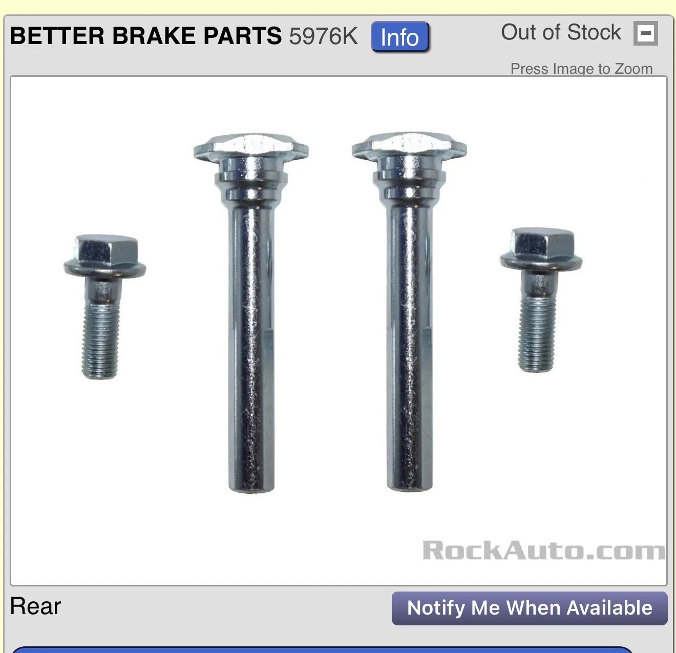

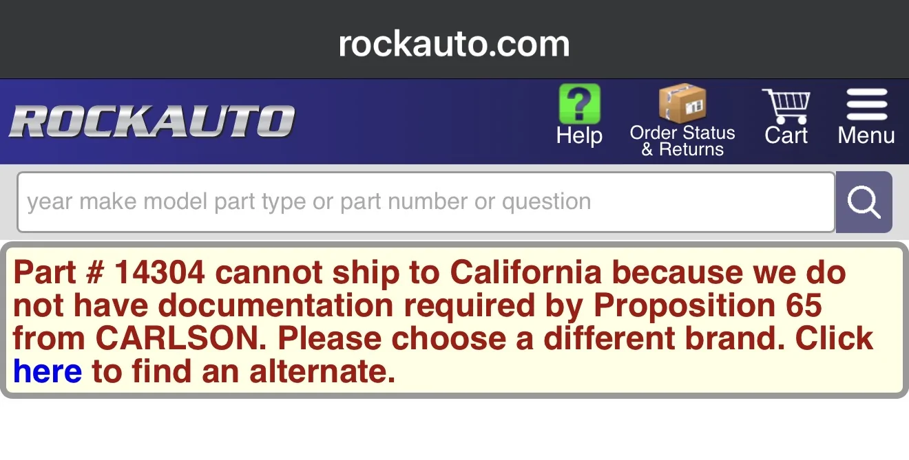

Well rockauto is a no go..
Ford Bronco HELP!!! Snapped a bolt IMG_8191
This one is the California compliant one.. out of stock and no eta..
Ford Bronco HELP!!! Snapped a bolt IMG_8193
