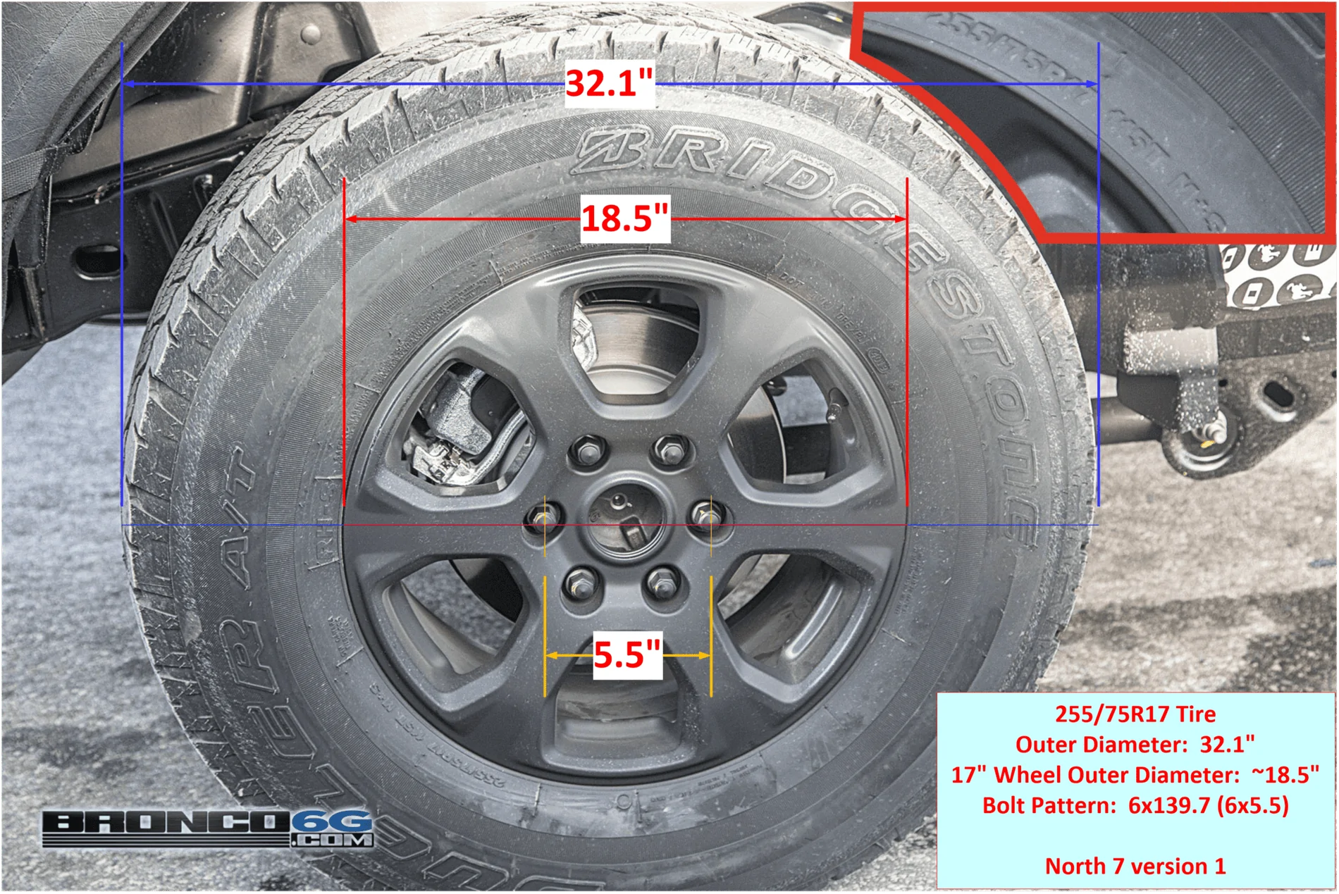

I contacted Fifteen52 regarding wheels for the Bronco. They were nice enough to inform me that the wheels on that Cactus Grey show truck are 6x139.7mm (5.5") 17x8.5 ET0. So that makes me assume that at a 0 offset (mounting surface directly in center of barrel) there is a 4.25" backspacing. Another assumption that i have made is that 4"-4.5" backspacing is going to be ideal for these trucks.
However, what i do not know, is the hub bore measurement. This will be needed for totally correct fitment or to buy hubcentric rings to adapt to the hub.
You have made one wrong assumption.
The actual width of a "17x8.5" wheel is 9.5". So if the wheel has 0mm of offset, the backspacing is going to be 4.75", not 4.25.

You are probably correct as the cyber Bronco, prototype/concept has a Raptor rear end so the bolt pattern would have been for the F-150/Raptor. The production wheels are the same bolt pattern as the Ranger.
If we believe the Method webpage link, the offset and backspace are:
105 Beadlock | Matte Black 17x8.5 | 5x5.5mm 6x5.5" (6x139.7mm) | 0mm/4.75
305 | NV | Bronze 16x8 | 6x5.5" (6x139.7mm) | 0/4.5"
(I corrected an obvious typo where Method listed 5x5.5mm)
