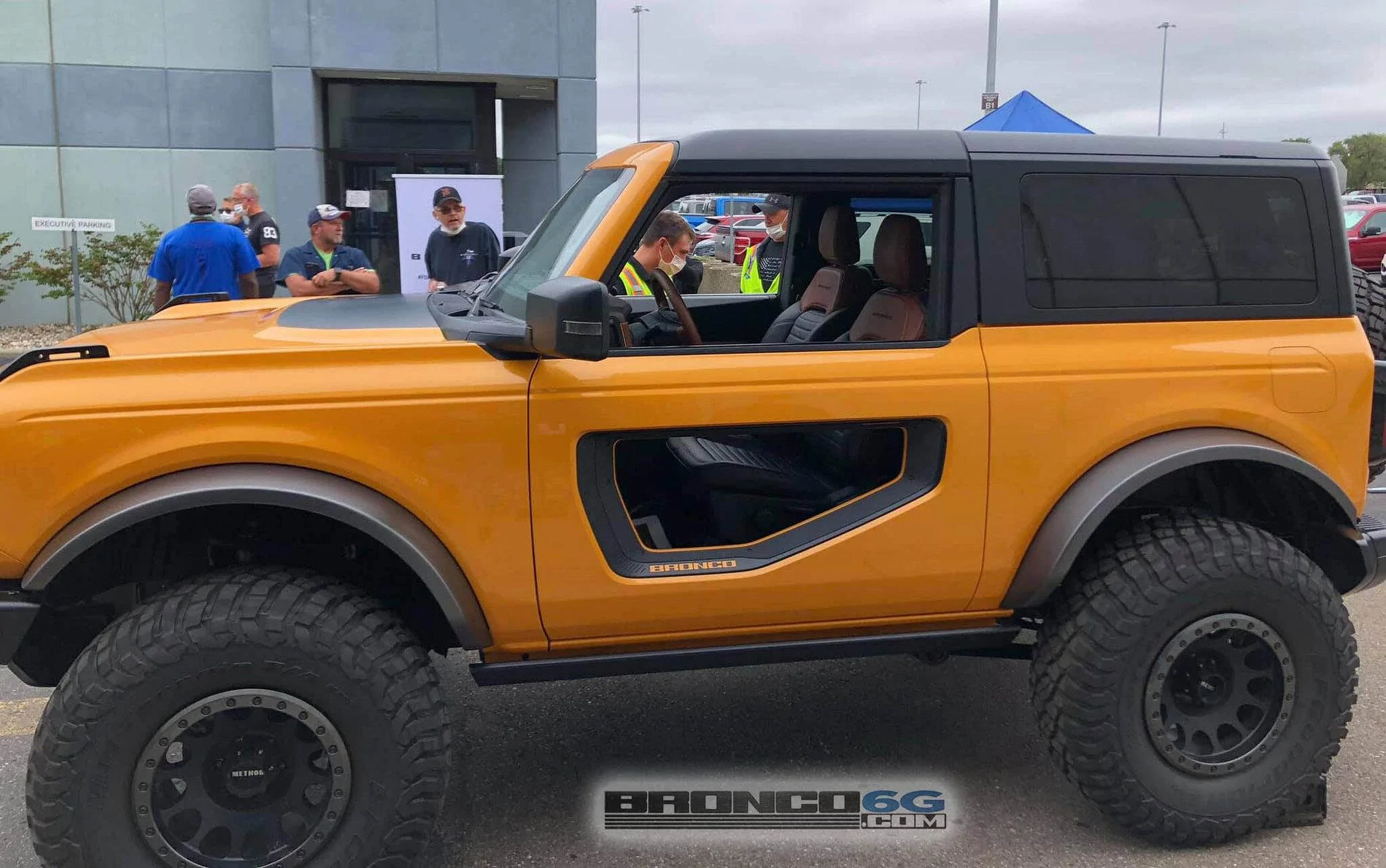

Is this the one you are talking about?
Ford Bronco 2021 Bronco wheels offsets and bolt pattern? 1603307922869
GetBucked
Daniel
136
470
2014 Focus ST
Yes. That is one of the parade vehicles with the Fifteen52 wheels. The Cyber Orange one has a different set of Fifteen52s I believe.
Ford Bronco 2021 Bronco wheels offsets and bolt pattern? -door-bronco-sasquatch-at-ford-plant-factory-2-jpg
The CO one has Method Race Wheels 105 Beadlock wheels on it.

If we believe the Method webpage link, the offset and backspace are:
105 Beadlock | Matte Black 17x8.5 | 5x5.5mm 6x5.5" (6x139.7mm) | 0mm/4.75
305 | NV | Bronze 16x8 | 6x5.5" (6x139.7mm) | 0/4.5"
(I corrected an obvious typo where Method listed 5x5.5mm)
