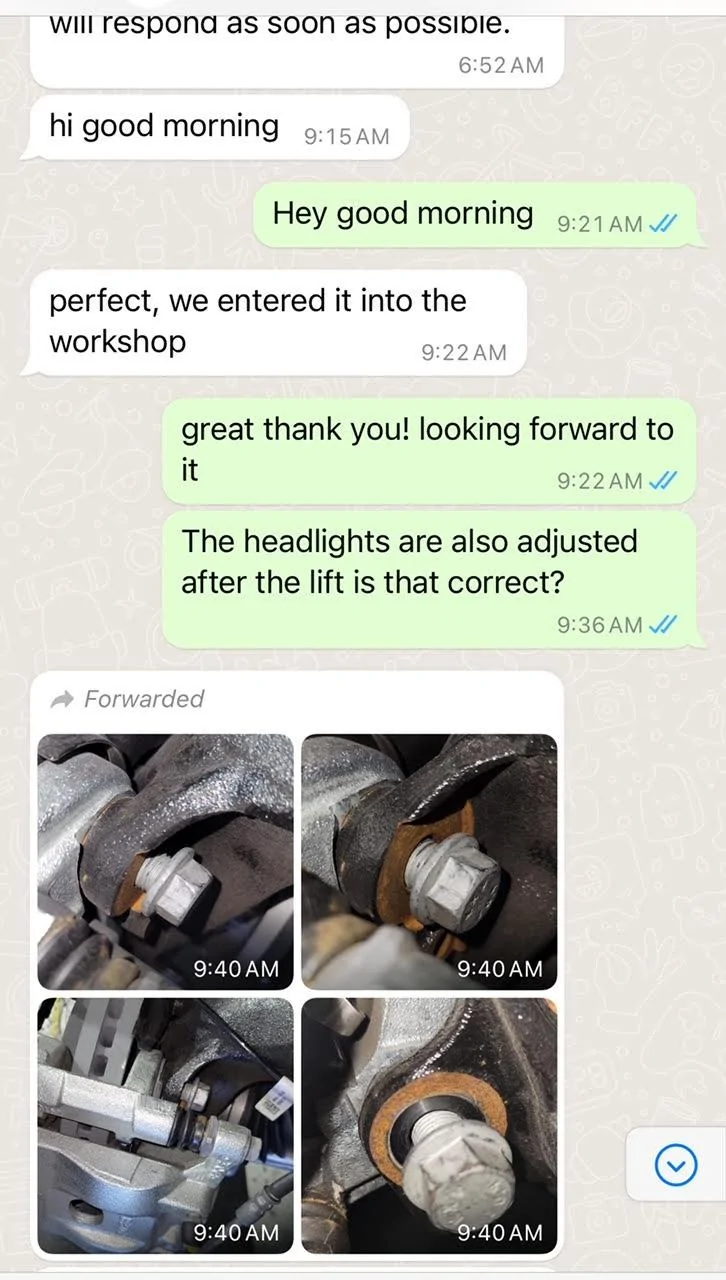

I received this in response:
"The problem is not the bolt, since when assembling the bolt they placed it on its side and inside the thread at the base of the caliper is damaged, that is why the screw does not fit anymore."
In that case, have them document what they found, and send it to the dealer to be fixed. the low miles on it should be enough to get them to take care of it. What caused the shop to be looking at your brakes?

Update: Ford service center told me that the shop that installed my perch collar lift is responsible for the caliper bolt being loose, this was the shop that sent me the pics. I'm not sure who to believe.
Edit: spoke with the shop, they confirmed they don't touch the brakes to do the collar install.
Also I am looking up the RPG instructions to confirm this, I am putting an email together back to the service manager at Midway Ford

You can clearly see the bolt was never tight. Either it was missed or it was started crossthreaded and they let it go. Even if crossthreaded, you can run a tap in from the opposite side and fix the bracket since it wasn't in very far. Catch at PDI? No way a tech can find and fix all of the factory's mistakes.
How is this such a big issue to get repaired? Living in the salt belt, I have replaced bolts like this in the past due to rust. Take the caliper bracket and run a tap into it. Tighten the bolt, done. If the threads are bad on the bolt, replace it. About $4 per pair and available at most parts stores. The guy that found the issue should of taken care of it right then and there. Seems like they are making a mountain out of a mole hill and passing the buck.

Ford Service is being a real pain. I just sent a response email to the service manager Jon Sacher of my messages with the shop (with timestamps) the day of installation.
Ford Bronco Help Please: Caliper Bolt loose / damaged caliper base? time stam
Edit: I explained the bottom right photo shows the bolt there was seated properly. The other was not from the rust.

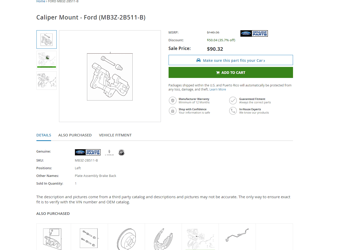

Hell if they don't cover it, buy a tap on Amazon for $10 and run it through the back side, locktite and done. The dealer can sell you a new bolt. Worst case buy a new bracket and put it on yourself, it's two mounting bolts and the 2 caliper bolts. $90 for the part.
Ford Bronco Help Please: Caliper Bolt loose / damaged caliper base? 1695933712296

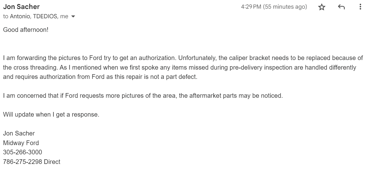

Well, I got this reply back from the service manager. I hope this is moving in the right direction.
Ford Bronco Help Please: Caliper Bolt loose / damaged caliper base? email response

I spoke with the salesperson at the dealer where I got the Bronco, he knows the full situation. He told me to let him know how things pan out and if there's an issue he will speak with his service manager about it. He mentioned the brakes are covered for 1 year.
