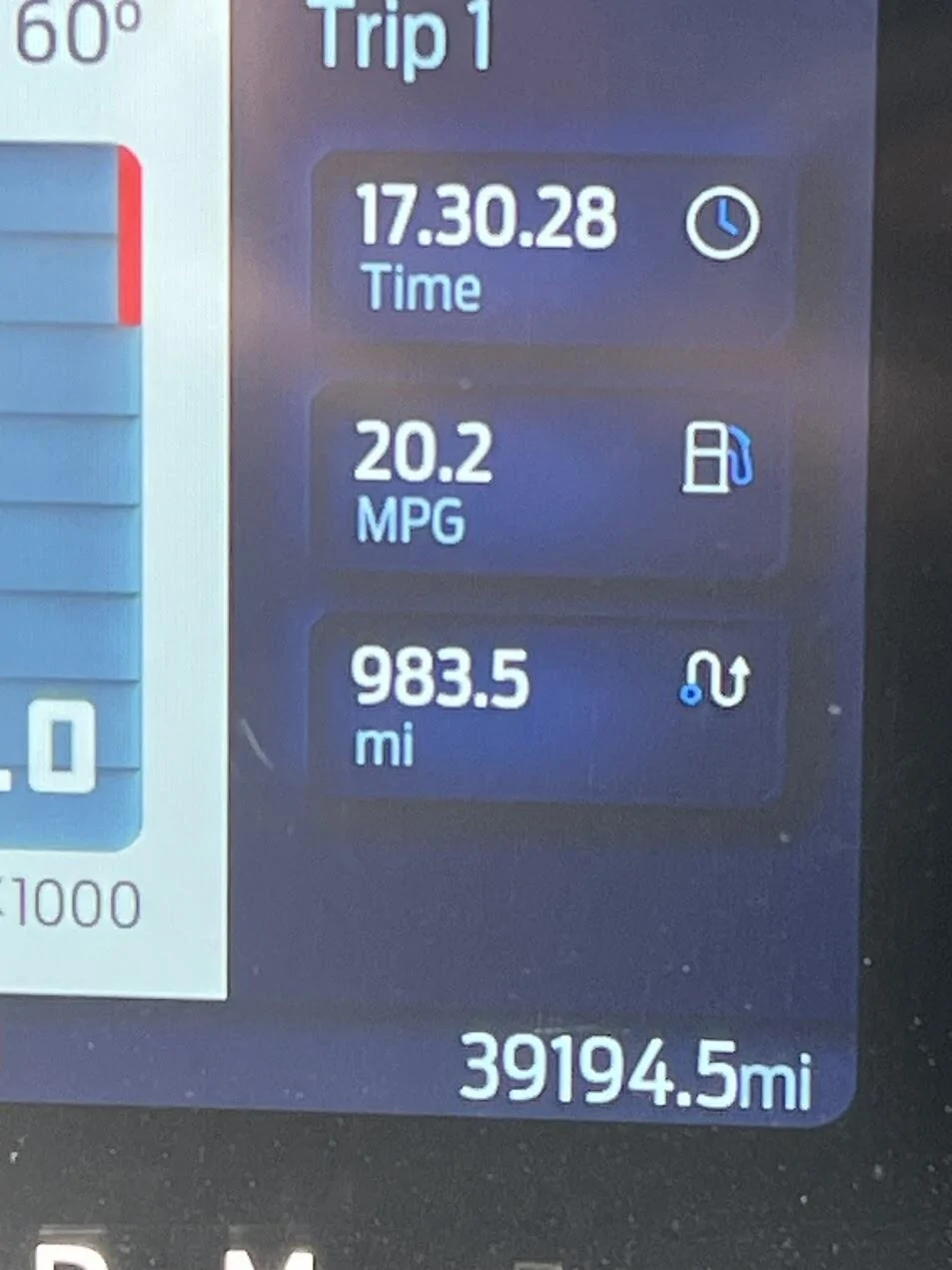

I saw the 70°F threshold in action a lot on a little 980 mile trip I just took. When outside air was mid-60s, oil temp was 220°F - 225°F. Trans temp 208°F or so. As soon as ambient air was over 70°F, oil temp was more like 198°F, louvers surely opened.
A/C on or off didn't matter. Maybe it does at slower speeds, like if it causes the the cooling fan run more which is helpful at slow speeds.
Going up hills with outside air in mid-60s, oil temp was 235°F even if I used more RPM and less boost. Seems unnecessarily high and I wonder at what point the louvers will ignore ambient air temps and open up.
On the bright side, I did get 20.2 MPG with 35" KO2's at 35-40psi (35psi cold, 41psi hot). Also on the bright side, I snagged Hoss 3.0 struts/springs for $800 and a brand new OEM soft-top for just $200. Made the trip worthwhile. The views leaving Jackson, WY were also pretty awesome.

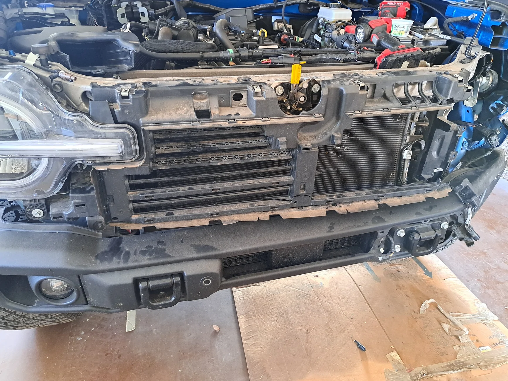

I know this is an old thread, but I hope someone will respond if they have deleted their upper shutter. Mine is mangled along with the grill and drivers side headlight due to an encounter with a deer at 65mph. I'm thinking about removing that upper shutter, but the bottom tab on the headlights on both sides is bolted to a piece of the upper plastic shutter. If you removed your upper shutter, what did you do about that lower mounting tab on each headlight? Thank you. (PS. Badlands with 2.3L)

Just remove all the actual shutters and leave the outer frame in place. Or is the whole thing that damaged?

Thank you, but yes, the whole drivers side is broken/trashed. I'm thinking that without replacing it, even tho I would just as soon forgo the shutter, I need it to mount the headlights?

Ah okay. Then yes. To make sure the headlight is mounted securely/correctly, you probably need to replace it.
I would check eBay or something for used ones. May be able to find something cheap, especially if you aren’t worried about the shutters actually working.
