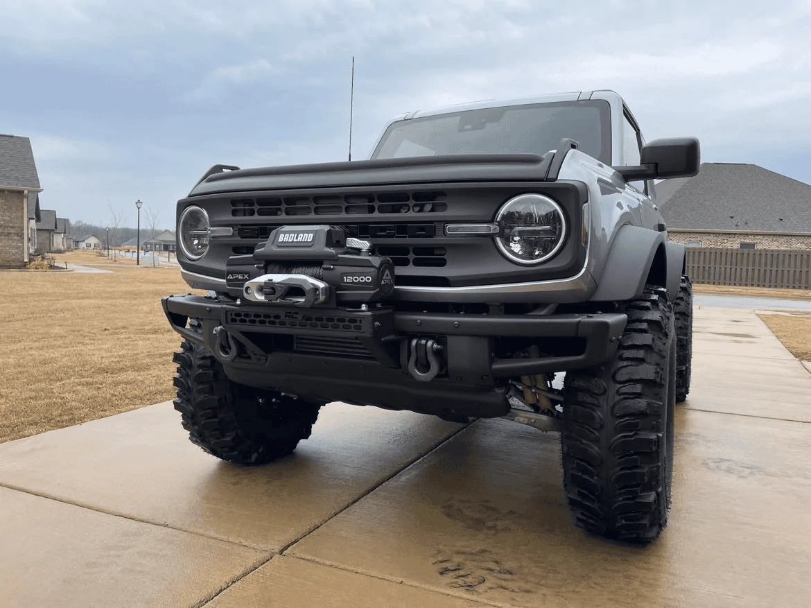

My issue has been while towing at highway speeds (60mph) with the ambient temperature just less than 70F. At this ambient temperature the shutters are closed. My IAT gets very high at that point and I’ve thrown a check engine light because of the high IAT temps. I don’t have the code handy but I’ll get that and update this comment when I have it. I also do not have a winch or anything blocking the front of the Bronco. If the air shutters opened at 60F ambient I don’t think I would have ever attempted to remove the louvers.

I had to delete it for my ADD pro bumper. I just took the whole assembly out unplugged the motor and zip tied the plug/wire out of the way. No issues

Correct, all you have to do it disconnect the motor from the shutter assembly and zip tie it wherever you want.
That being said, they will slightly improve the MPG and help the engine warm up faster like others have stated.
