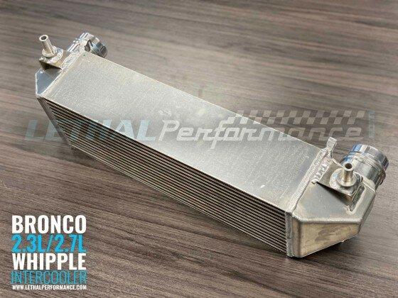

Simply put, never use eco mode and wanna maximize cooling when I get my intercooler as I'm doing the stock location, so whats needed, do I need to FORScan it or is it just rip some pieces out but also keep something to trick the unit?
Thanks in Advance
The Whipple megacooler comes with a bracket to relocate the sensor in front of the intercooler and also relocates the motor for the shutters. You remove the shutters completely.
https://www.lethalperformance.com/w...r-intercooler-2021-ford-bronco-2-7l-2-3l.html

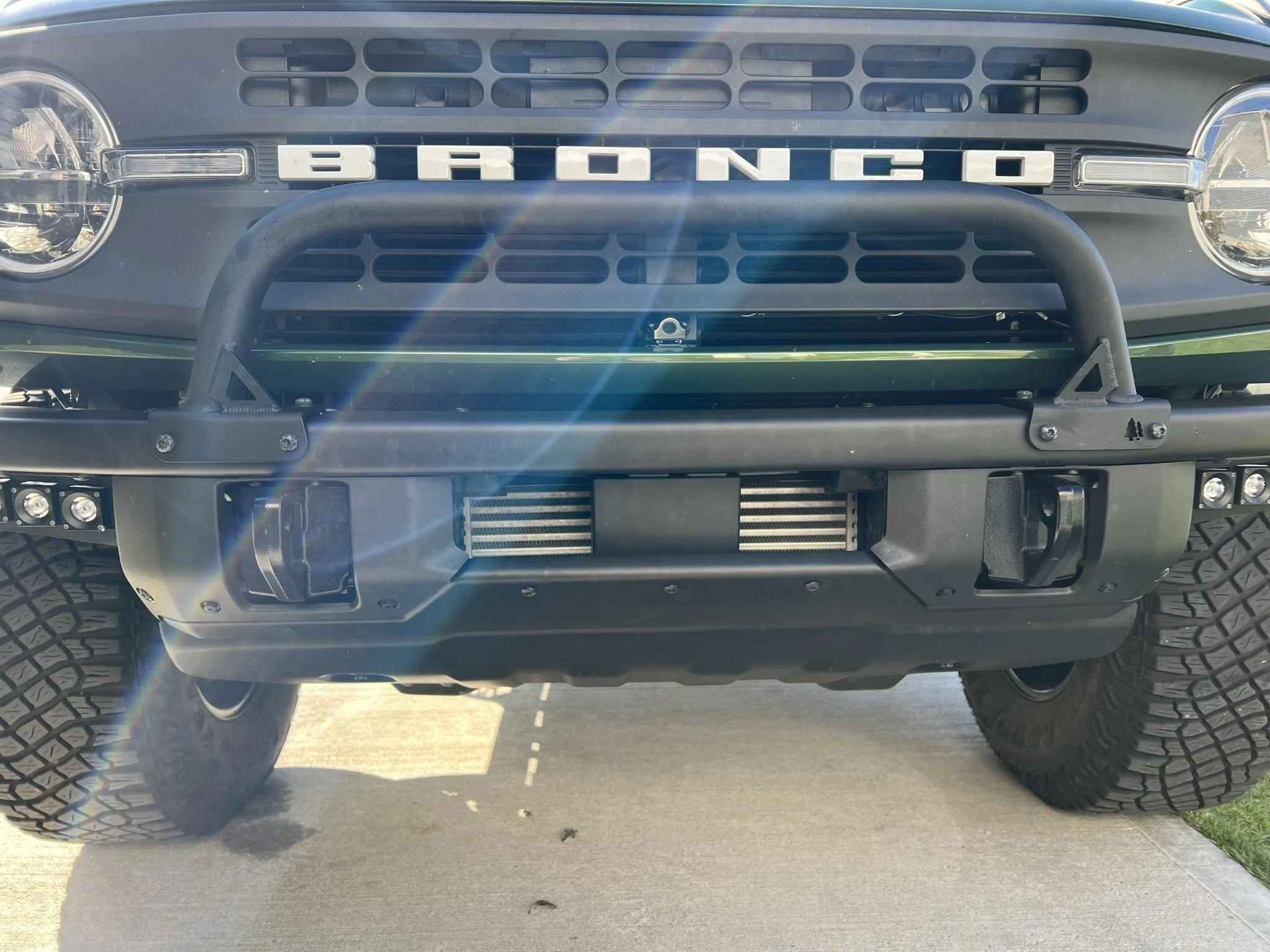

I removed the air shutters just last week for additional cooling. The removal was extremely easy as you can simply leave the servo in place and remove the louvers themselves.
I tow a small travel trailer and have found at ambient temperatures less than 70F the air shutters were completely closed at highway speeds. The intercooler did a good enough job at cooling but the sustained warmer air was enough to drive up the engine oil temp to rise to 230F+. At ambient temperatures over 70F my engine oil temperatures would fall to 195F and I found fuel economy to be improved.
Since removing the air shutters my engine oil temperature has remained around 200F while towing at all temperatures and my fuel economy while towing as increased to ~14MPG. Another added benefit is I’ve increased about 1MPG when not towing to around 20.6MPG average.
Hope this helps you. Feel free to PM me if you have any questions.

How do you pop off the louvers? I disconnected the motor when I replaced the intercooler but I couldn't easily see how to remove either the shroud or the louvers so they just stay in the open position.
strunkkl1993
Kyle
Dec 3, 2021
Cincinnati, Ohio
22 Bronco Black Diamond
After removing the front bumper you can remove the (4) 8mm bolts holding the air dam and assembly which contains the air shutter assembly (you don’t have to disconnect the electrical cable to the servo motor). From the back side of the assembly you can press the tabs on the outside of the louvers and then pull them outward away from the servo motor. The 4 louvers are vertically connected to one another so you will have to pop off the clip at the top of the assembly to remove the top louvers. Once complete you can re-install the air dam assembly and the front bumper.
There are some good installation videos for the Whipple kit on YouTube that helped me through the process.

I’ve been curious if it’s simply due to the overall increased temperatures in the engine bay because of the lack of air flow. I have a data logger and I’ve seen that the temperature at the air box increases ~30F when the louvers are closed versus open. I’m guessing if the engine bay is 30F warmer that would cause my motor to run warmer as well? I’m guessing the oil cooler can only do so much?
Another interesting thing is that my engine oil temperature under normal driving conditions has been between 187F and 192F over the last 25k miles. Since removing the louvers my engine oil temperature has been consistently around 180F. Again I can’t explain it but it’s what I’ve been experiencing the last week or so.
