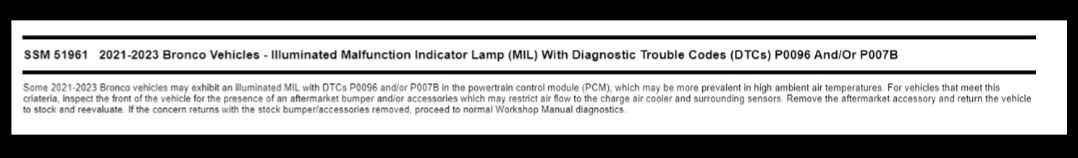

Has anyone noticed the rear shroud assembly? In addition to the active grille shutters in front, there is a rear shroud ducted towards the radiator, and below that opening there are gravity operated louvers... I can't figure out if the purpose of that shroud is to duct hot air upwards to be sucked out with the radiator fans or if the purpose is to allow heated air being drawn in through the radiator to be directed toward the intercooler during cold days...and I don't want to screw anything up especially in light of this:
Ford Bronco Grille Shutter Delete? Want to maximize cooling Screenshot_20231026_100113_Chrom
With that information in mind it is feasible that the Bronco may run too hot or too cold...and those shutters are designed to modulate or regulate temperatures. My guess is that for those of you that removed your shutters everything's working as it should and everything is all good, but for folks who live in extreme temperatures or who may be partially blocking things etc etc this could be the tip of the iceberg for potential warranty issues and customers having to pay to have something troubleshot that becomes an issue as a result of modifying the intercooler or the shutters (or simply adding a bumper or winch that blocks the critical area that's not supposed to be blocked). I love the comfort of my Bronco, but I miss the simplicity of the first generation Bronco drivetrain.
