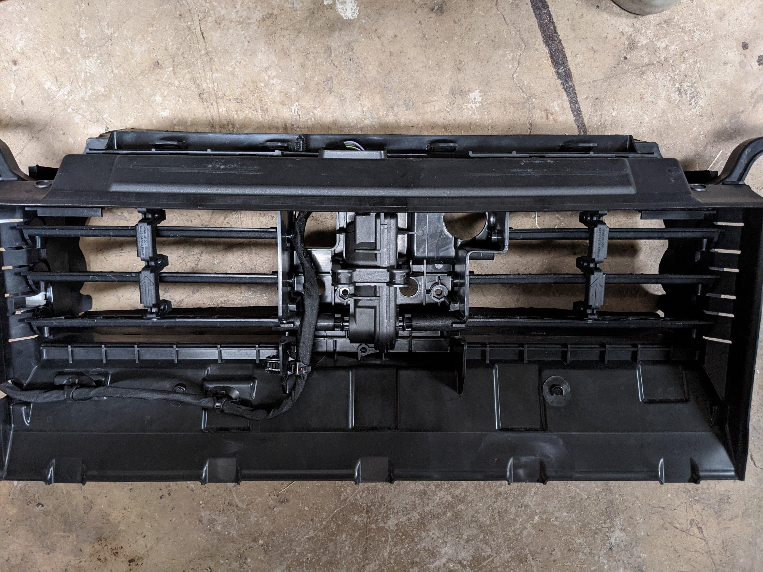

The shudders are just part of a big piece of molded plastic held in by 4 bolts and is easily removable (if you don't have the lux package and integrated radar sensor). Just remove it and if your Bronco throws a code I would just strip out the motor, plug it back in and zip tie it somewheres out of the way.
