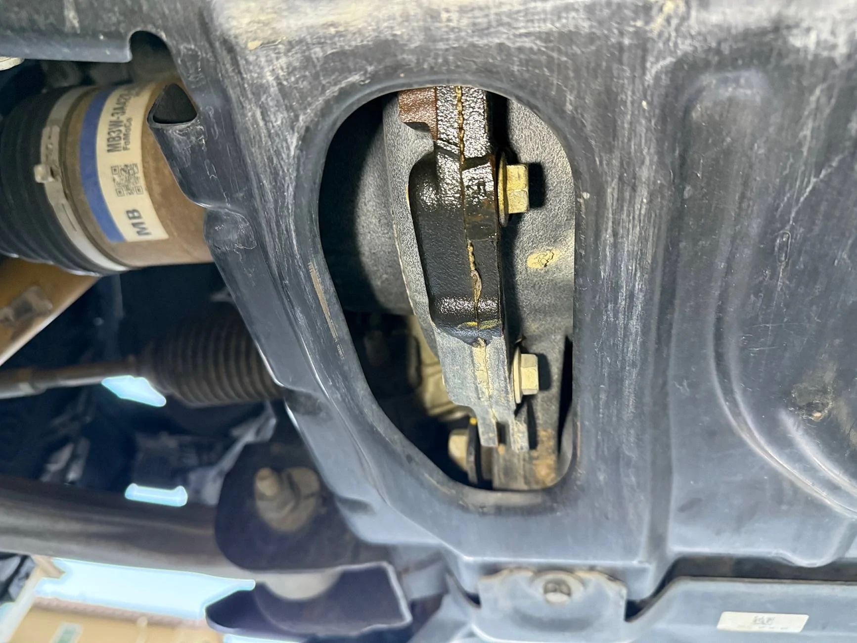

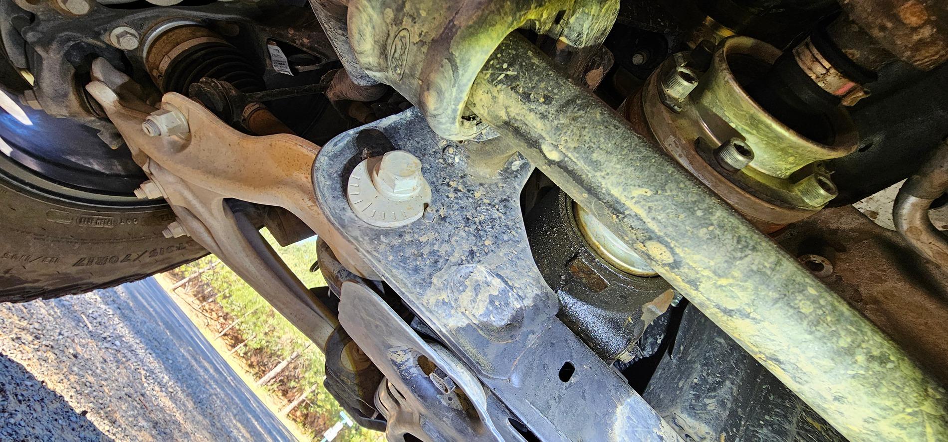

Just had my front diff pinion seal replaced at just over 23K on my 2022 Everglades. I also believe it was the source of the burning smell that I would always smell while in 4wd. Caused by all the fluid burning off under the car. The leak on mine seemed to be more than just a slow leak. I first noticed it while at United by Bronco out in Sand Hollow in Utah this year, took the attached picture after wheeling all morning in 4H and 4L. It didn't take longer for the dealer to get the parts in. Now the story with the aftermath of them installing the pinon seal correctly.... that's a story for another thread.... Hopefully this seal lasts.

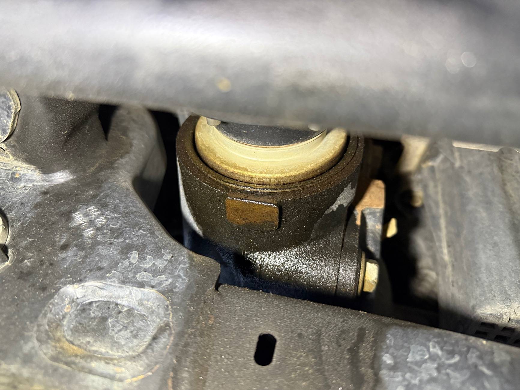

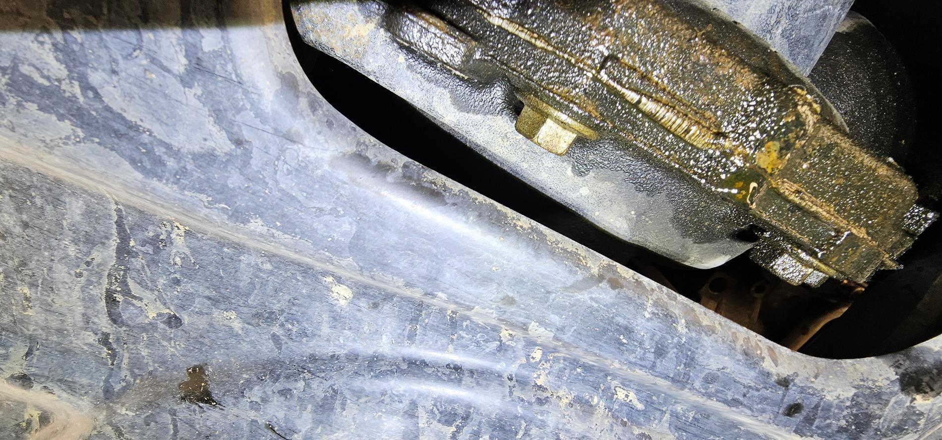

Had mine replace at 12k. 23 wildtrak. The dealer didn't specify as to the cause. but did state they had to use a specific synthetic fluid per Ford to replace it. Here are my pics
Ford Bronco Front differential pinion seal leaking pinion seal 1
Ford Bronco Front differential pinion seal leaking pinion seal 4
Ford Bronco Front differential pinion seal leaking pinion seal 3
Ford Bronco Front differential pinion seal leaking pinion seal 2

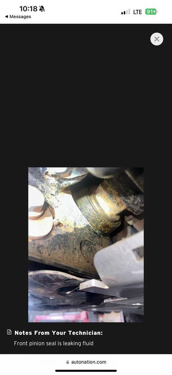

Just had my Pinion Seal replace this past week - all under warranty - they said this is "common" and I was the "dozenth or so" to have this issue at the dealership where I ended up doing - they were super cool about it and replace it with no issue - parts took about 4 days - work itself was less than a day.

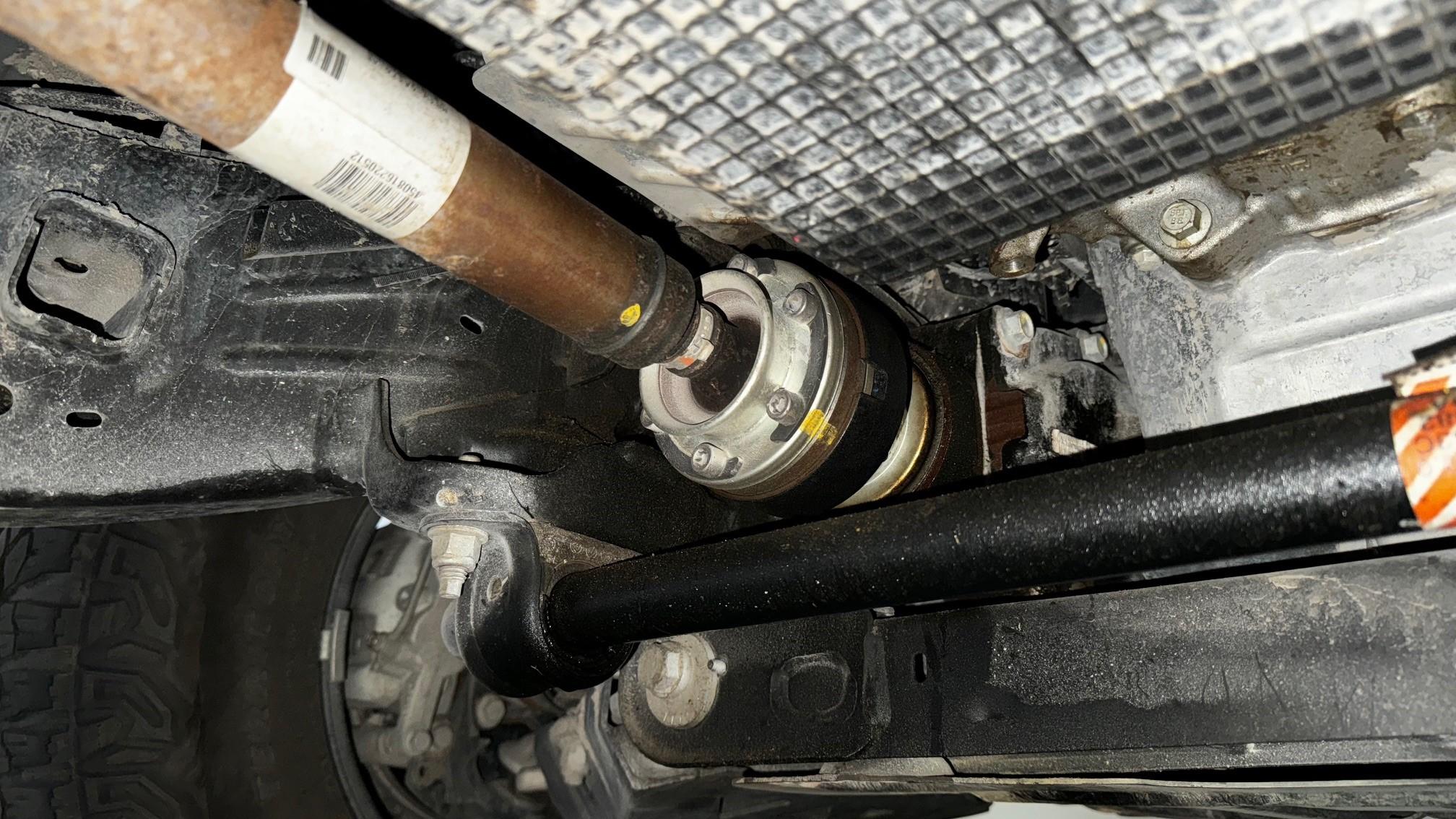

My Bronc is at the dealer right now with the pinion leak confirmed by the evaluating tech. I'm still waiting on the expected solution. I've also got a pretty loud "knock" in my front end, thinking CV failure, maybe front diff. Still waiting for the diagnosis on that. Fingers crossed, I get a whole front end replacement.
video of the front end sound for reference. Can hear it stationary when wheel is tuned back and forth. Also while driving

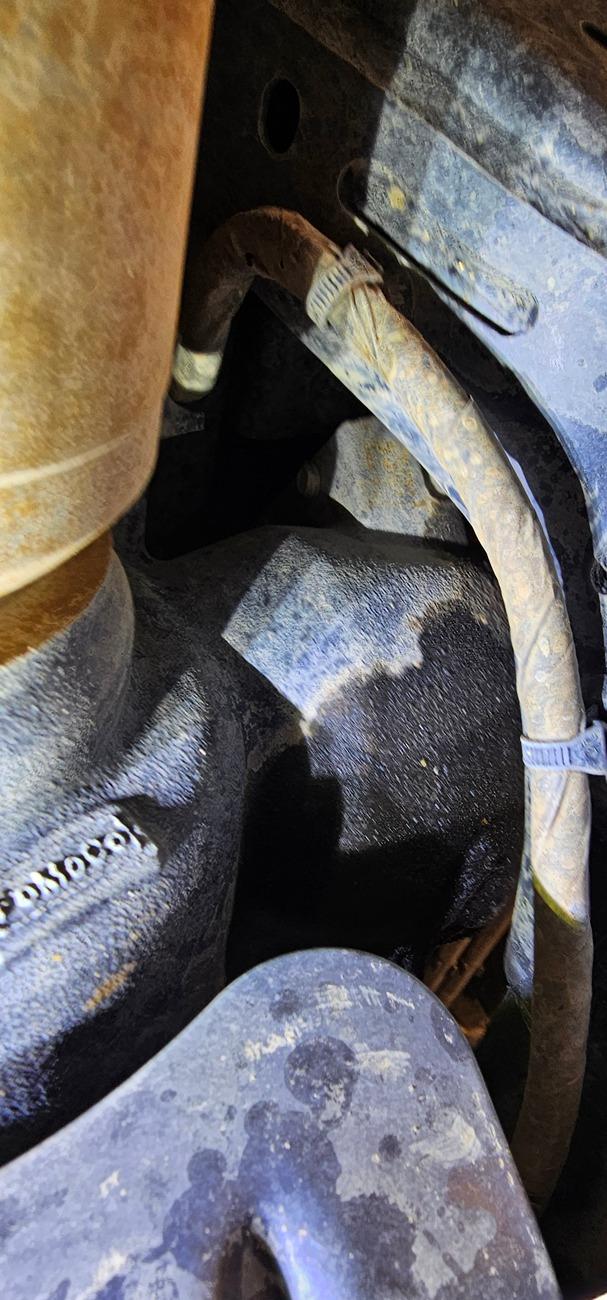

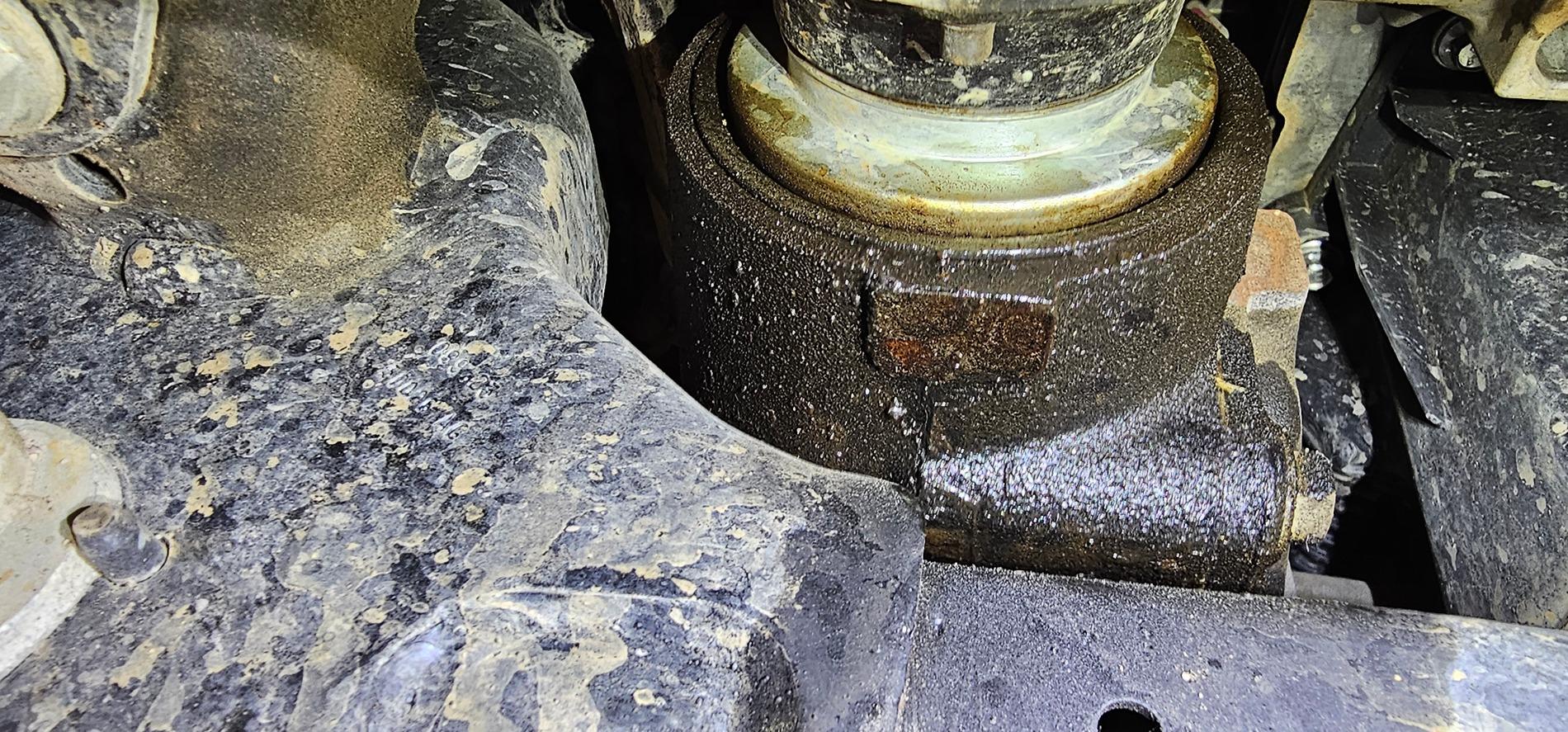

Hey Everyone, this seems to be a common issue with the 4.7 gear I just checked and I have the same issue now I have to go see the dealership Monday. I know we have a Ford Rep on hear I really hope they reach out.
Ford Bronco Front differential pinion seal leaking IMG_0433

Welcome to the club. Mine is leaking (4.56) at 30k miles and goes to the dealership Monday. Hope to just get a new pinion seal snapped in and be good to go. I will probably throw it on the lift myself and check pinion wobble to make sure thats not causing any issues after they fix it.
