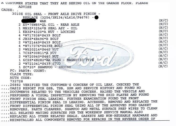

I finally got my bronco back. The paperwork says
REPLACED FRONT DIFFERENTIAL PINION SEAL AND TOPPED OFF FLUID IN DIFFERENTIAL
and the line item shows
XY*80W90*QL OIL - REAR AXLE
Looking at the TSB:
To prevent subsequent seal leaks, the front differential fluid must also be replaced using the revised specification Motorcraft® SAE 75W-85 Premium Synthetic Hypoid Gear Lubricant, part number XY 75W85-QL. Refer to WSM section 205-03A > General Procedures > Differential Draining and Filling.
So my question is, should I expect a repeat failed seal in the future?

I finally got my bronco back. The paperwork says and the line item shows Looking at the TSB:
The TSB is only applicable to MY 21-22 and some early 23 Bronco builds so I'm assuming Ford fixed this on the later 23-25 models. I'm a Ford service advisor that deals with a lot of Broncos and have not seen any come back for a second repair after performing this TSB.
Mine's a 22. I bought an ESP so I guess it's not a big deal if it happens again, but a little discouraged that they didn't seem to follow the TSB, at least with how they wrote it up.

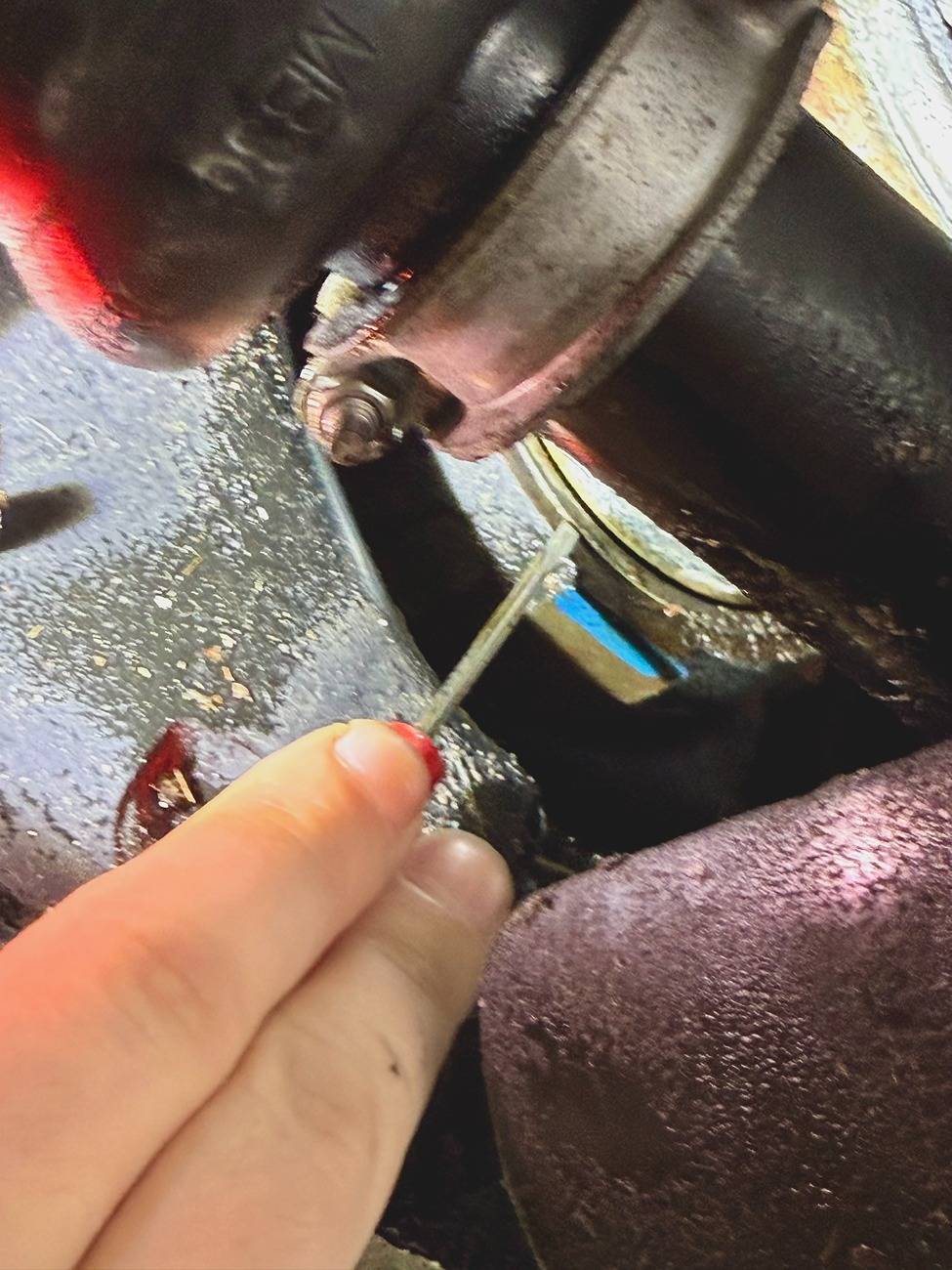

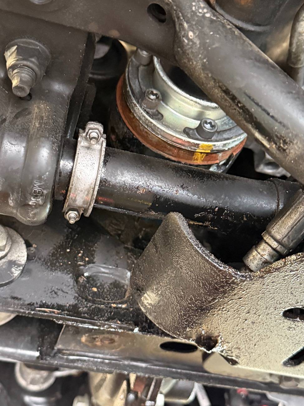

Hi All (and Ford Motor Company if you're monitoring this thread), I too am adding myself to this group of owners' who have discovered a Front Differential Seal leak. It was discovered today, 16 May 2025, at my dealership during a service to perform an oil change and to complete manufacturer recall #23S48 (Intermittent rear camera blue/back image on sync screen).
My vehicle is a 2022 Bronco Badlands (non-SAS) with stock wheels/tires/shocks/control arms and axles. I factory ordered this vehicle during COVID and has been just great to own and drive. It's currently at 41K miles on the odometer, almost all of it highway and county road mileage.
During the oil change and vehicle inspection the maintenance technician discovered that the front differential seal had been leaking and showed me the seepage under the assembly and on the skid plate. I previously noted drips in my driveway after previous services but incorrectly assumed it was just engine oil drips following that oil change.
I took these photos for visual reference:
Ford Bronco Front differential pinion seal leaking IMG_0760
Ford Bronco Front differential pinion seal leaking IMG_0759.jpe
The maintenance tech pointed to the source of the leak, stated it was the front differential seal that was leaking, and that parts were not currently available so would have to be ordered.
My Ford dealership here in Maryland has been great; from the ordering process to them servicing the vehicle. No complaints whatsoever. I hopeful that once the parts needed come in and installed that this will take care of the problem. 🤞 I'll post a follow-up once that occurs.

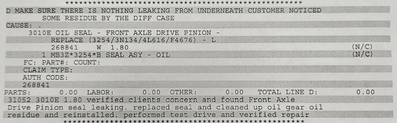

Hi, first post here.
22 badlands 30k got my replaced and got my pinion seal replaced due to some oil on the front diff case. Noticed it like others after oil change. Saw residue on case.
The service tech didn’t refill the fluid. They said they just topped it off. Does that sound right? Does this type of repair cause a lot of fluid to leak out like dropping an oil pan?
this is the ticket from the repair. Don’t see anything about refilling the fluid. Should I be concerned for low diff fluid level?

Ducati1098
9,835
22,789
Midwest
seems the TSB says to replace Fluid.
I would certainly check it.
Once the seal is removed fluid will come out. Enough to the point that will need to be topped off.
The front differential doesn’t hold a lot, so typically topping it all is all that’s required, but the fact no fluid was charged out on that repair order at all is suspicious
Doesn’t look like they followed the TSB, just replaced the seal
