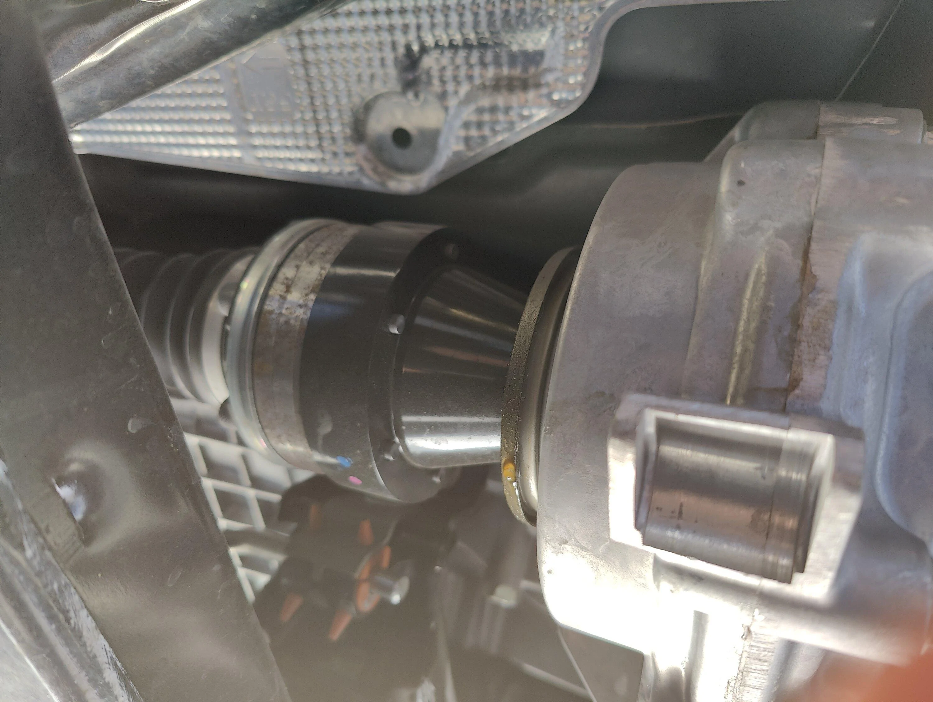

Took my Bronco in to have the 4/7 pin tow kit installed (which failed to program) last week. While there, I asked they review my transfer case output shaft seal that I noticed is seeping. They did see that it looked "wet", but stated Ford won't do anything unless there's an active leak. So I guess I have to wait for my transfer case to fail. Strange thing though, is this looks and feels like 90w gear lubricant, like from a differential. My understanding is the transfer case would have ATF.
Oh, and my hard top is cracking now too. My list of issues is getting too long. But, I still like the car.
Ford Bronco Front differential pinion seal leaking IMG20231006163831
