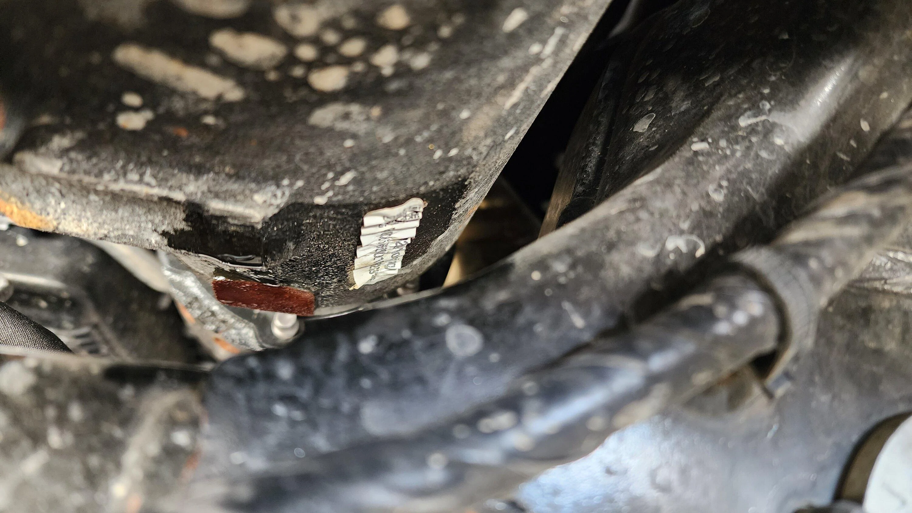

I just changed my oil and see that I now have a front pinion seal leak, on top of a service charging system message that comes and goes. Had to charge battery back up a couple of weeks ago.
Called dealership and they said that they cannot schedule a service time for me and there are 40 cars in front of me before they can look at it :mad::mad::mad:

Hello, Jason! Send us a private message with your VIN and the name and location of your local Ford dealer. I’d be happy to see what I can do to assist with this leak concern. Thanks!
