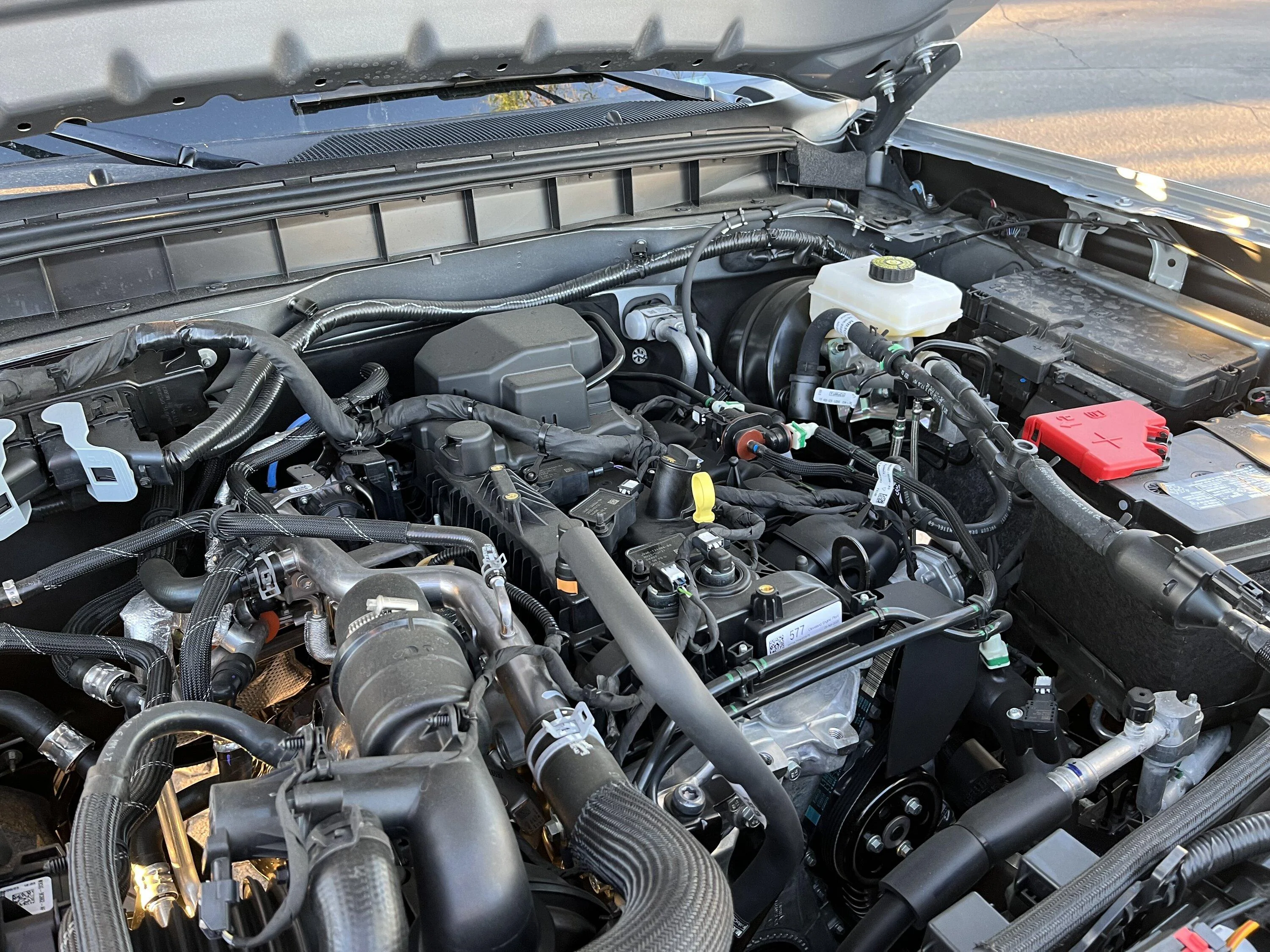

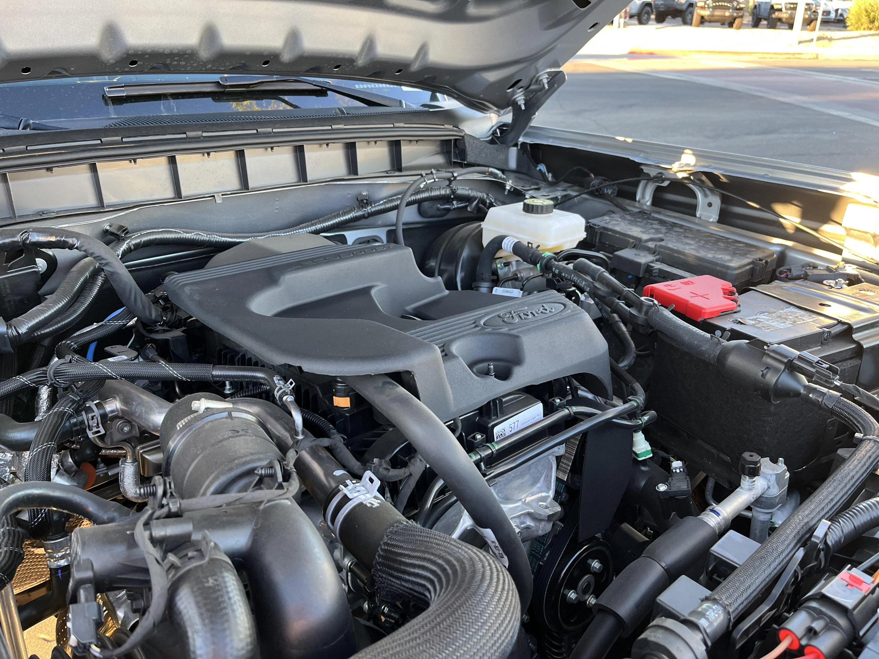

I like the OEM look of the Ford Product.
The photo shows a very clean and professional installation, whether that's the suggested installation, or Helomech73 did a very good job of installing it.
Then there's fact of it being a Ford Product, that later, God forbid, I ever have any issue(s), the Dealer can't instantly blame it on an aftermarket product.

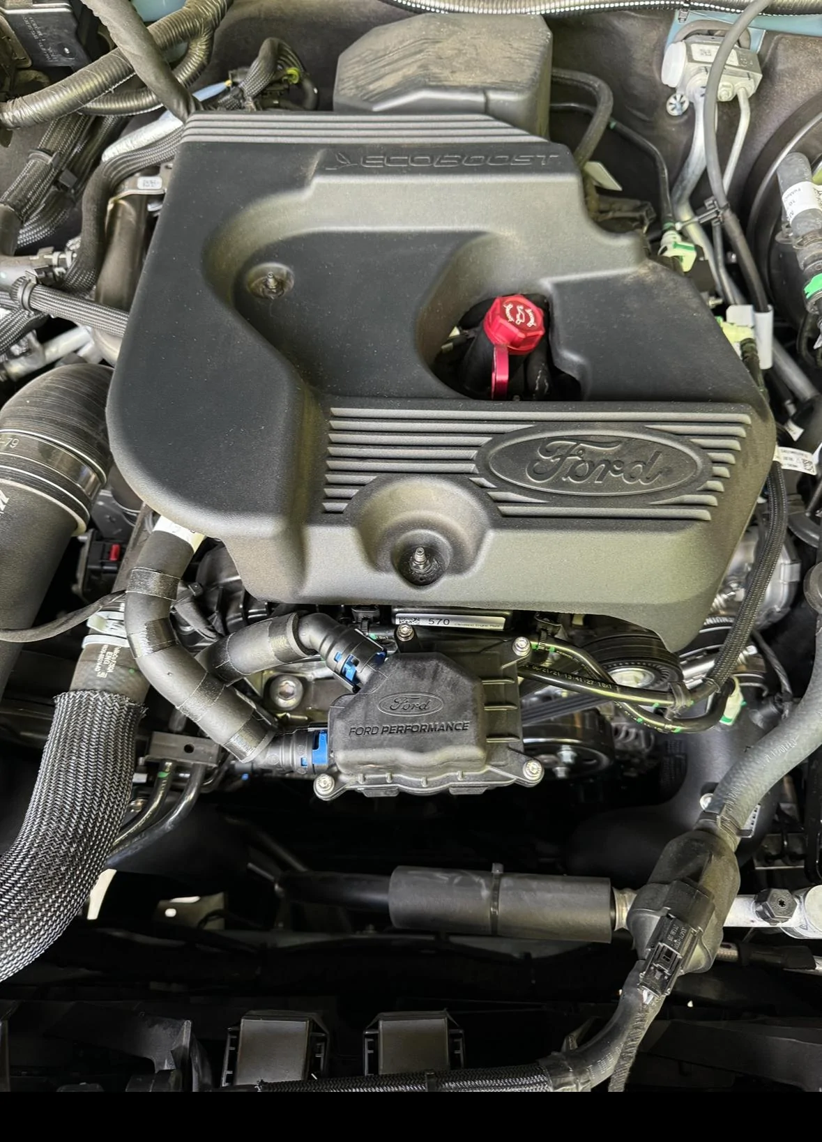

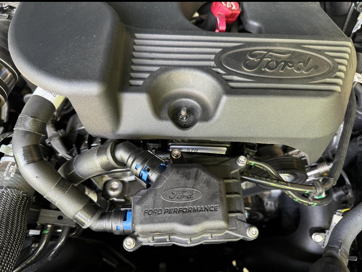

I wonder if the Ford 2.3L Engine Cover from the Ranger, which I have installed on my BD, would interfere w/the fit here.
It fits with the cover!

Ford Bronco Ford Performance Air/Oil Separator IMG_0456
Ford Bronco Ford Performance Air/Oil Separator IMG_0458
it fits!
Ford Bronco Ford Performance Air/Oil Separator IMG_0050
Ford Bronco Ford Performance Air/Oil Separator IMG_0051
