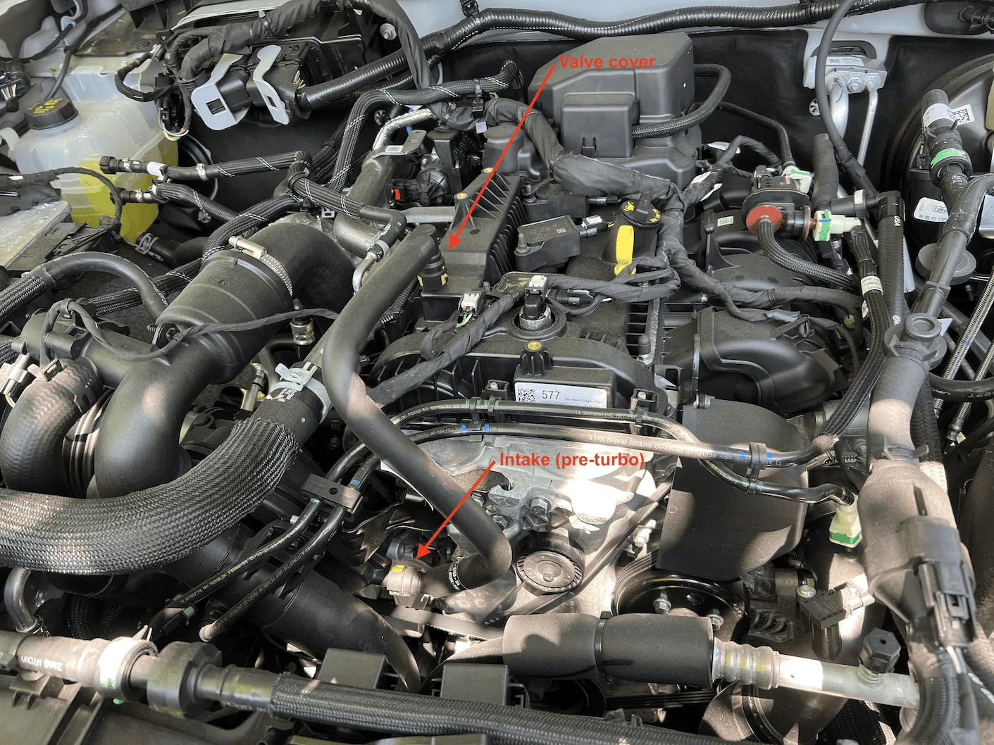

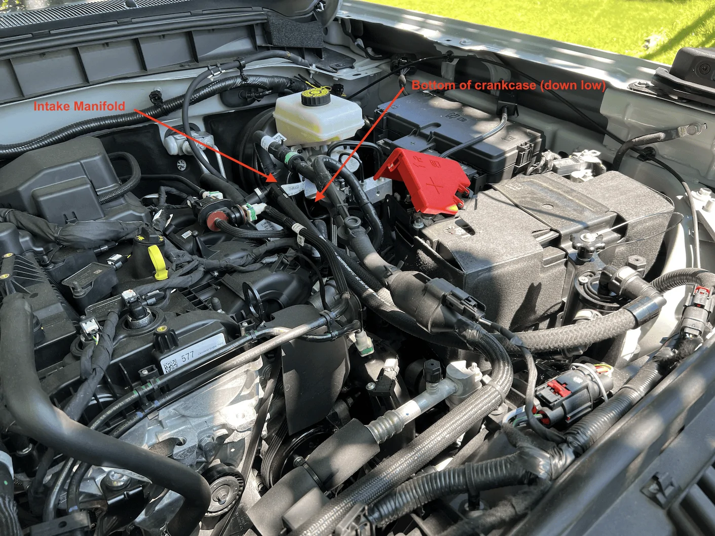

Okay so I dug into this a because I was confused as heck... BUT I understand now.
There is actually TWO crankcase vents on the 2.3L:
  • Bottom of the crankcase, through a factory oil/air separator, directly into the engine intake manifold.
  • Top of the valve cover into the air intake BEFORE the turbo/intercooler/etc.
Most of the aftermarket catch cans are attached to that first hose. This Ford Performance is attached to the second hose.
Pictures below for reference. Note I have a UPR catch can on the first PCV host line.

No that's not correct, the valve cover port is not a "vent" it's where the fresh air is drawn into the crankcase, otherwise you would be pulling a vacuum. They are all part of the same airflow "circuit so to speak" putting a catch can between the air cleaner and valve cover would be doubly pointless
Okay that makes sense... but if true... makes me wonder why Ford bothered selling a product like this.
It could be perhaps that top line is a two-way line and air can go in both directions depending on the pressure inside the crankcase. Not sure if there is a valve or anything on that line, but it seems to be a single-use hose so risky proposition to mess around with it.
I'm guessing they think it backfeeds pressure when the thing is under boost for long durations. IDK really what the point of this is, but I'm not sure I get the point of my mishimoto can either...I guess I got caught up in the hype?

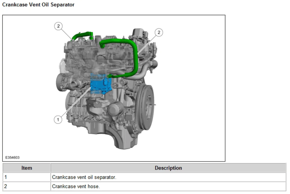

#1 - Bottom of the crankcase, through a factory oil/air separator, directly into the engine intake manifold.
#2 - Top of the valve cover into the air intake BEFORE the turbo/intercooler/etc.
Yes! This is a great diagram. Sometimes the OEM diagram text does not always match accurately, so it's tough to decipher. I added a #1 and #2 to your breakdown above.
#1 - commonly referred to as the PCV system. There is a PCV valve in the blue plate under the intake manifold. During normal driving it allows air to flow through to the intake manifold.
#2 - commonly referred to as the CCV system (crankcase ventilation). When you go WOT, the PCV valve closes completely, allowing air to pass through the crankcase vent (CCV) side.
We have done many, many miles of testing on multiple 2.3L EcoBoost engines and, historically, we have found little-to-no accumulation in the CCV side. The Bronco is not designed as a 'WOT-all-the-time' type of vehicle, as opposed to someone bashing a Focus ST or Mustang at the track, so we did not bring to market a kit for the CCV side (2.3L). [we DID find blowby collection on the 2.7L EcoBoost engine in our Bronco Badlands, however, so we do have a dual kit for that engine]

In this case, what purpose does a catch can on the PCV side serve since the engine comes from the factory with an air / oil separator on that circuit? Or does an aftermarket can catch the oil rather than depositing it back into the pan like OEM which although not ideal is much different than plumbed into the intake where it will eventually accumulate on the valves?
Thanks
Hey @BigHoof - that large blue 'air oil separator box' component on the side of the engine helps to separate a small amount of the blow-by, but not nearly as much as a dedicated in-line oil catch can. Correct, a catch can like ours will catch blow-by instead of sending it back to the engine through the intake. It's important to remember that blow-by consists of more than oil. It can include condensation and unburnt fuel, neither of which you want on the valves or back in your oil pan.
