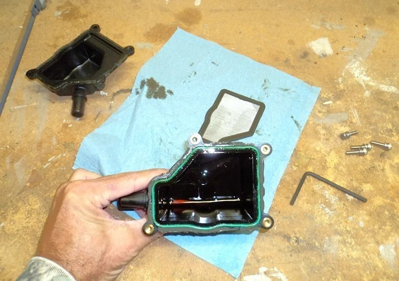

Do you know if it's possible to get a new oring? Thinking of getting the FP kit, as your photo shows promise that it's capturing something that I'd rather not have spread into my intake tract.
Shouldn't need one as it is a reusable gasket. While I don't pull a lot out, both sides always have something in them. I'm glad I have it one there 🤠

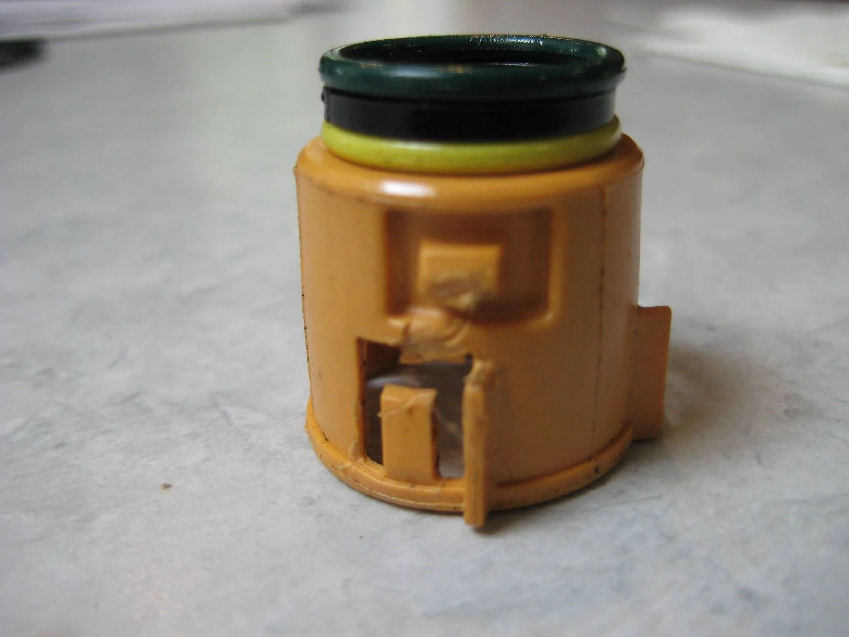

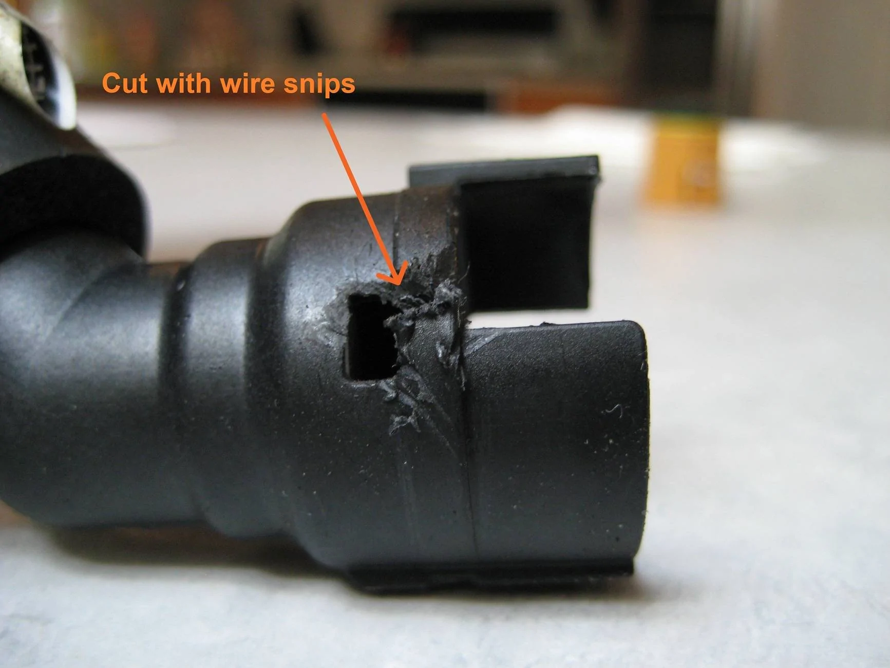

After seeing this photo I finally broke down and bought my own Ford Performance Air/Oil separator for my 2.3L. I was pretty apprehensive about tearing apart the orange connectors from the old hose as I found it difficult to find information on how this connector is assembled. I wound up cutting the two spots shown and walla! The hose came off leaving the orange part behind which was easy to remove without harming the port.
Note: Have a little over 5K miles on my Bronco right now. Old hose had oil residue inside the length of the hose.
What the orange piece looks like in tact.
Good job. Very clean removal. Since Ford used a consumable hose (orange connector style), I very carefully and slowly broke the orange connectors with a pick tool. It is meant to be broken however you choose to do it. After installing the AOS system, then what I did was buy a new OEM replacement hose for less than $20. If I ever have AOS system problems, I can then return to stock configuration in a pinch. I like redundant backups. I carry 2 inner and 2 outer tie rods just in case while on the trail.

I have a FP oil catch can on my 2.3L Black Diamond. It has over 1000000 miles. There is a noticeable amount of oil (no moisture or sludge) in the catch can at oil change interval (5000 miles or less if I am leaving on a long trip). I just remove the top screws, lift the lid, and wipe it out with a rag. It seems to be doing what it is designed to do.

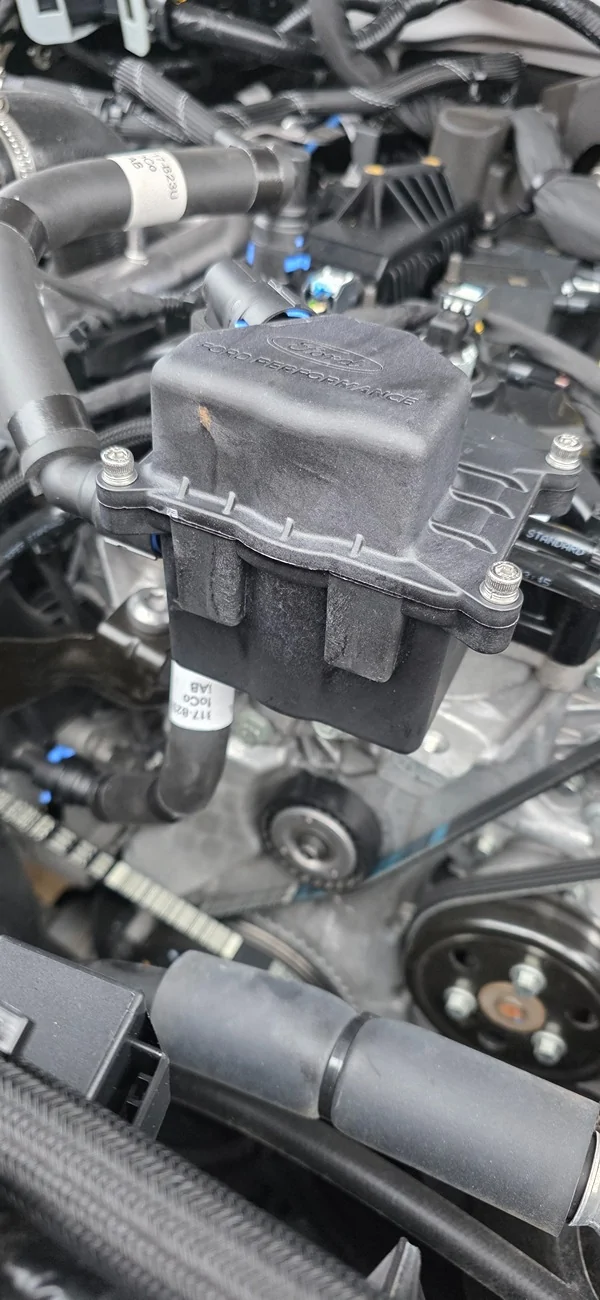

I went with the ford air oil separator. This was a super simple install! The install took probably 30 minutes at most. It took me longer to find the tools to do the job than to actually do it. The temperature drops sunday and we will be back to normal winter temps in southern Illinois. Ill try checking the next few months and update.

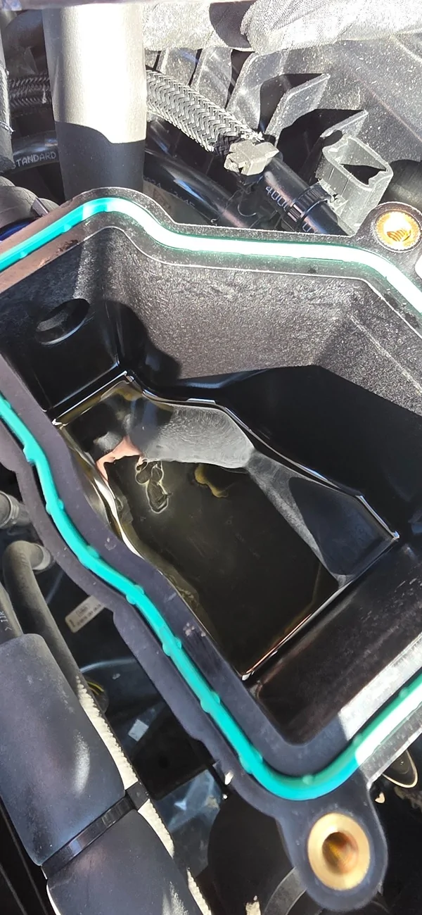

Another 3k open up and have a look. About 1/32" deep black oily emissions at bottom. Also some orange white-ish residue too.
edit. The side of the screen facing down also had residue all around the black edging. Definitely caught more this time. I had already wiped it off.
