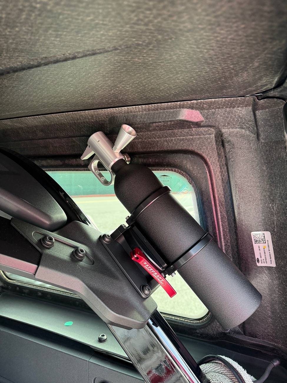

Fabbed my own mount for the Safecraft pb3 extinguisher and quick release mount. I'm personally not a fan of hose clamp held extinguisher mounts. Nothing against those who use.
