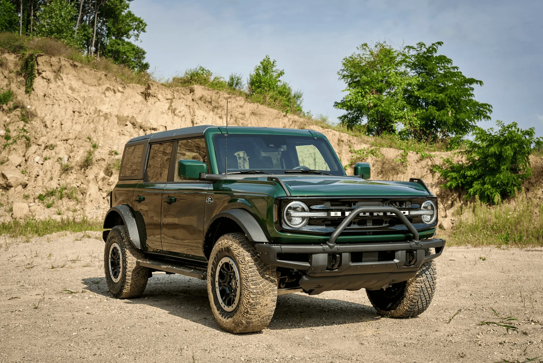

Started with a base big bend on 32" stock big bend wheels. Added hoss 3.0 that was taken off another bronco that was getting a bigger suspension. Added the sasquatch wheel flares had them line-x coated. Great decision there. That has held up very well. Take off 17" sasquatch wheels from a different bronco build put KO's on it then. Capable bumper off of another build. I did add the IAG Boards onto the Ford rock slides that I honestly don't remember where I got those. There was some horse trading involved I am sure. This thing has been a lot of fun. I smile everyday when I drive it. It has two open diffs and has gone everywhere I have asked it to go.
Ford Bronco Fake Squatch Help IMG_2963

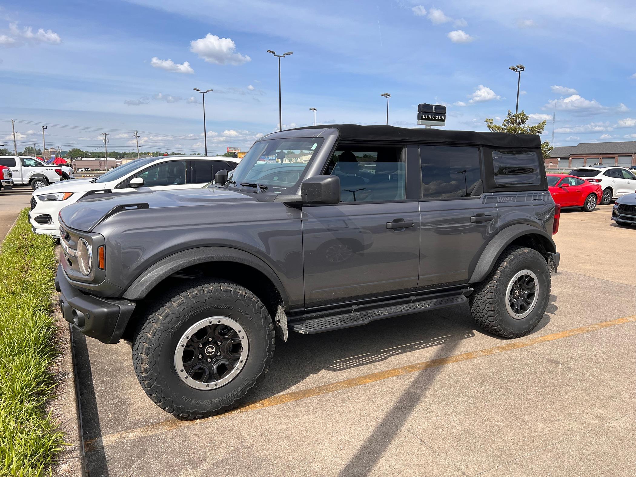

(Photo for attention only)

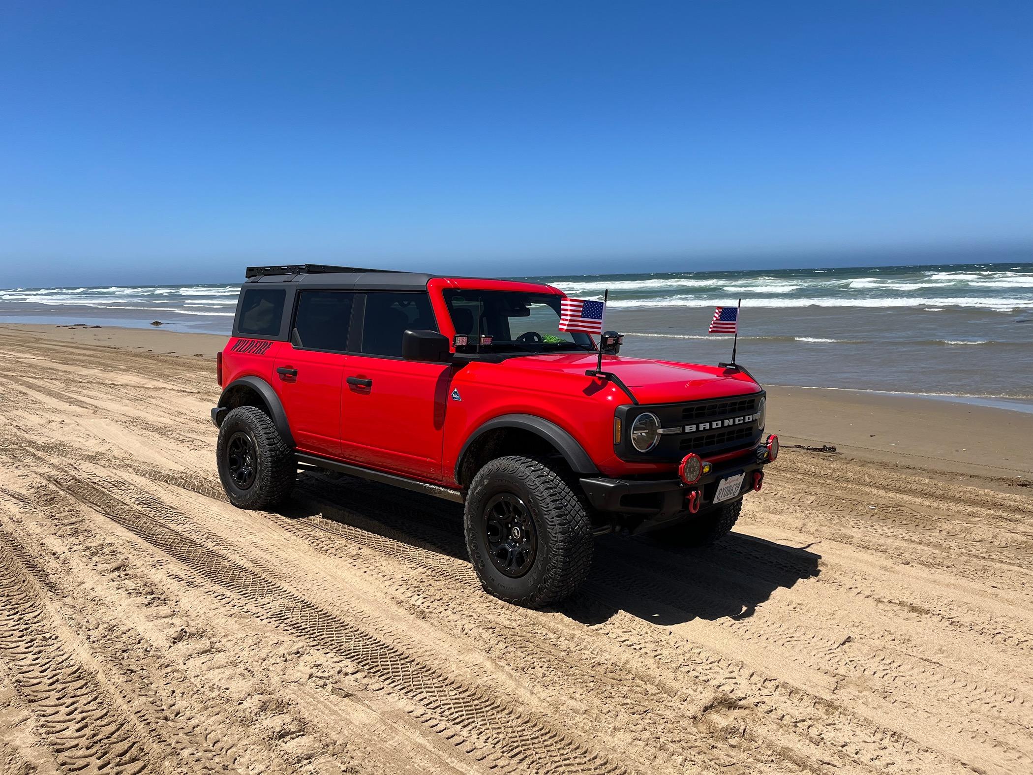

Have you looked into doing Bilsteins? I did the 5100’s on mine. Much better ride, lift I wanted, and bought Sasquatch take offs plus mine is a Black Diamond so essentially all I am missing to be the same as a Sasquatch is the front locker.
Ford Bronco Fake Squatch Help IMG_5759
