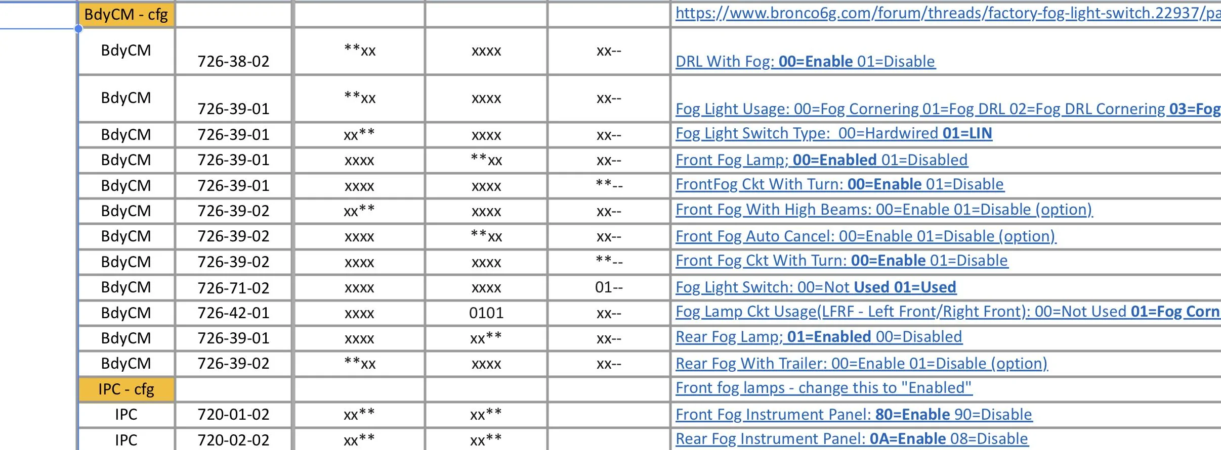

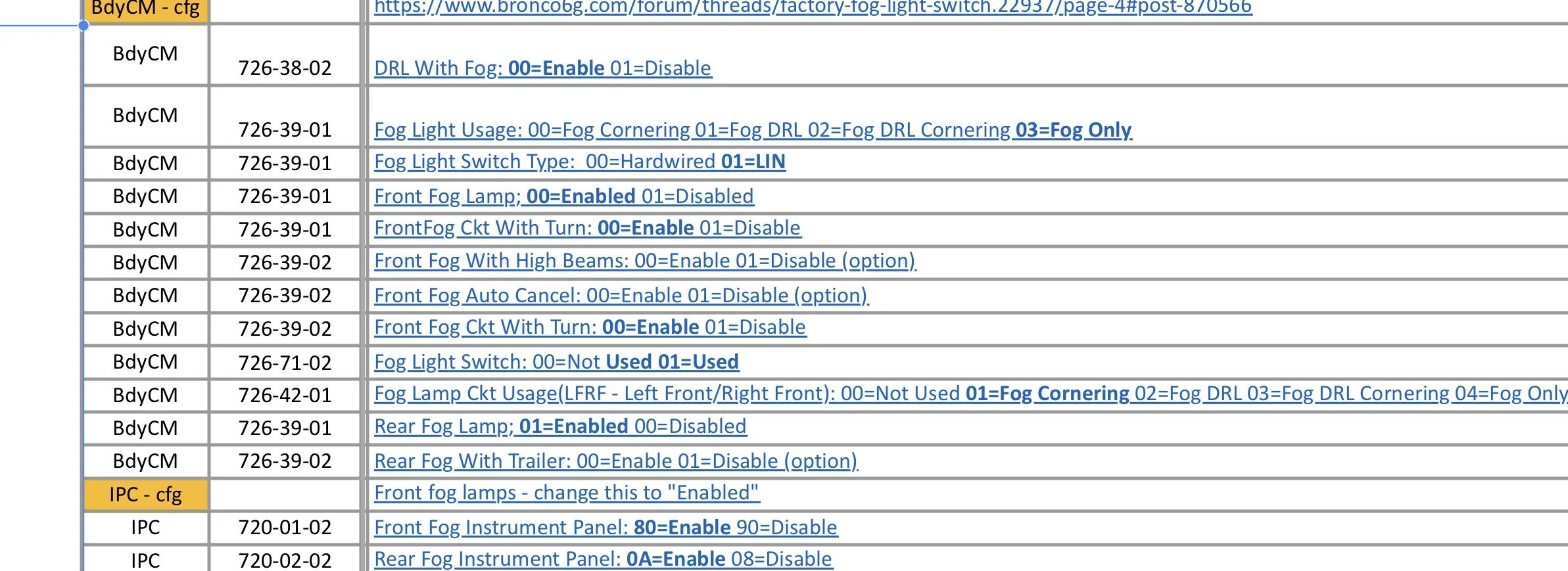

Here are all the settings for reference:
For 726-42-01: the ”0101” is for Fog Cornering, I have it set as “0303”
Fog Lamp Ckt Usage(LFRF - Left Front/Right Front): 00=Not Used 01=Fog Cornering 02=Fog DRL 03=Fog DRL Cornering 04=Fog Only 05=Power Supply
Ford Bronco Factory Fog Light Switch IMG_0263
Ford Bronco Factory Fog Light Switch IMG_0262

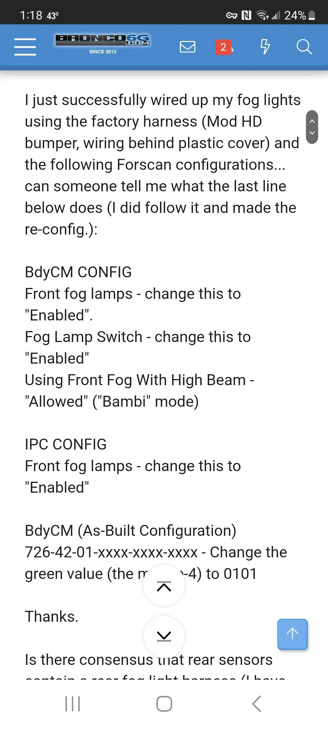

I'm in a similar situation but when I tried to change from 0101 to 0303 I got an error for the auto checksum. Sorry if this is a basic Forscan question but am I doing something wrong or just continue?
Ford Bronco Factory Fog Light Switch Screenshot 2023-04-22 220114

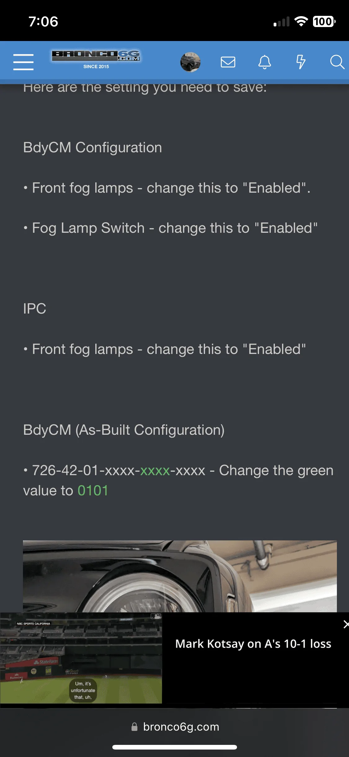

Look at the pic from an old post. There are a few places where you need to "enable" the settings as well. I had the same issue at first.
Ford Bronco Factory Fog Light Switch Screenshot_20230120_131845_Samsung Internet
