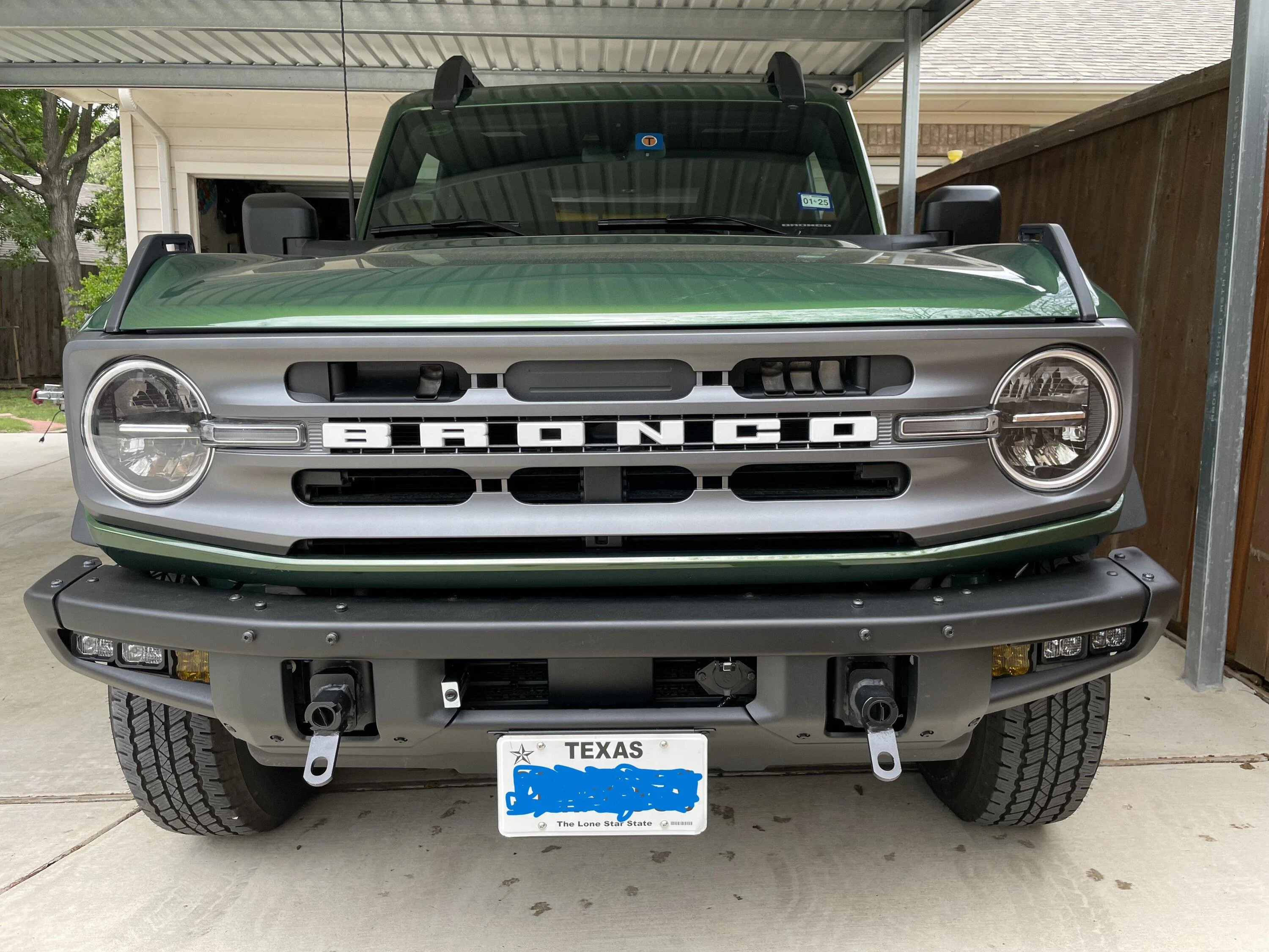

Is anyone who added a factory fog switch to the MOD bumper using a relay or are you all just tossing in those three pod lights per side with a hope and a prayer the amperage is good to go?
I just ordered my module and plan to install fogs at C203 front and C424 rear. Wondering if I'm going to have a funny burning smell at some point unless I use a relay.
I just finished my 3 pod light install. I used the factory harness from Diode Dynamics with the relay for the off road lights. I took Zuke's advice and wired in the fog lights to the ford wiring after replacing my factory switch. When I turn on the 3 way switch that came with the 3 pod light set, all lights come on (I assume through the relay system). The switch allows for all lights on in one position, or back lights on in the other. When I use the factory switch, only the fog lights are on. No burning smells ;). Hope this helps.

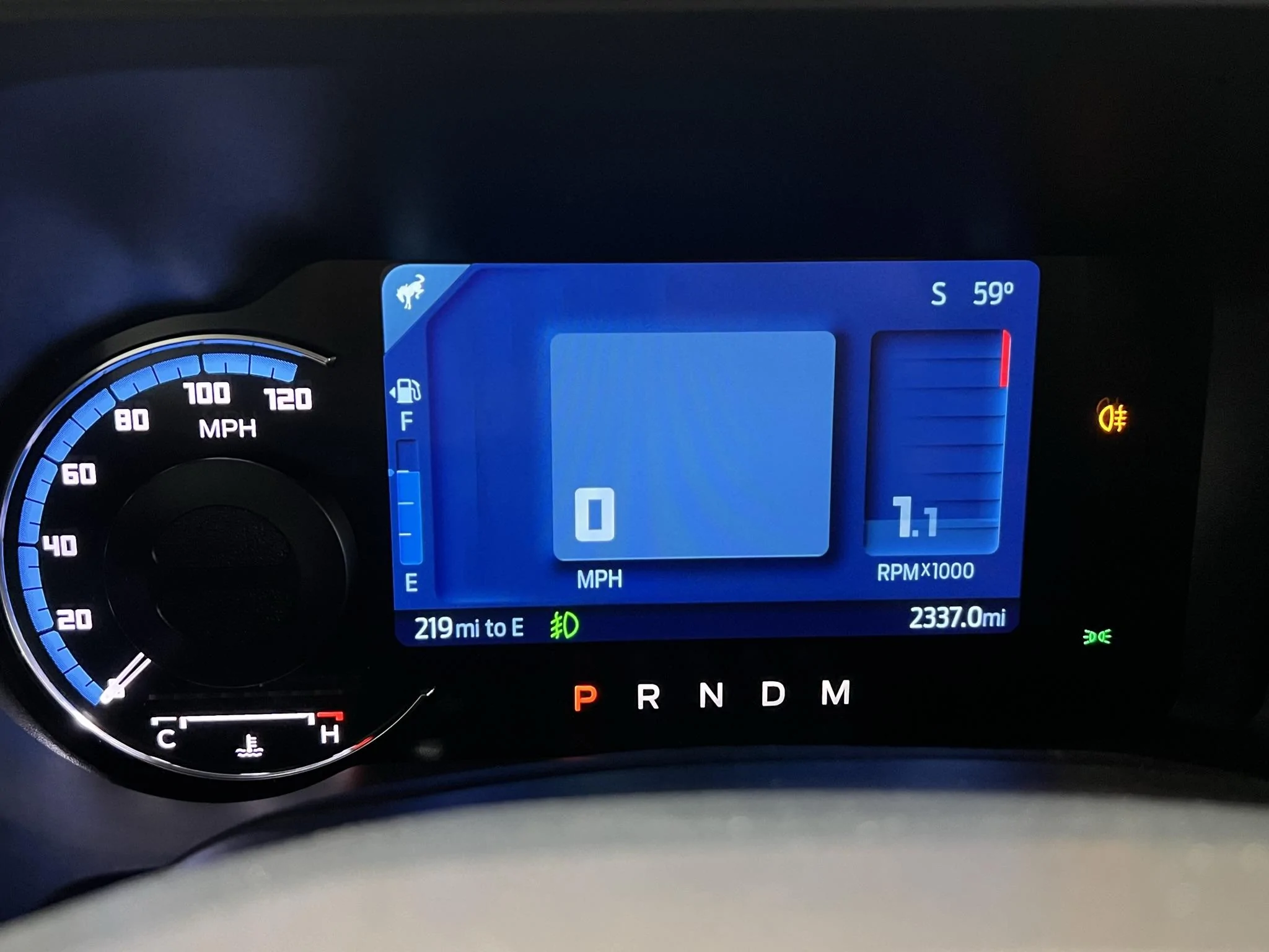

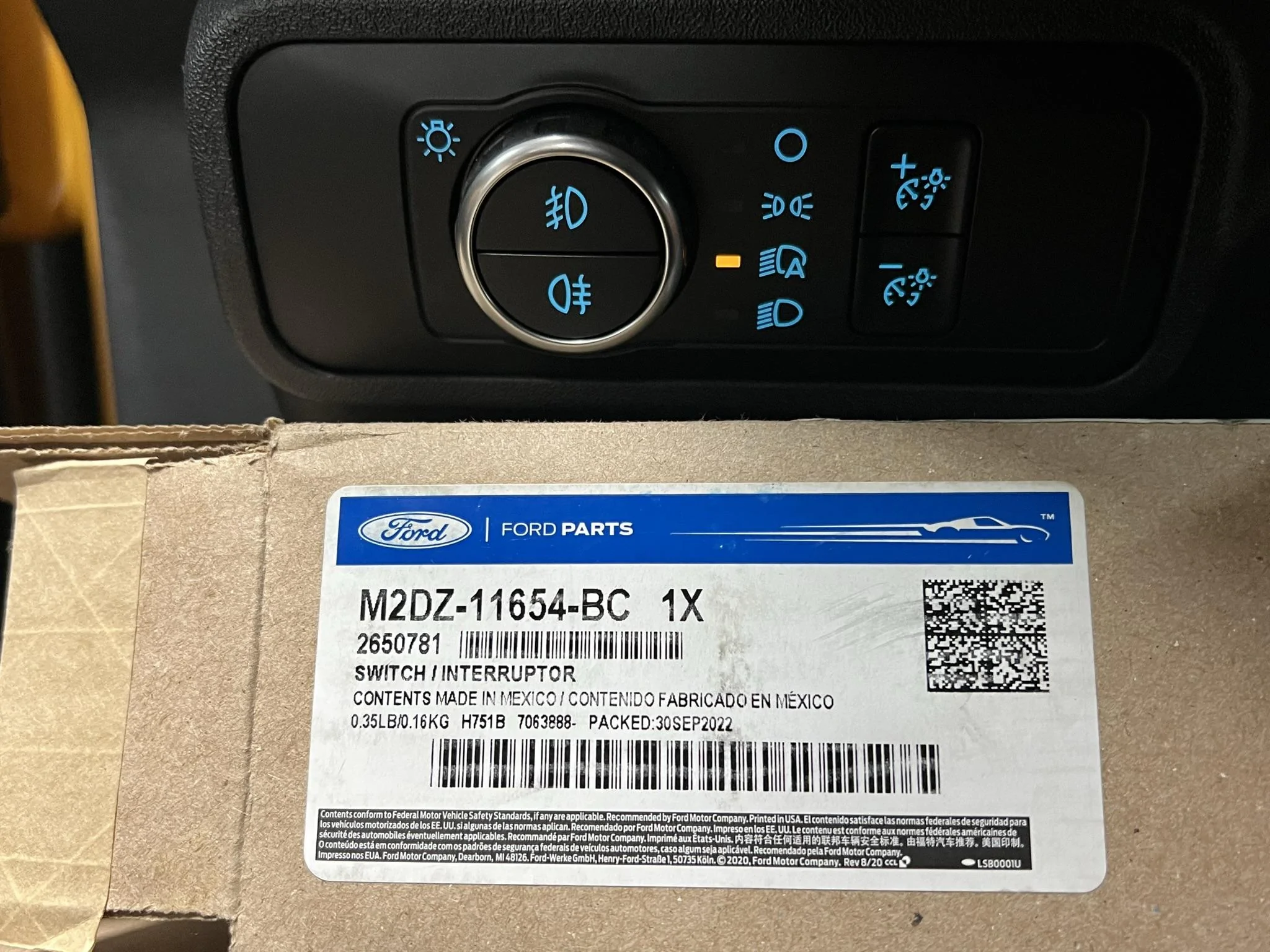

Here are a few extra steps for those with rear fogs too:
I installed the Front/Rear Switch today and used steps described in this post to activate in FORScan.
In addition to the BdyCM steps in that thread, I needed to Enable the rear fog lamps, DRL Fog, fog with highbeam, rear fog with trailer and a few others in the BdyCM since I also had the rear fog and wanted to use the fogs with DRL.
I also Enabled rear fog in IPC.
In BdyCM Instead of the '0101' config, I went with '0303' which lets me use the fog with DRL and turns on the respective side when cornering.
Everything works exactly as it should on the dash but I still need to install my lights.
With these changes, both the Rear and Front fogs will operate with only the DRL which is the best option for dusty and snowy situations where you ONLY want yellow lights.
Note that the rear fog (which I'll use as a trail light) works with DRL on only if the front fogs are also on.
