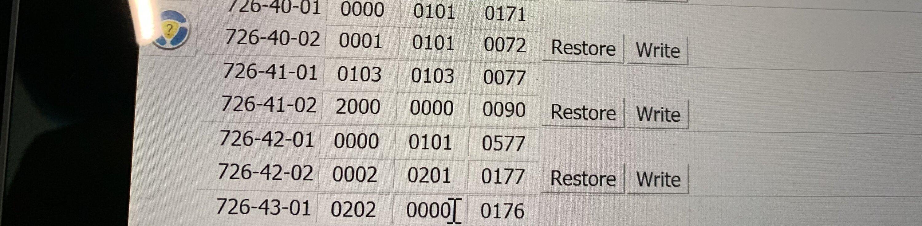

Yep- did all those changes, including trying 0303 in the as built BDYCm module. Even reverted back, saved, changed them again- nothing.

Yep, that's what I changed to on my '22 and that gave me the power, maybe it is different on the 23's.
Yep, I see you've changed it in the "as built" code lines. There is also a config section in the BCM. This is where you must also "enable" the lights and the switch on 2 different lines. I had to re-write the as-built code and click enable for mine to work. Have you done both?

I think you meant this message for someone else, mine works after following through on all the steps.

I am in the same situation as you with a 23 Badlands/Modular and I am not getting power to the fog harness ends. Confirmed forscan settings at least 5 times! Please post the results of your tracing exercise. I will try that as well as soon as I can figure out where to start.

Hey guys, just a data point here for you. I have a 23 badlands mod bumper/high package. I used the 0101 config and it worked fine and fogs are operational.
