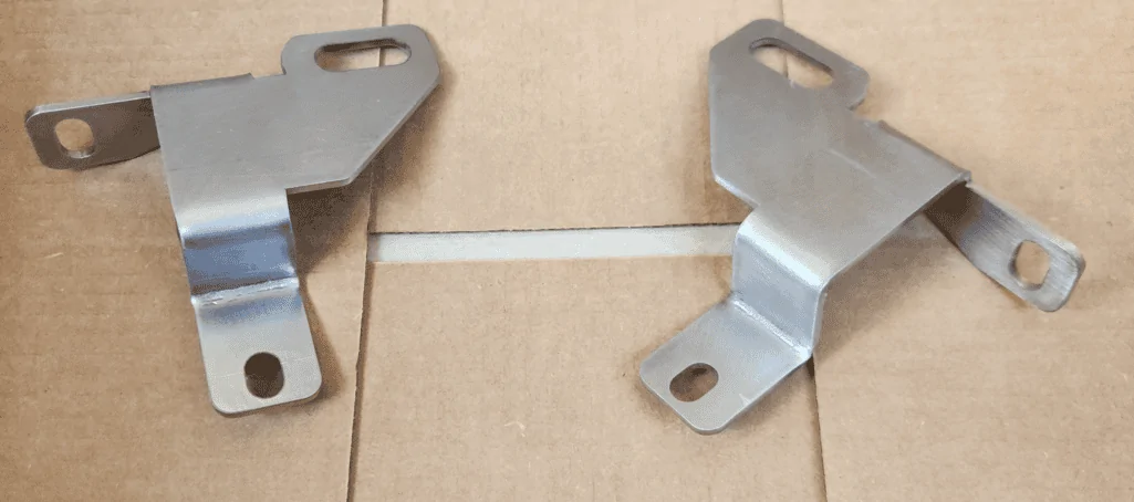

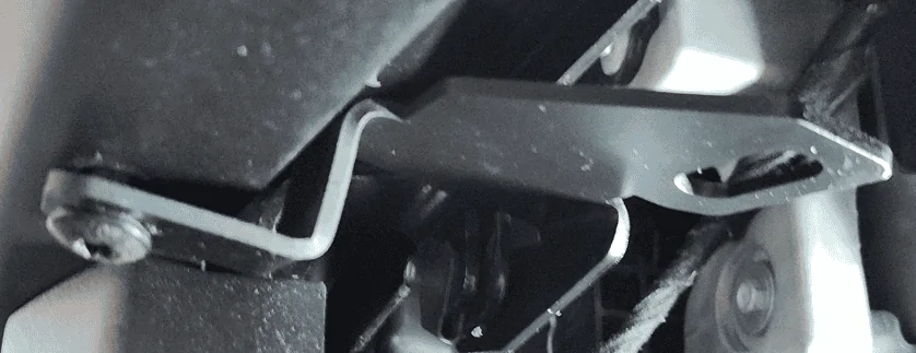

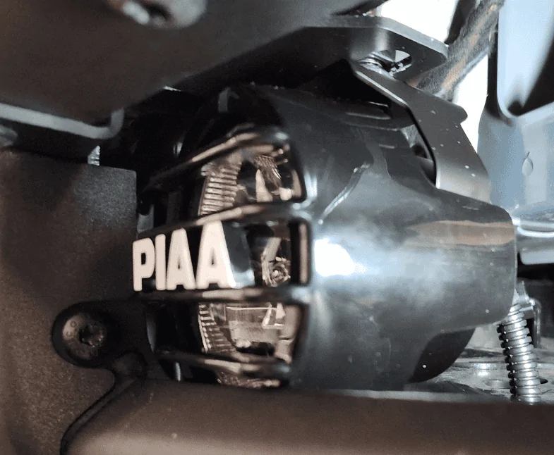

Anyone interested in the Brackets I made for my Fog Lights that mount on the MOD bumper? I can have them laser cut, bent, and powder coated.
Prob sell for $80 for a set maybe and that would include shipping.
Let me know if anyone is interested I will make a for sale post.
