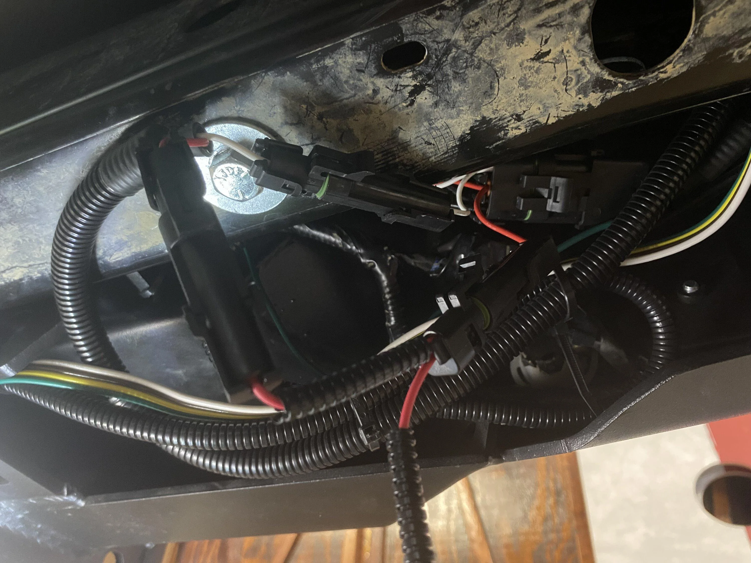

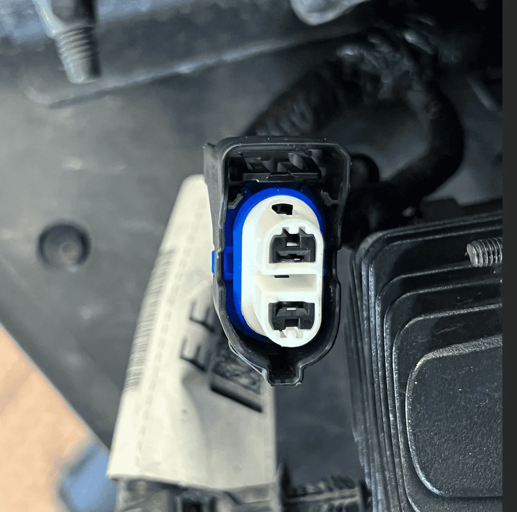

Hoping for a little help and guidance. I have the factory wiring and fog light switch that came with the Bronco (came with plastic bumper/factory fogs/front sensors and switched it out to a modular bumper) and am adding Oracle triple fogs. I bought this harness from you hoping it would match right up:
https://www.4x4truckleds.com/crysta...il-pair-2021-ford-bronco-w-hd-modular-bumper/
When I went to install this morning, it the gray end looked like it would match up to the Oracle harness end, but the OEM harness end was different. This is what I have that was plugged into the factory fogs that came with the plastic bumper. Do you have any harness that will match up or any guidance? Is it a DT 2-pin to H11?

You have the plastic bumper but that harness you linked is for modular bumpers.
I don't know what kind of connectors Oracle uses but we sell the following
H11 -> 2-Pin WP: https://www.4x4truckleds.com/crysta...gtail-pair-2021-ford-bronco-w-plastic-bumper/
H11 -> 2-Pin DT: https://www.4x4truckleds.com/diode-dynamics-deutsch-dt-adapter-wires-h11-h8-h9-800-881-pair/
H11 -> 4-Pin DT: https://www.4x4truckleds.com/diode-...wires-w-backlight-tap-h11-h8-h9-880-881-pair/

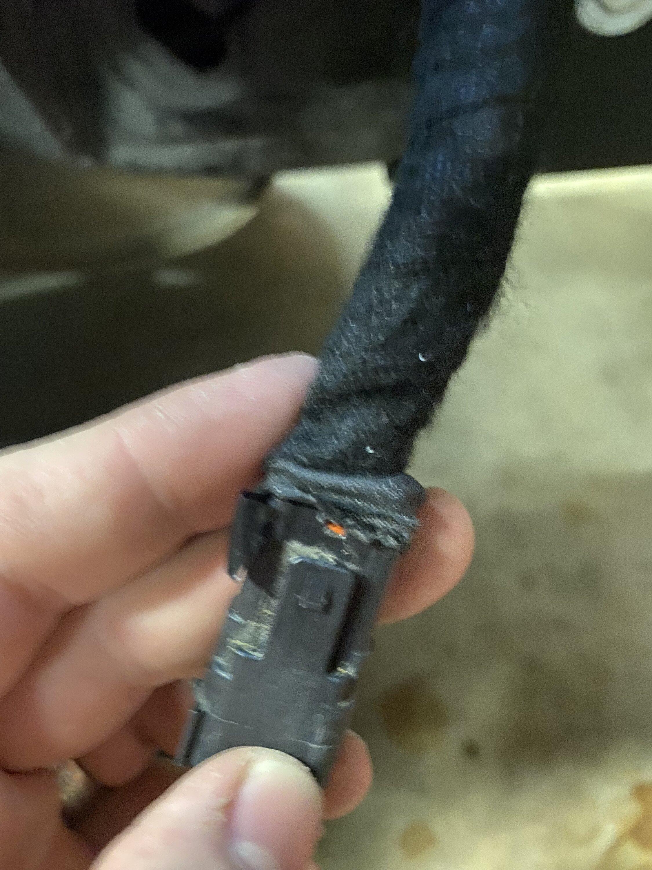

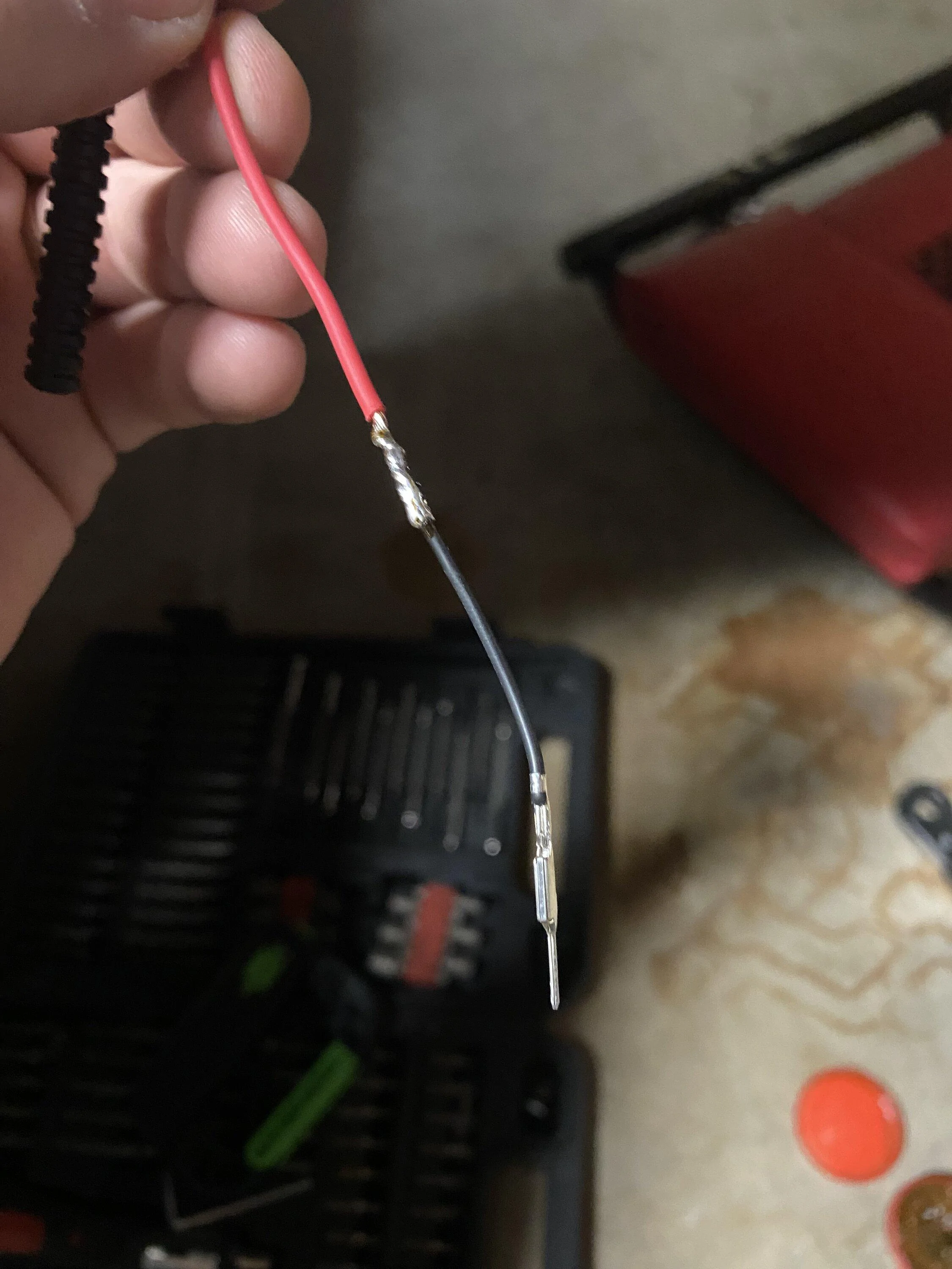

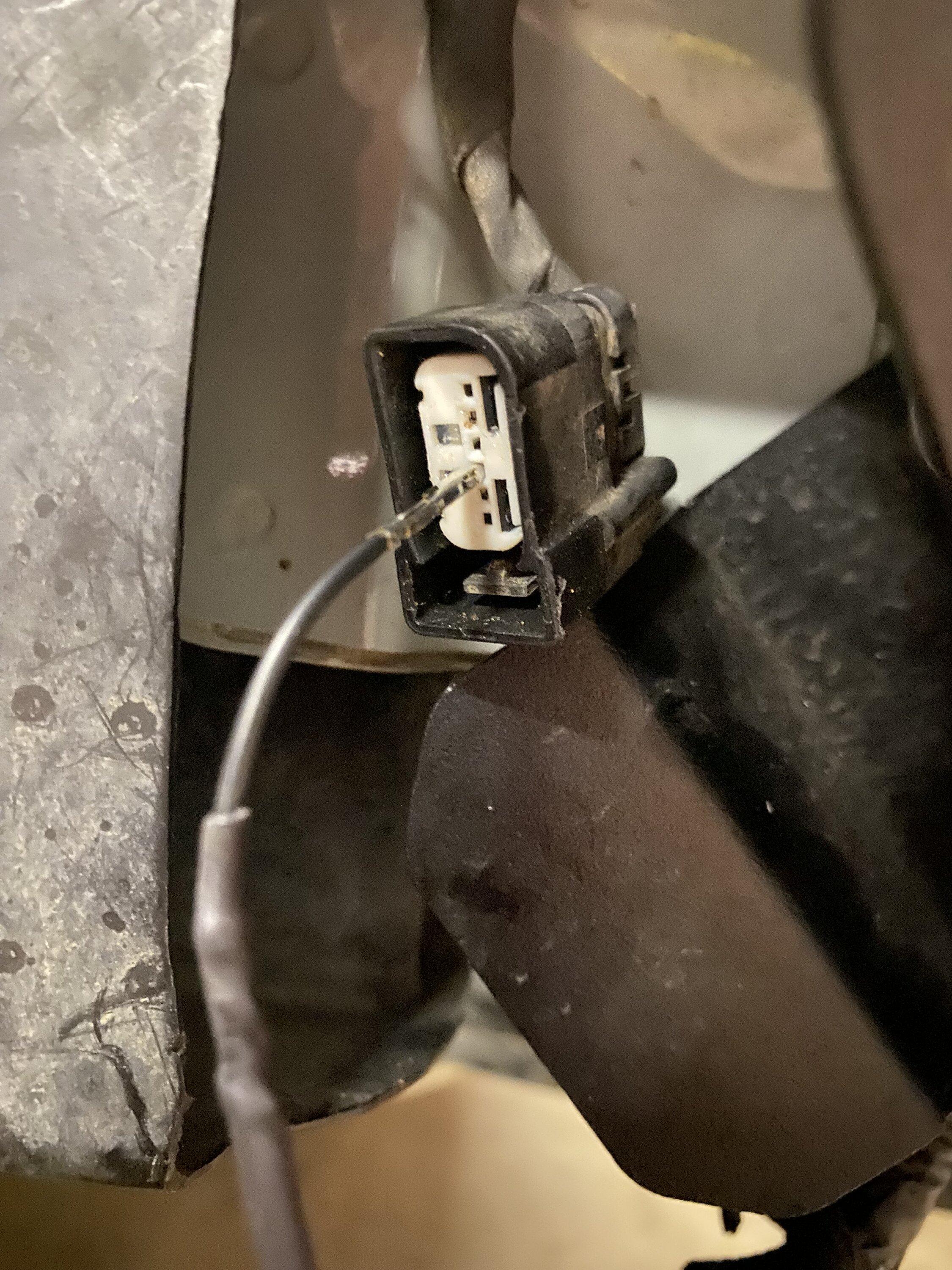

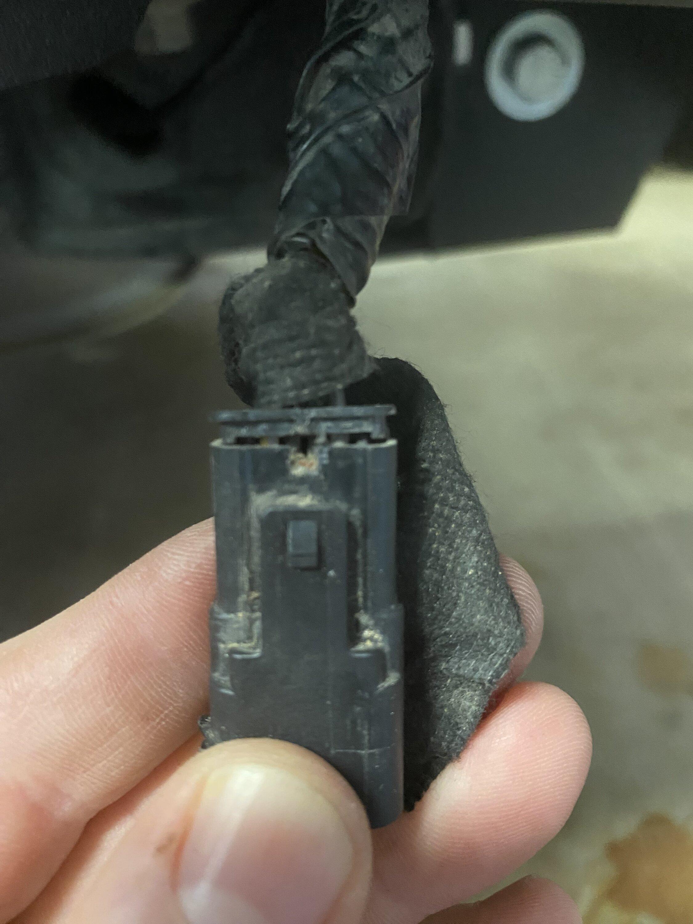

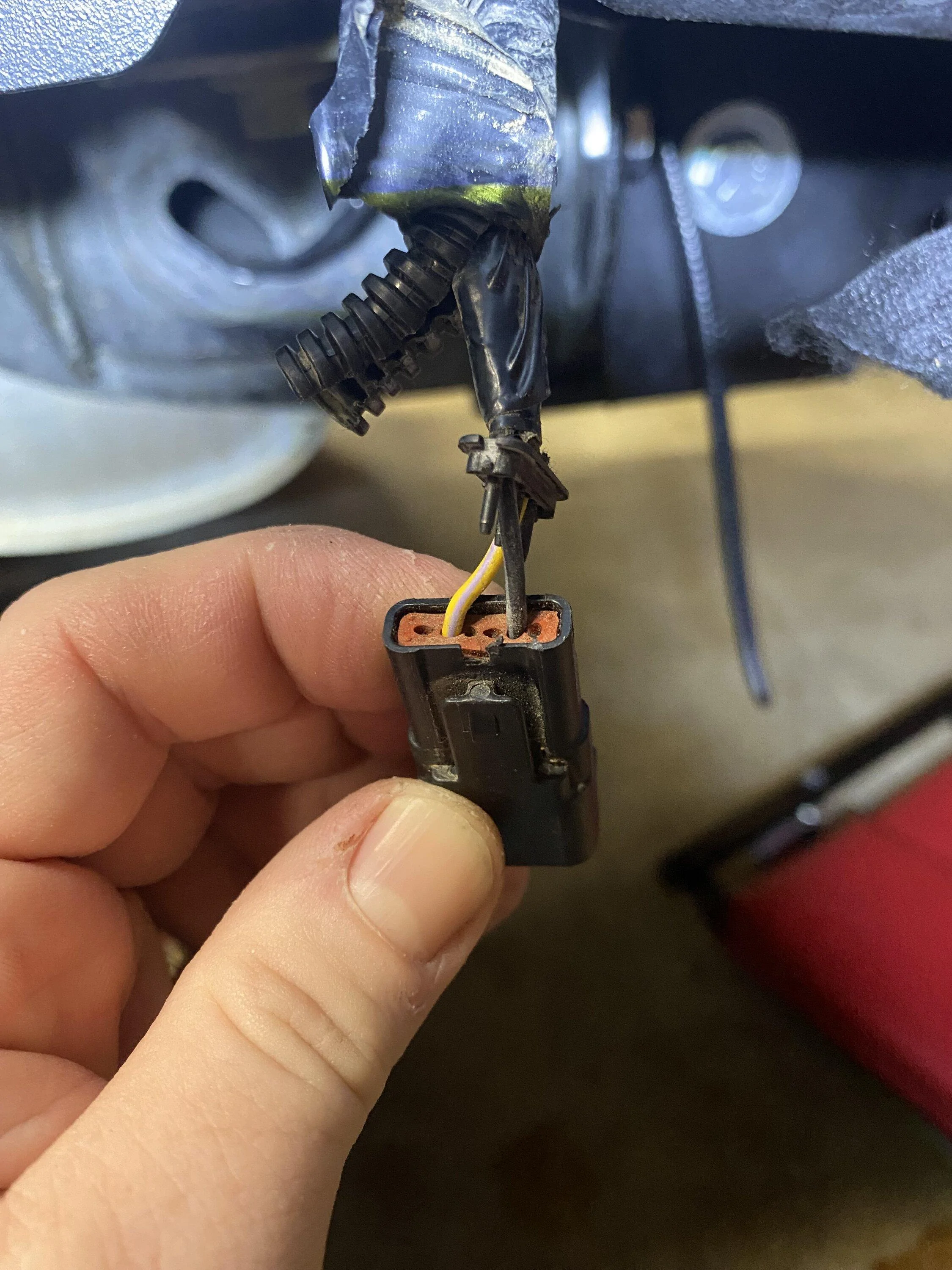

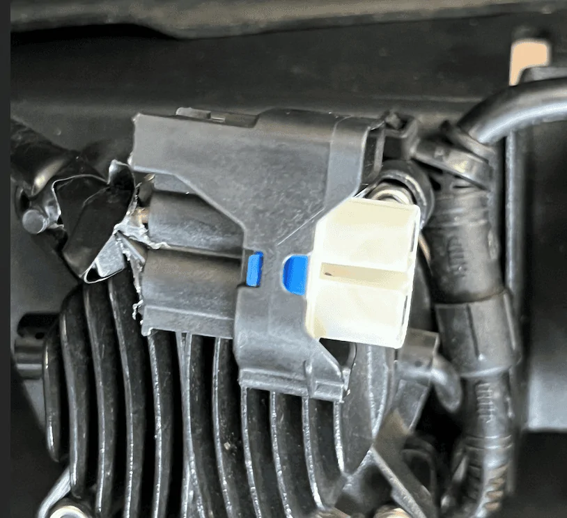

As a follow up to my above post, here's a bit more detail on what I did to modify the bumper side of the C424 connector so that my rear Didode Dynamics ('fog' 'chase' 'backup') lights work with the push of the rear fog button on my M2DZ-11654-CC switch (while the headlights are on). I unplugged the connector, peeled back the wire harness tape on the bumper side, and noted that there are two wires running into the sealed end of the connector.
I used a drill bit to drill a hole in the back of the bumper side connector. I stepped up to a 7/64 bit for it to be large enough to get the EU2Z-14421-BA connector to fit through. In the process of figuring out the right size and getting the routing precise, I broke two of the five connectors in the kit and managed to break through the sheathing to expose the bare wiring on a 3rd connector. It's good that the kit came with 5 connectors, as I still have one spare. ;) I eventually remembered that I had some baling wire that I could work through the hole and into the correct pin location.
Now instead of two pins on the bumper side of the C424 connector I have three.
I plugged the two sides of the C424 connector back together and tested the bare end of the EU2Z-14421-BA wire with my voltmeter to ensure power was passing through, indicating a good pin connection.
I add a bit of silicon to help seal the new wire, taped up the connector, and ran the new 18 gauge wire across the frame, under the heat shield behind the 10mm bolt on the driver side above the muffler. (Red line shows routing)
The wire runs into the same grommet as the diode dynamics wiring harness into the cargo space, under the rear plastic trim, and tucks into the same space as the diode dynamics harness on the rear passenger panel area. (This pic was before crimping and heat shrinking the connector)

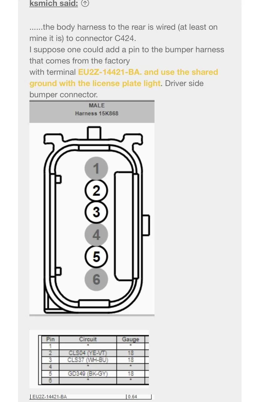

I did this same procedure to get my rear fogs working with the new OEM switch M2DZ-11654-CC:
Ford Bronco Factory Fog Light Switch 420fbe0e2c39050e6c01751c1976f2a5

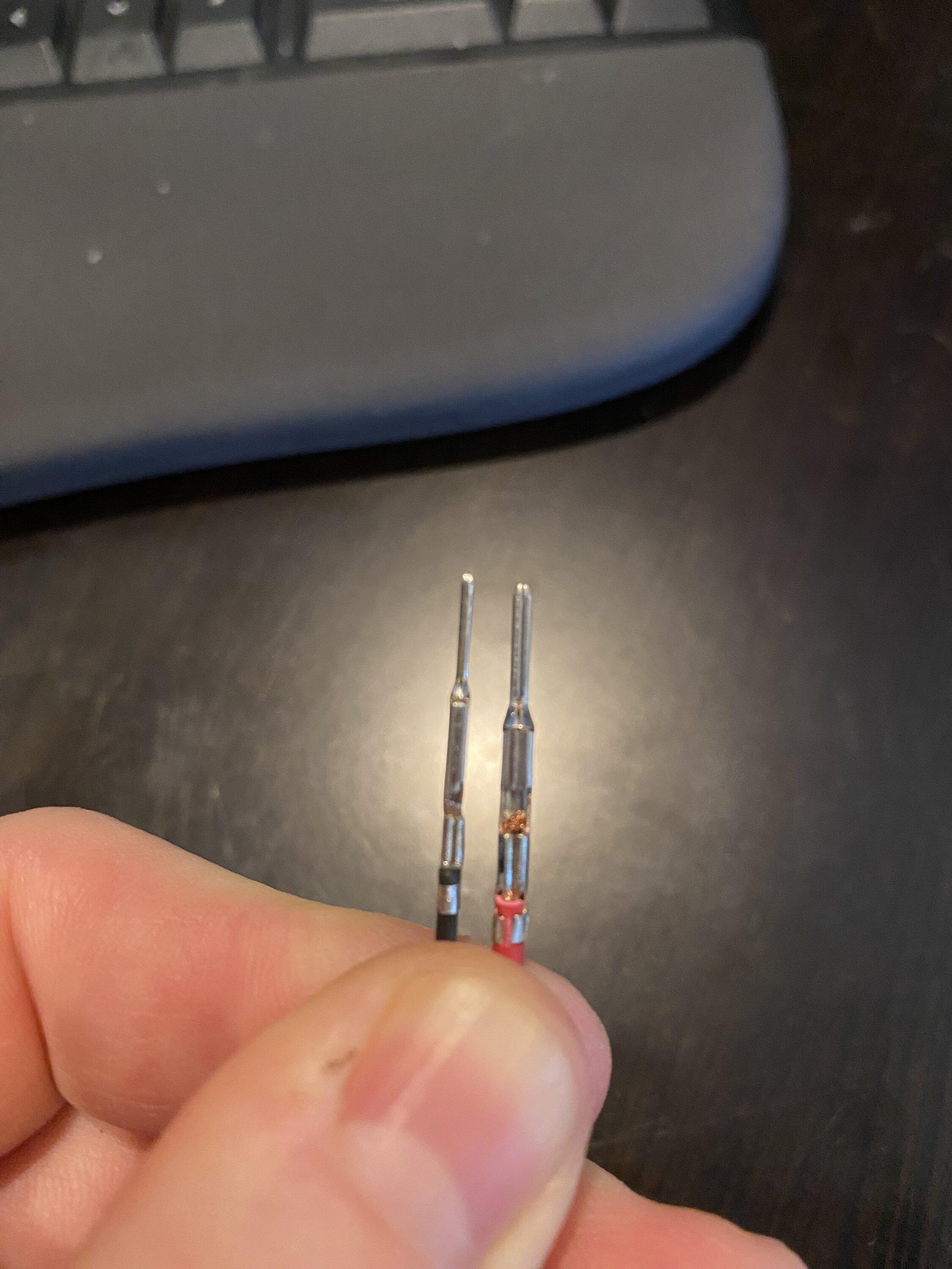

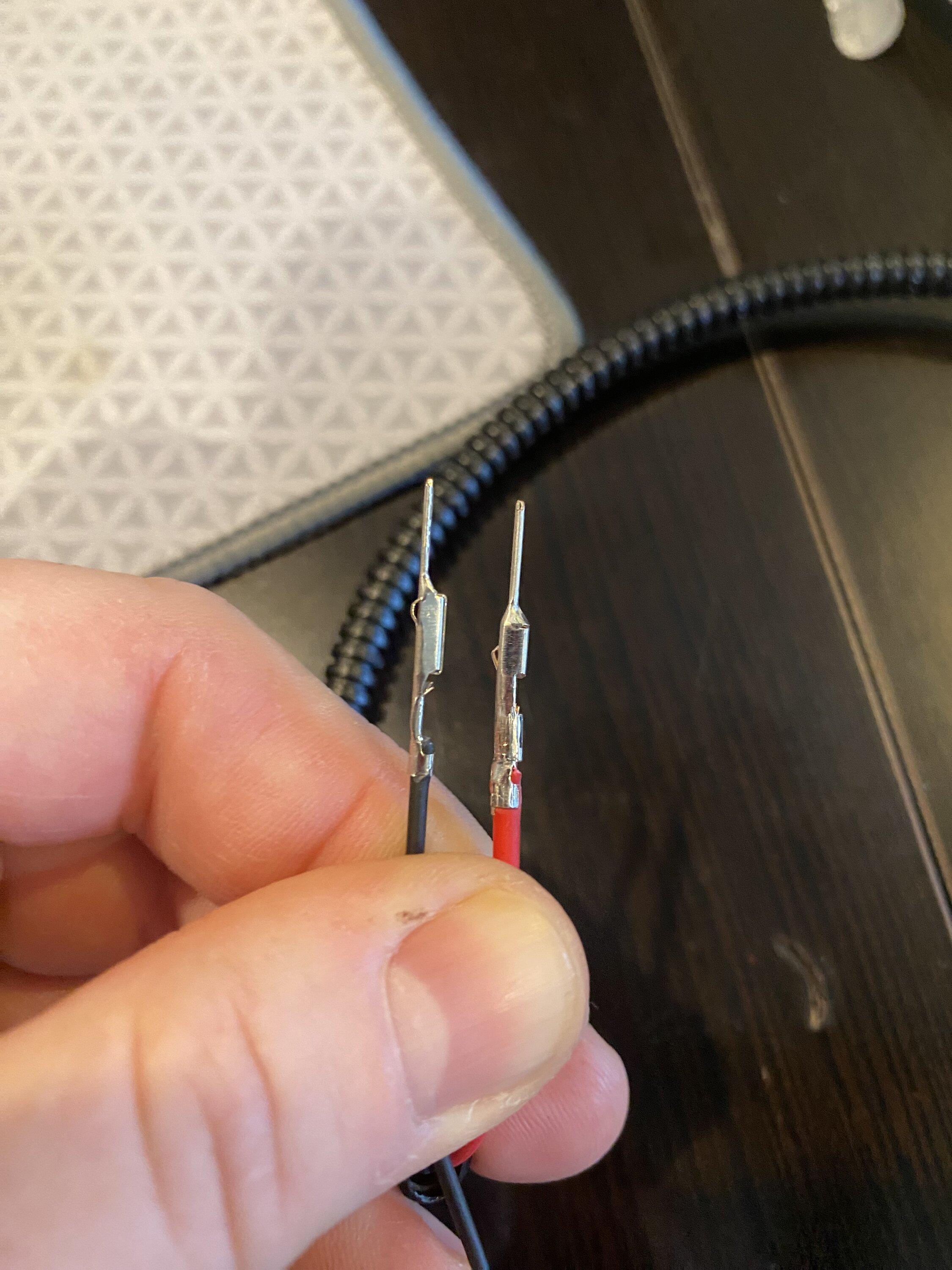

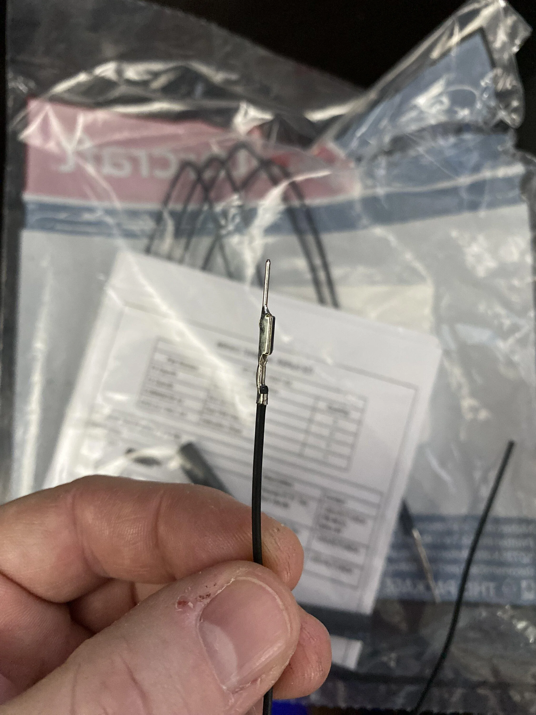

And using these terminal pins:
Ford Bronco Factory Fog Light Switch 71253090605__2C4A526A-2290-41E6-B9F4-956C322729A5
Ford Bronco Factory Fog Light Switch 71253092252__D133FEA7-9720-4985-8856-00253D96AA51

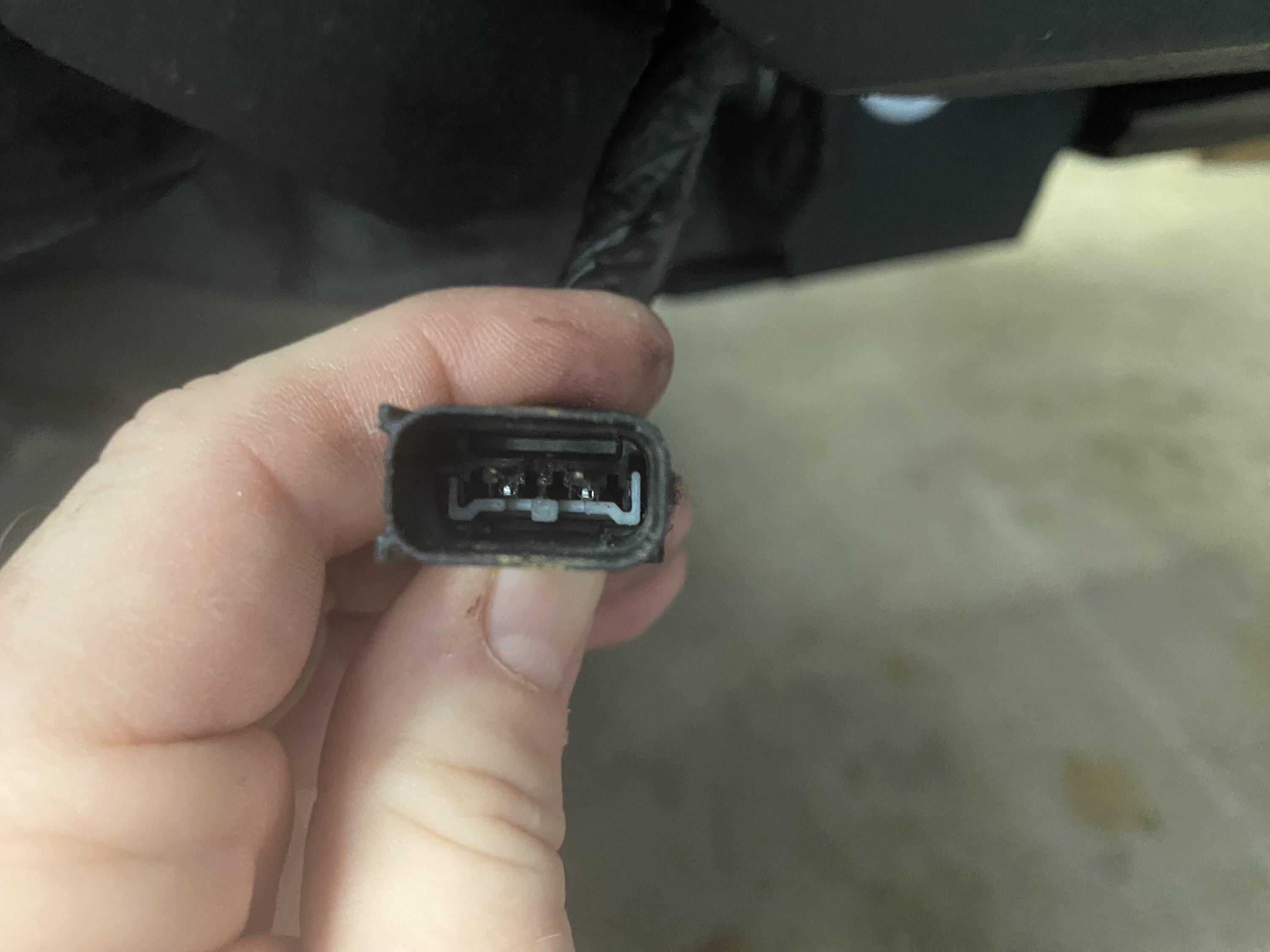

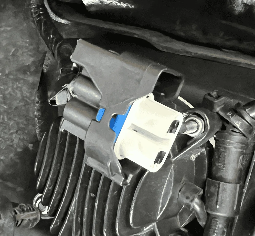

However, I figured out how to open the connector and add the terminal. Thanks to @flip for helping with the parts.
You’ll need to remove this grey retainer clip with needle nose plyers.
Ford Bronco Factory Fog Light Switch IMG_6618
Ford Bronco Factory Fog Light Switch IMG_6625

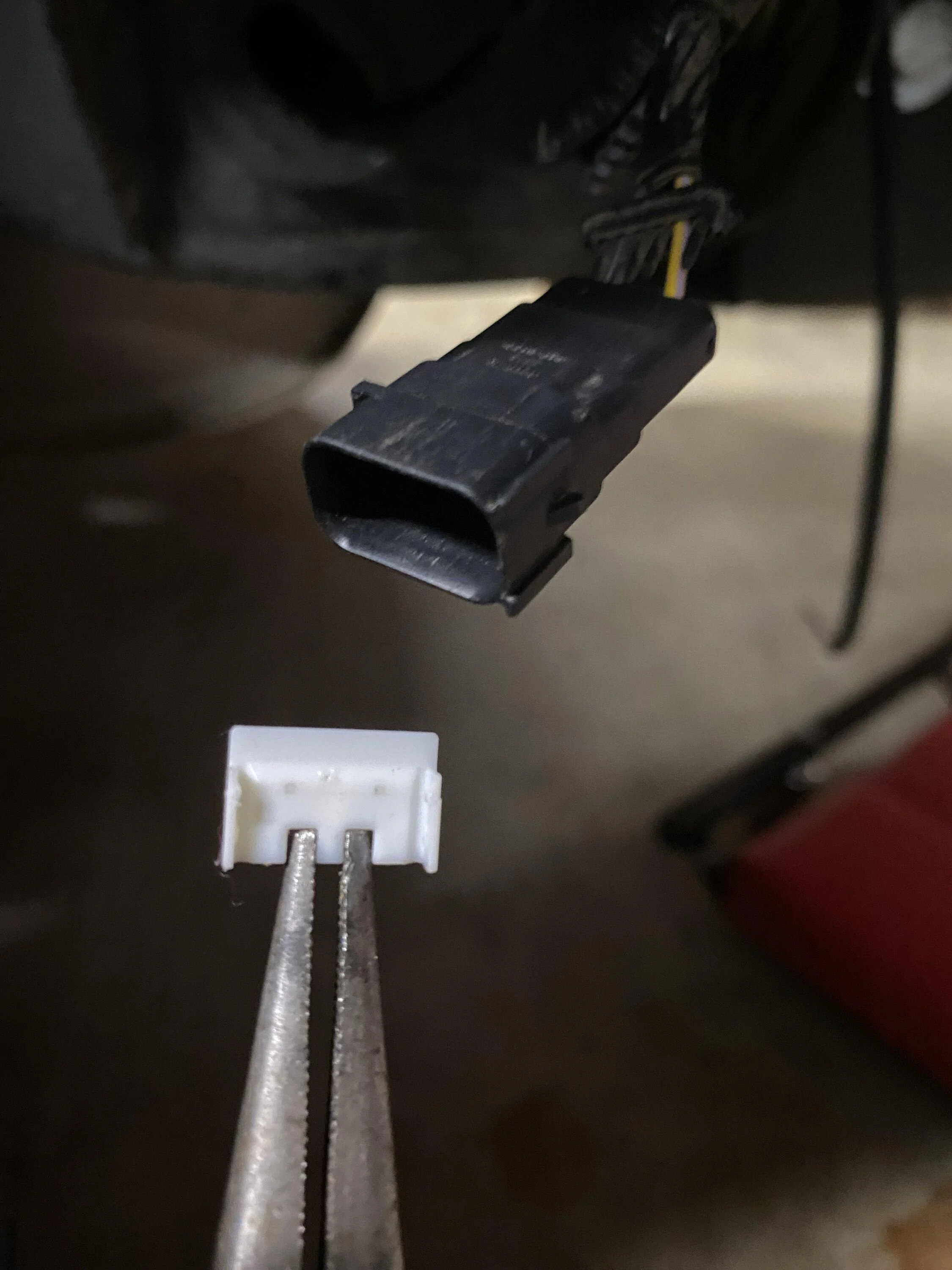

Use a small flat head or pick to open the back plastic plate and slide it back on the wires. This will expose the weatherproof rubber plug.
Ford Bronco Factory Fog Light Switch IMG_6619
Ford Bronco Factory Fog Light Switch IMG_6626
Thanks to @FordOwner and @ksmich for the terminal info. Its Pin 3 the CLS37 (WH-BU) wire. The White - Blue wire:

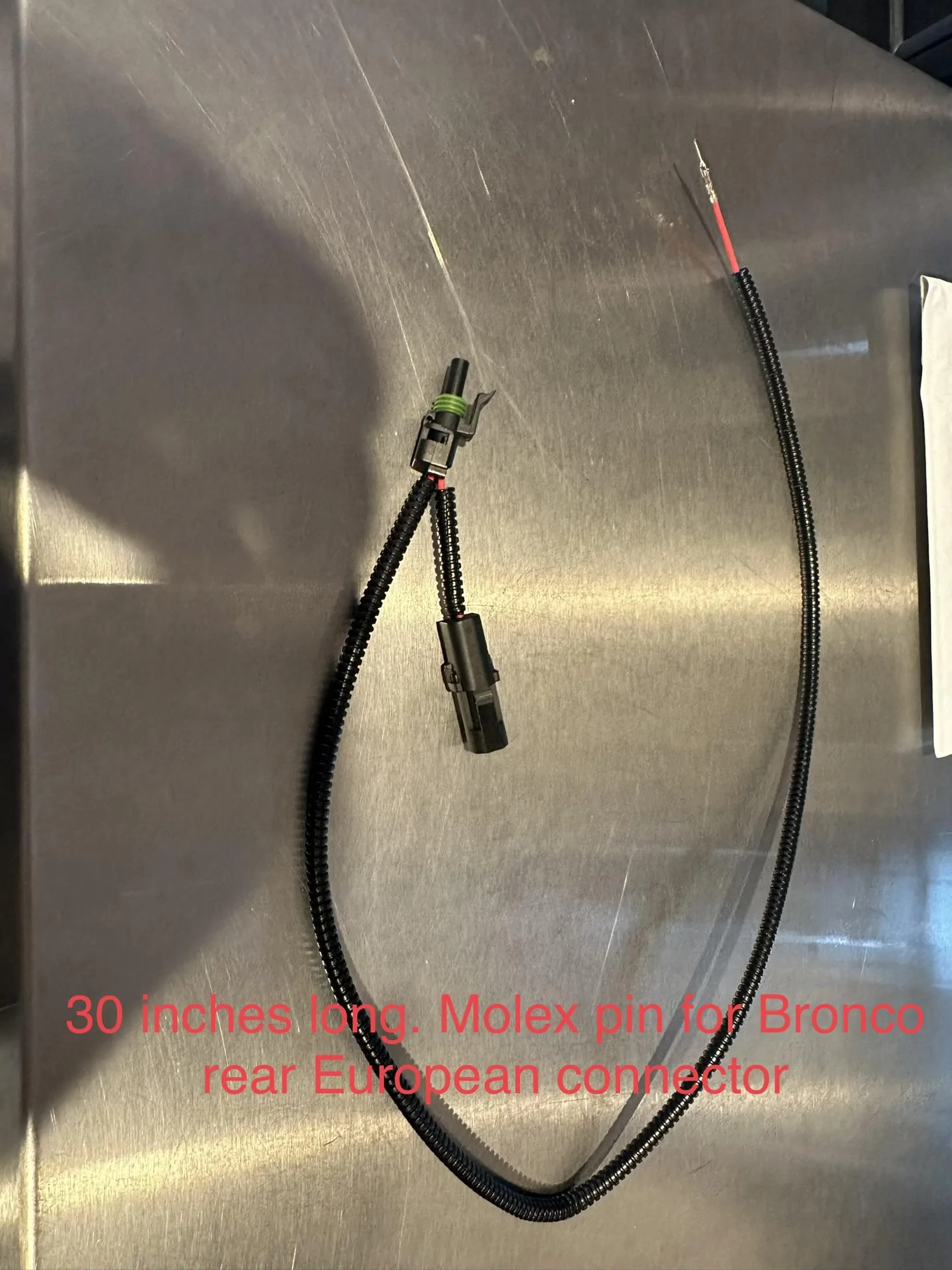

Thanks to John @SPVPARTS for his help on how to wire it all and providing the pigtail needed. He was having trouble sourcing the Ford plug, to make this an easy plug-n-play setup, so we went this route. It plugs right into his short rear harness. Disregard the label though, as it’s for the American rear harness, which isn’t wired for the rear fog. I highly recommend John and @SPVPARTS if you have lighting needs or projects, he’s been super helpful!
Ford Bronco Factory Fog Light Switch IMG_9308
Disregard the spaghetti wiring, but this is how the pigtail plugs in…
Ford Bronco Factory Fog Light Switch IMG_6620
He thought he had a terminal pin that would work, and figured I’d try it, but it was slightly too large. I had to cut it off and soldered on the right one.
Ford Bronco Factory Fog Light Switch IMG_6615
Ford Bronco Factory Fog Light Switch IMG_6616
Ford Bronco Factory Fog Light Switch IMG_6627
I added some heat shrink and tested the fit/function before I install the pin terminal in the plug. It all works!

You’ll need to use a small bit, I believe I used 3/32, to make a hole in the plastic plate. You’ll need to pull rubber plug back so you can see the terminal and insert the pin. Pay close attention to how you insert it, it will click into place when done properly. I used a small flathead and needle nose, be careful not to tear it…hread the pin/wire through the plate and 3rd hole in weatherproof plug.
Ford Bronco Factory Fog Light Switch IMG_6629
Ford Bronco Factory Fog Light Switch IMG_6630

Close it back up
Ford Bronco Factory Fog Light Switch IMG_6632
Don’t forget to reinsert the retainer clip! I almost forgot…
Ford Bronco Factory Fog Light Switch IMG_6633
Ford Bronco Factory Fog Light Switch IMG_6634

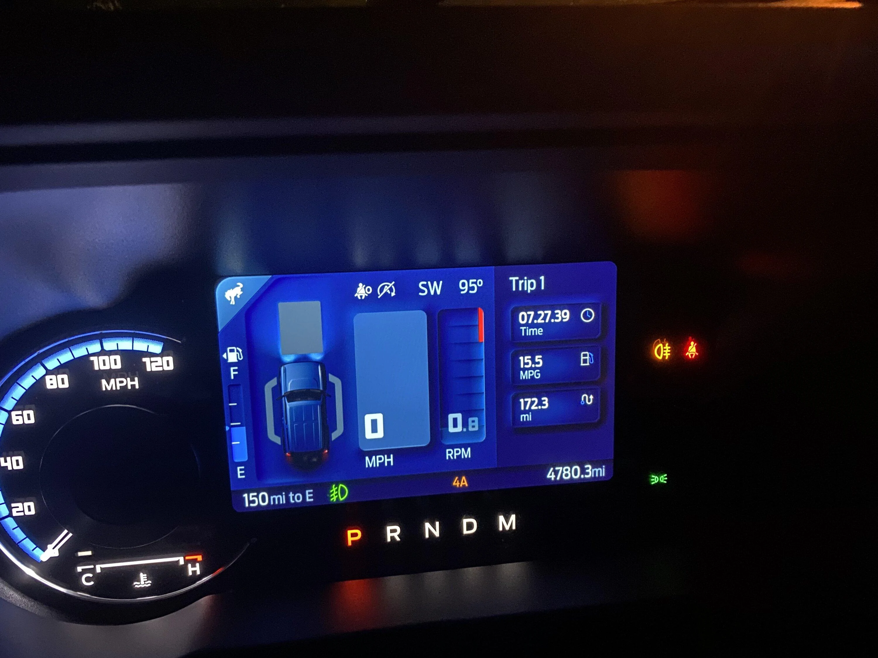

Plug back in the connector and you’re good to go… Note the orange fog symbol next to the seat belt symbol (see earlier post with ForScan changes)
Ford Bronco Factory Fog Light Switch IMG_6635
