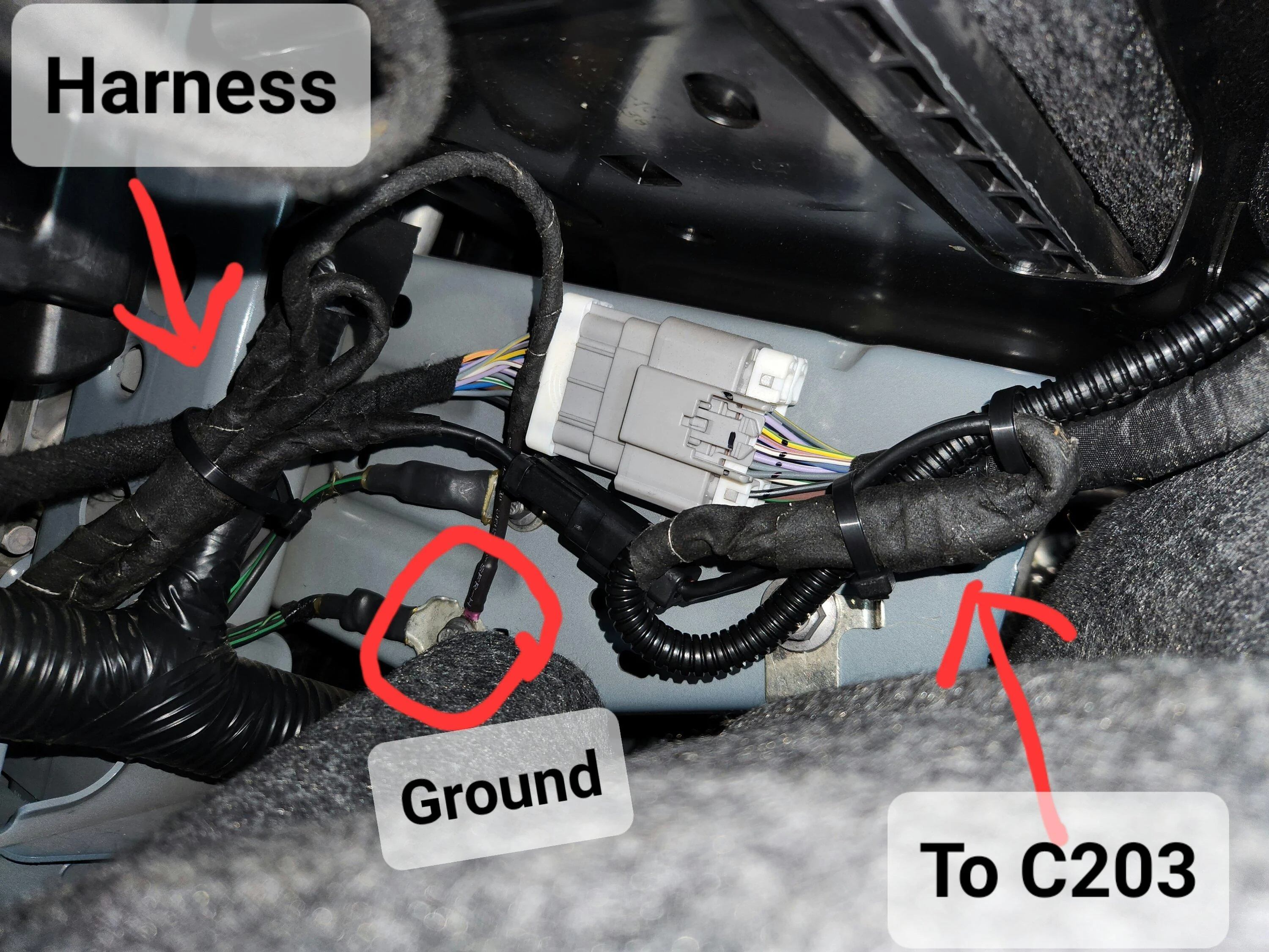

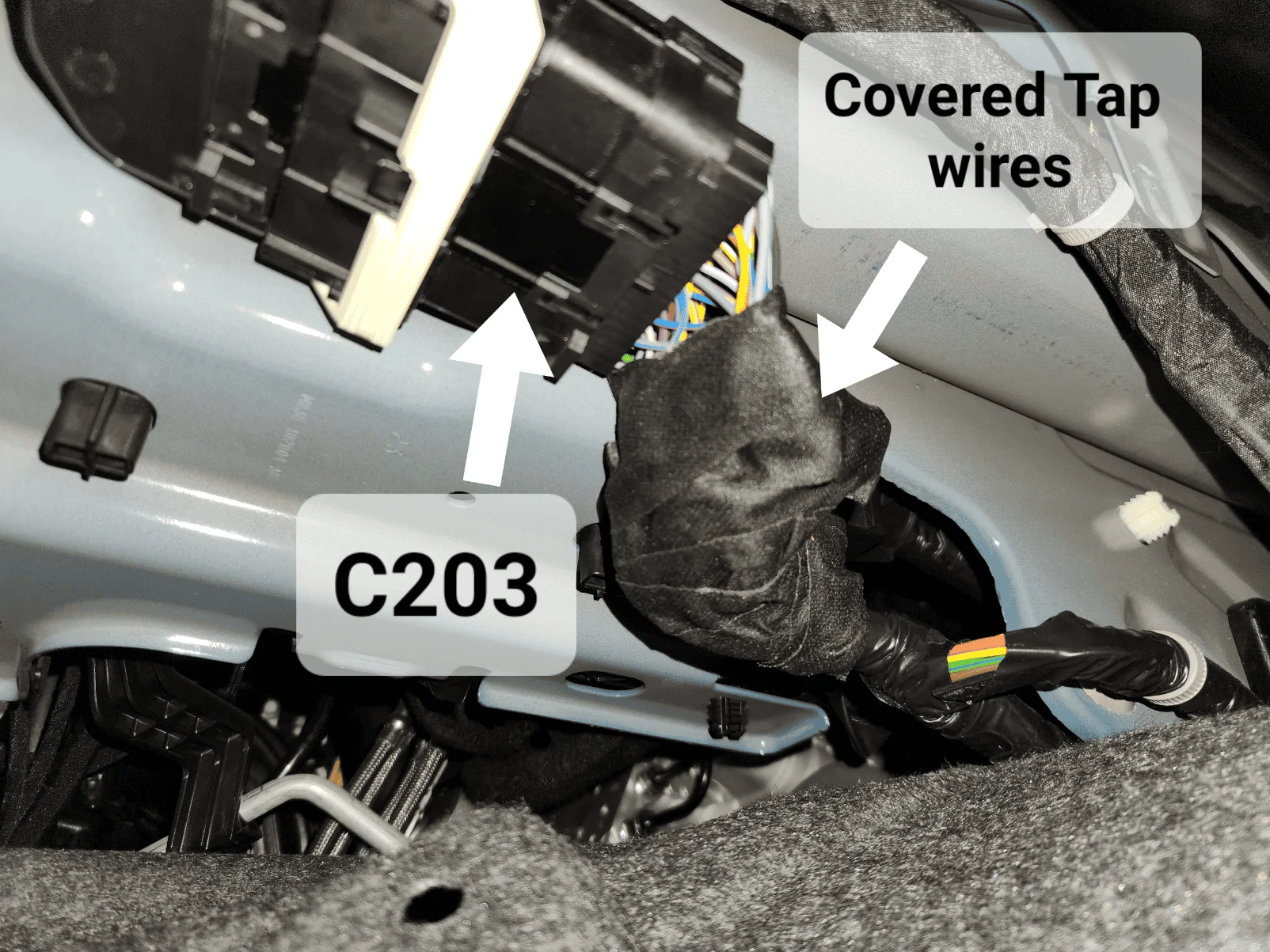

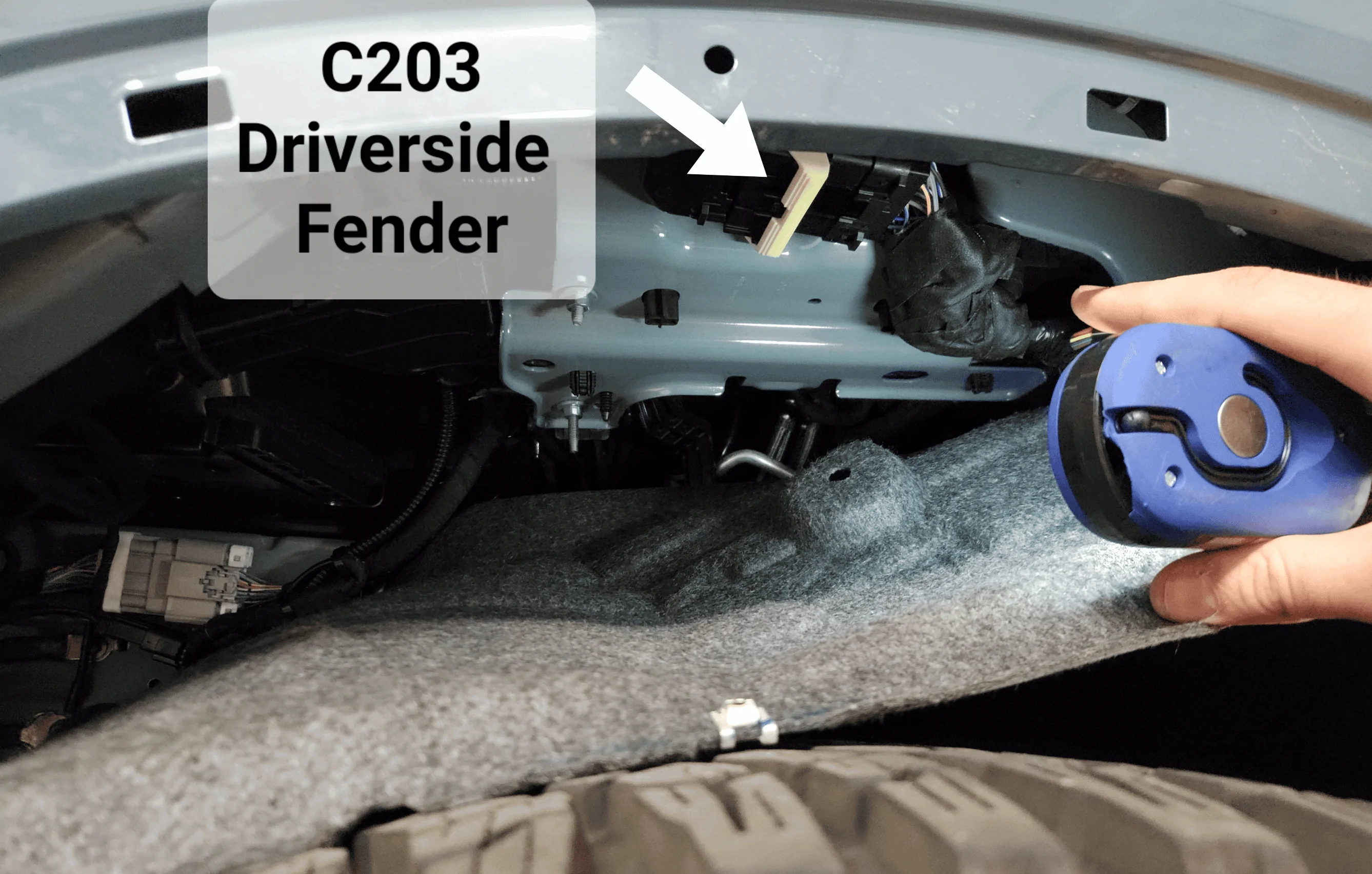

If you watch my video I just posted on here yesterday from Youtube you will see where to Tap into the Factory Fog wires. I used *Posi-Taps* (See video at 0:44 secs) to tap the wires and wrapped them up in friction tape to keep them protected. I used a Blue Wire to the Factory Brown wire, and Yellow to the Factory Yellow/Org wire. I figured Blue to Brown sounded good since thats all I had and I didn't want to use black or red etc.
My harness has 3 sections split up: Tap Wires from C203 to a 2pin Deutsch connector, next section is Split off Driver connector w/ Pass connector & Ground point, then Passenger Section wires. This way I can replace anything by sections or replace the lights later on. I also added Deutsch connectors to the PIAA fog lights since they only had m/f bullet connectors.
Also, you will see my Fogs come on without the headlights on so just the Running lights/Markers are on. I enabled this using Forscan.
I don't think you can have it connect to an Aux switch and the Fog power unless you have back lighting built into the fog lights that you want powered via the fogs. The Fogs get powered from the BCM module so there is no fuse to look for etc.
I don't recall all the codes, I know you can enable the settings for DRL and other options as well which I did for mine.

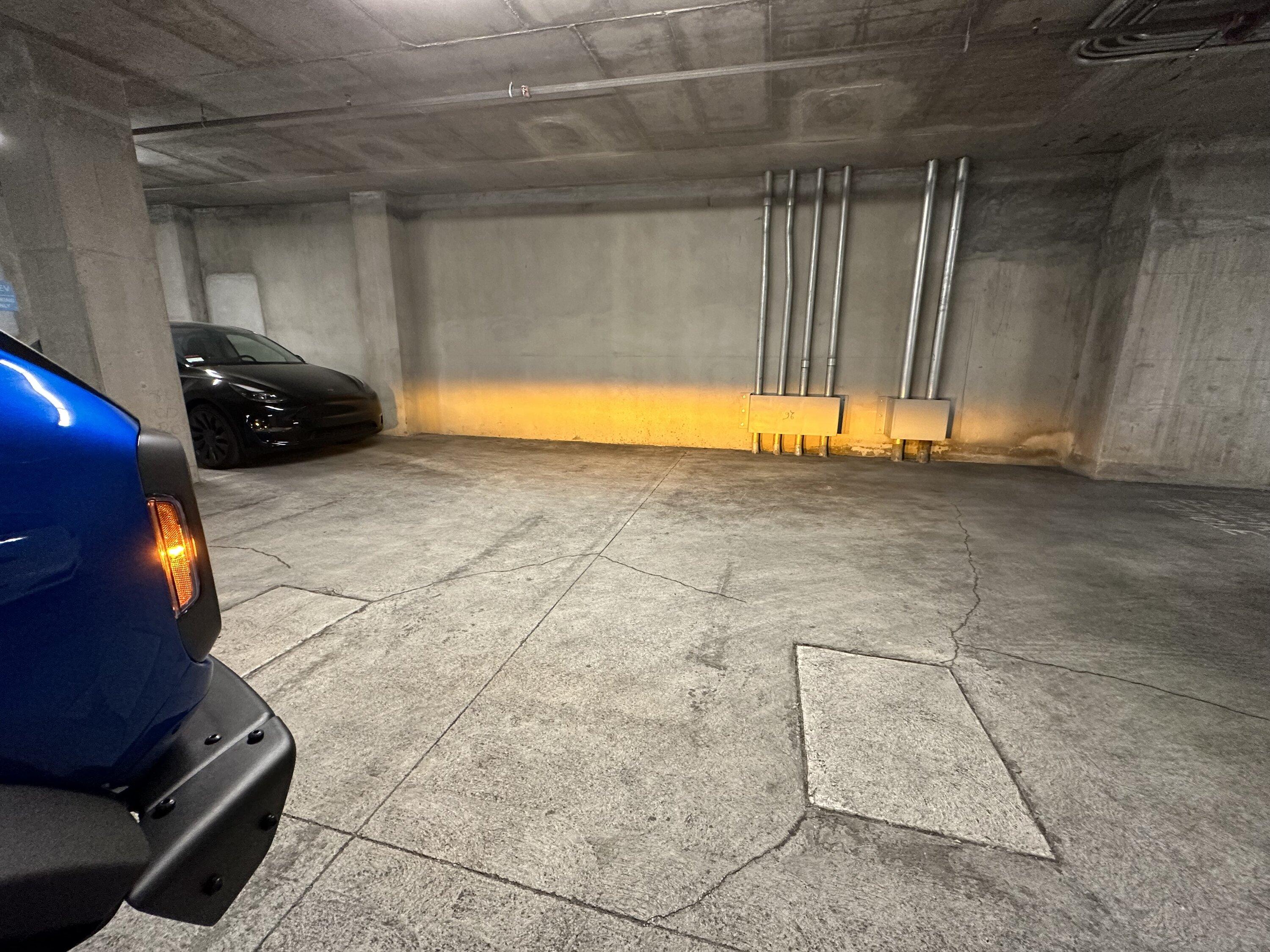

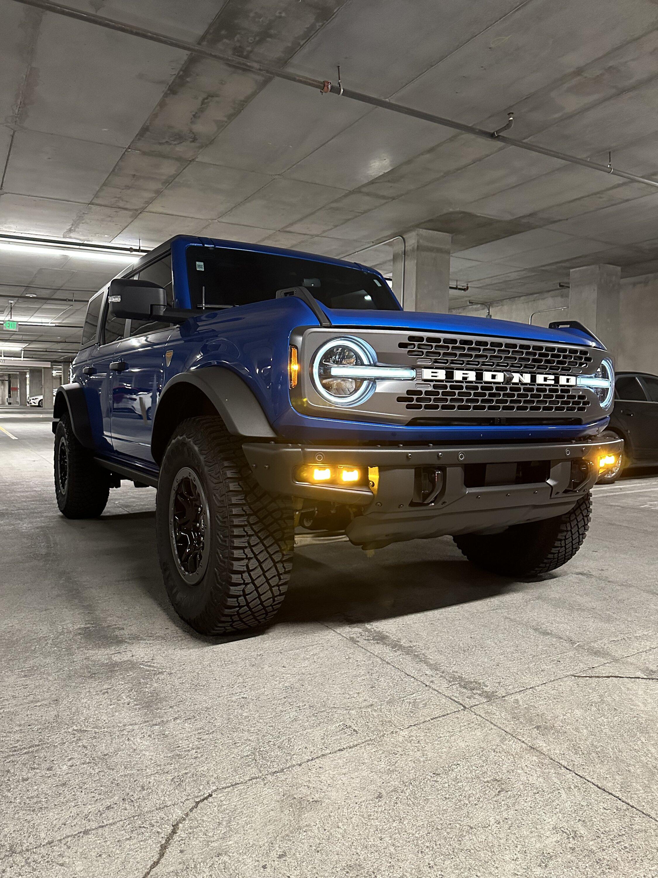

Thanks I'll take a look. I have factory fog lights already, so I'll have to look into the settings and see what Else I can find.
I mean if the headlight switch is set to auto, and I press in on the dial to turn the fog lights on, I feel like they should come on whether or not the headlights have decided to come on or not.
Question for you: So how do you turn your fogs off and on? Are you using the factory switch to toggle them as needed,or do they just stay on all the time with your lights?
Yes I use the automatic on and use the fog button on factory switch to turn them on. I didn't change the forscan code to remember what last setting was. Once I turn the lights off completely the Fogs remain off once you turn the lights back on. I'm sure you can change that but I don't mind it.

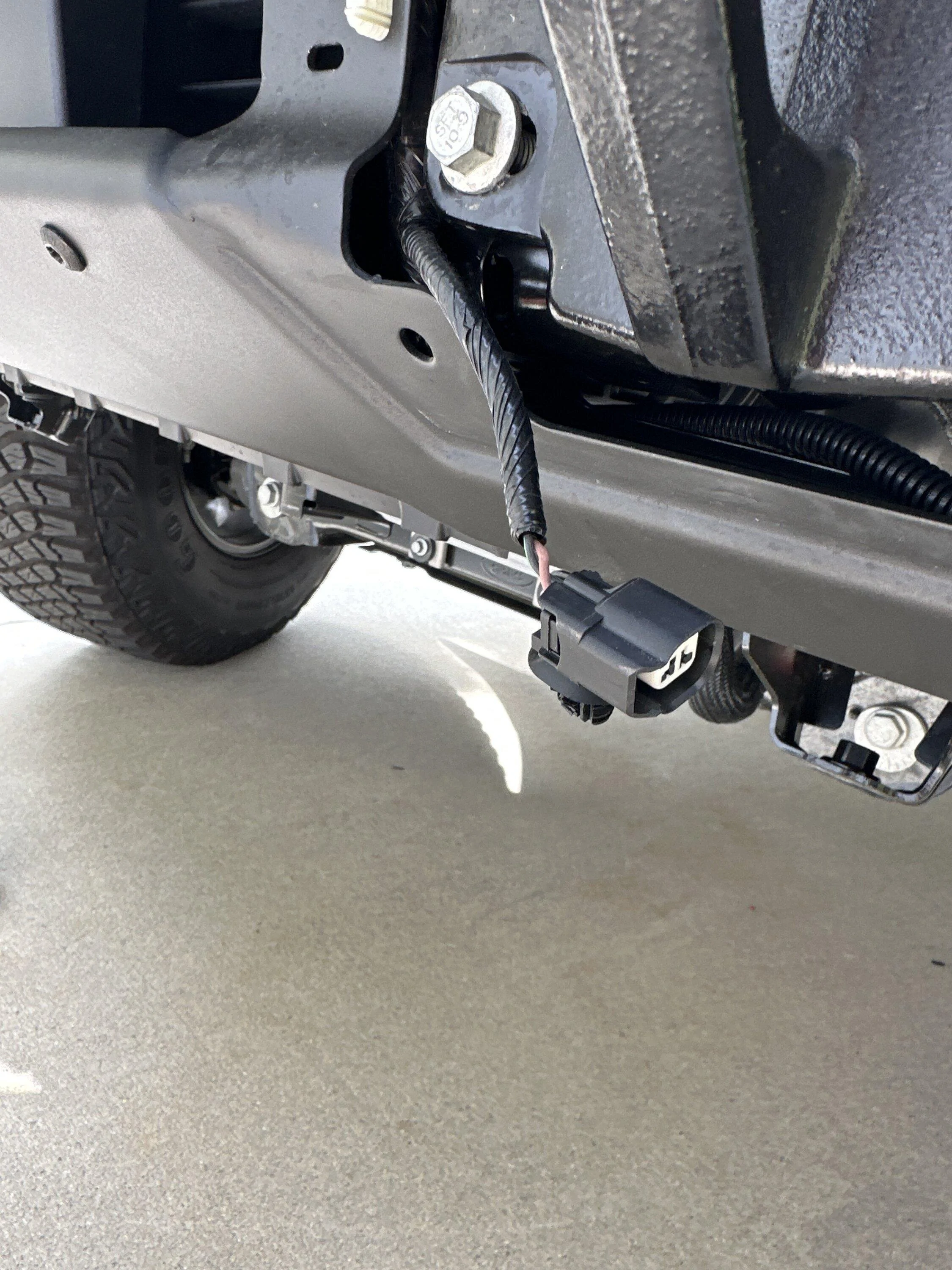

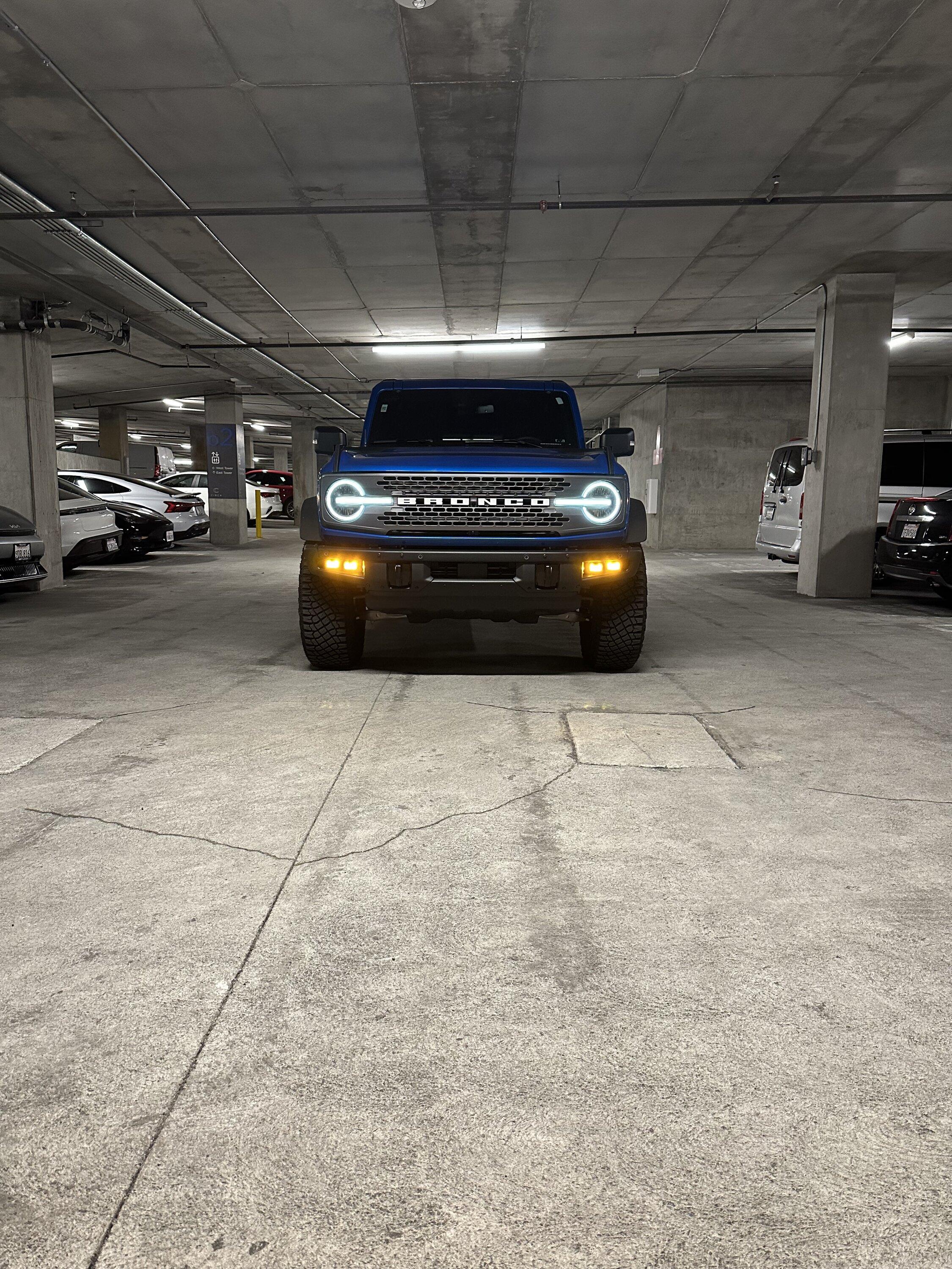

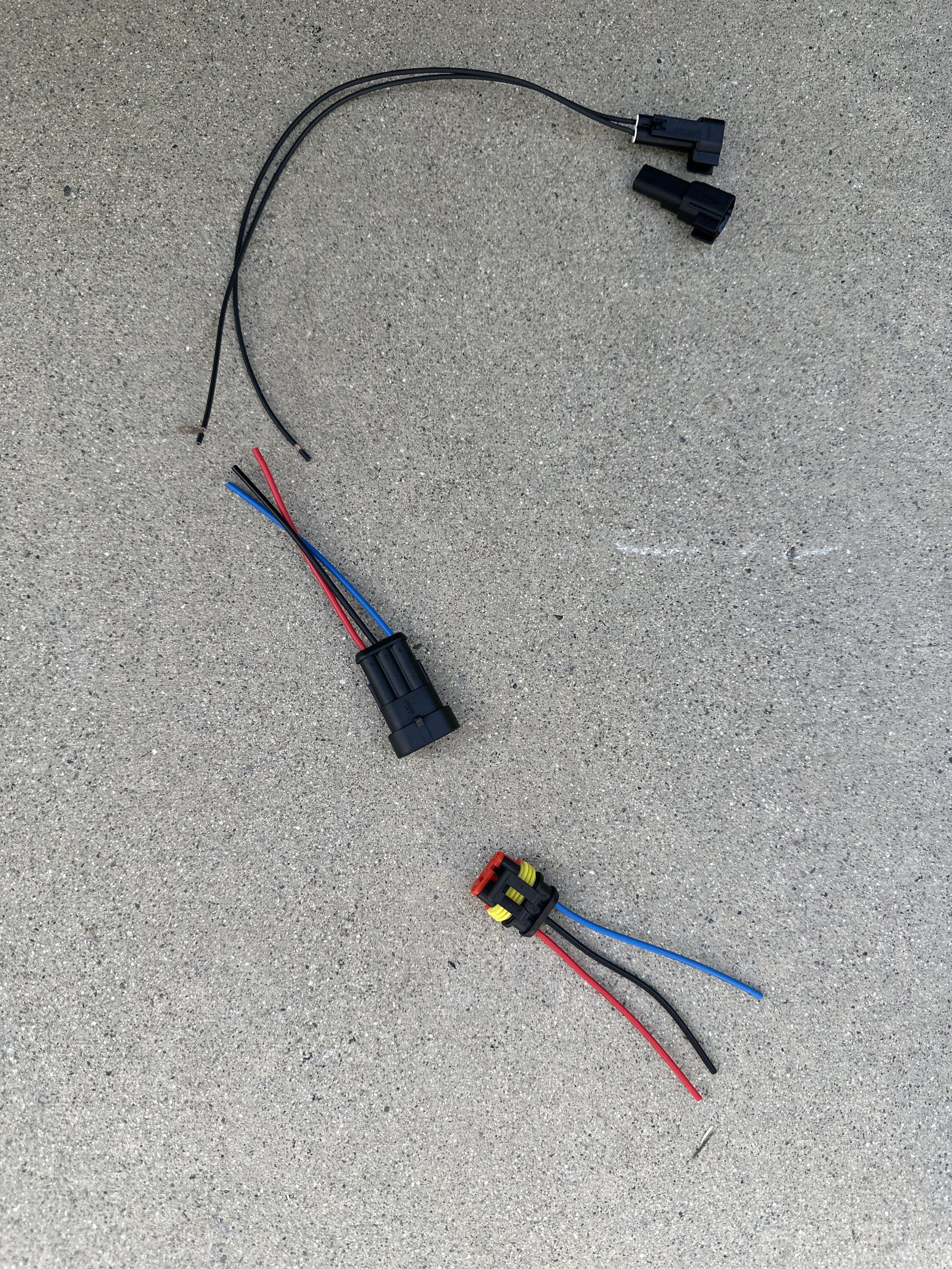

Looks like I found the factory fog light wire so I won’t need to splice in after all now I just need to create a harness to connect the mabbet, taking the wires for both white lights Dorman to factory molex.
Need to replace this female as it’s the wrong size with the factory fog female
Then make a dorman pigtail male. Then pull the white wires from the fog light dorman attach it to the female Dorman and all should work I believe
I actually just did this. Made the harness myself. I have the white light going to the factory switch and then I have the amber light going up to the aux 3 switch. Best of both worlds. Dont forget the updated switch with the fog light button and the forscan update to turn on the fog light option. Cheers.
You harness looks much cleaner than mine, I sent Amber to Aux 6, and white to factory fog switch, although I do have the front/rear fog switch, I will just reserve that for future use. I do think its great to have it setup this way, I enabled DRL and turn and it works well.

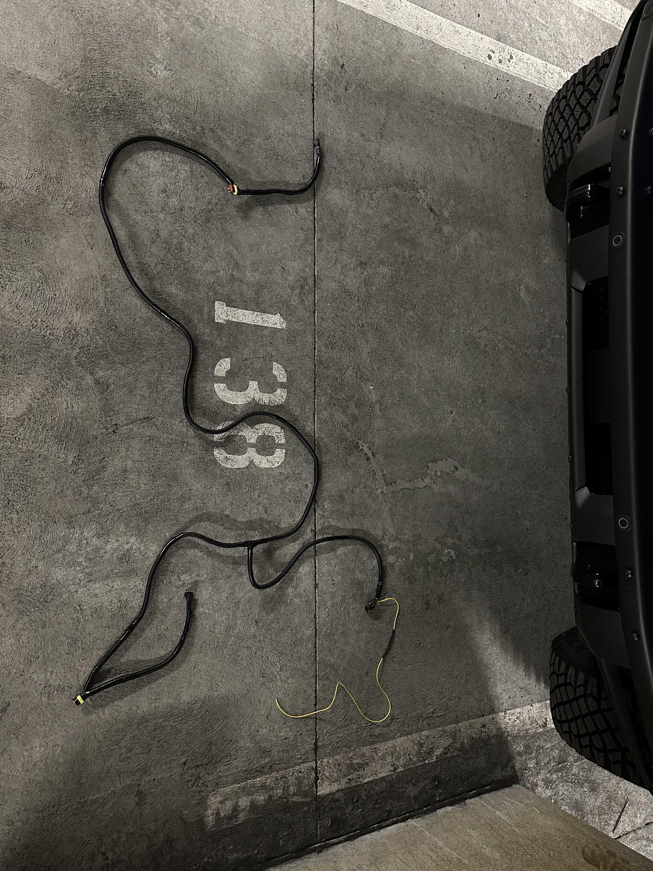

Well my ocd made me re-ziptie the wiring for the fog lights. I noticed the heat coming from the intercooler so I moved the main harness splitup section where C192 would be right behind driver headlight. Also got some good pics behind the wheel well for anyone who wants to see more.
Ford Bronco Factory Fog Light Switch 20230506_152332
Ford Bronco Factory Fog Light Switch 20230506_152257
Ford Bronco Factory Fog Light Switch 20230506_152305
