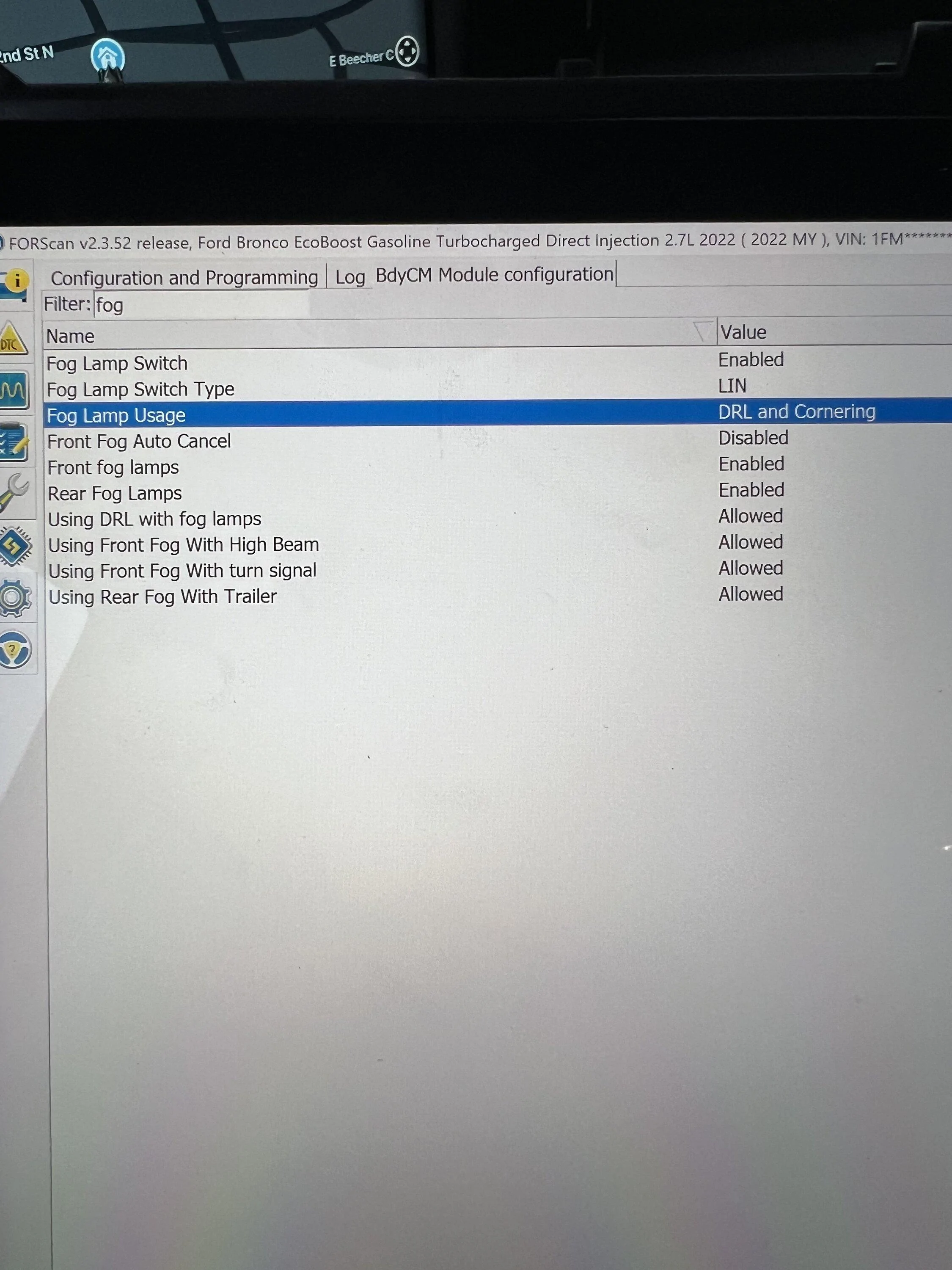

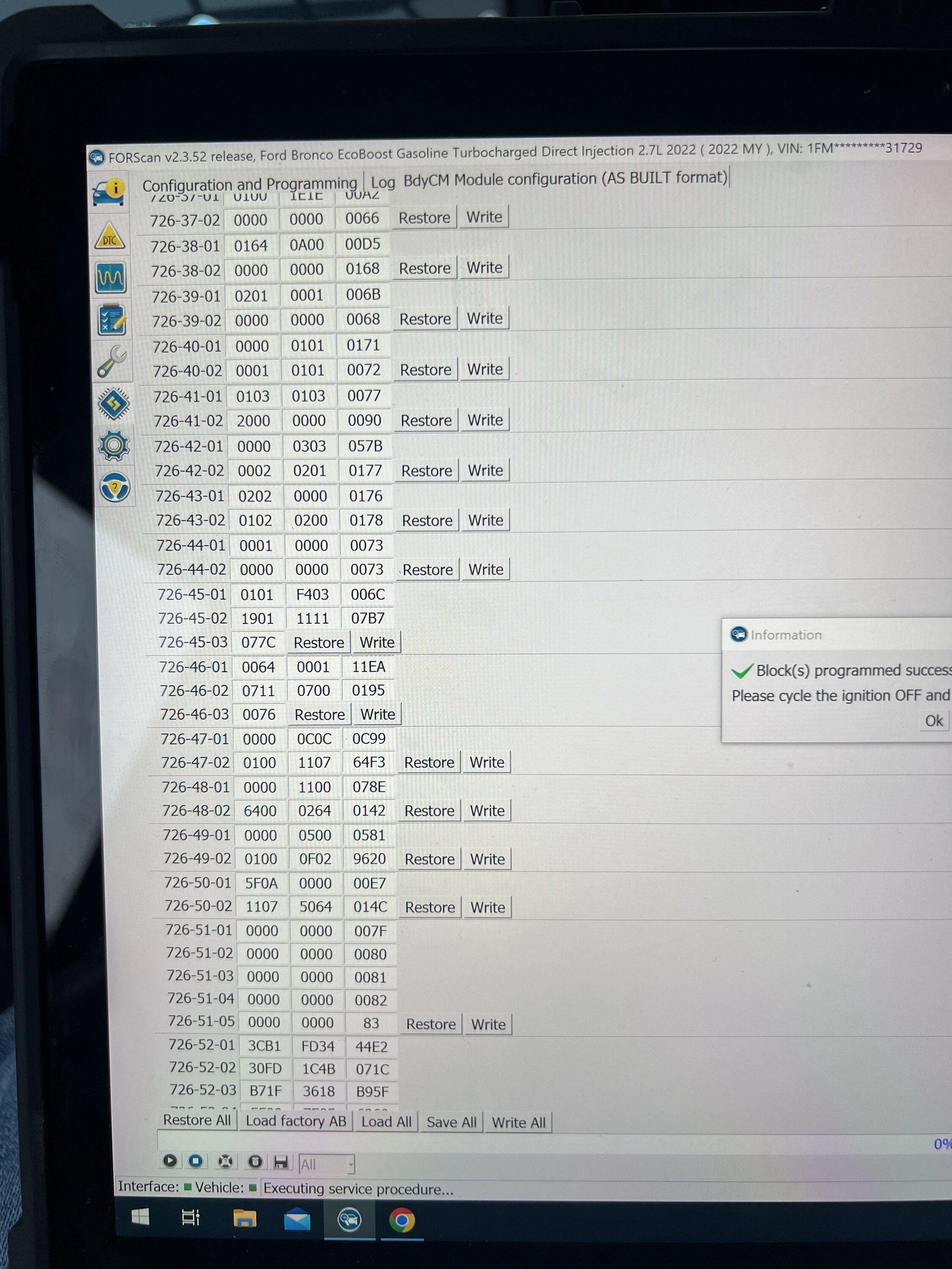

Finally getting around to adding some fogs with factory switch.
Enabled via Forscan
Mod made to BdyCm 726-42-01
Fog indicator on dash works…
No fog power. Any suggestions?
Thanks for any help.
Did you try "Fog Only" rather than "DRL and cornering"?

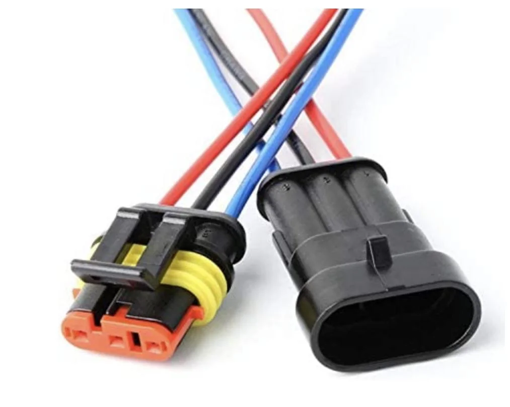

So I was able to find the harness and wires for the right/left front fogs in C203, but it is unclear to me how it would work with the fog light harness I have for the mabett raptor style lights.
Essentially the fog lights have two wires one for amber one for white. They go into a why connector, come out with 3 wires, one for ground, one for amber, and one for white, these are for both left and right fogs. The amber light wire I have sent to aux6 switch for now and confirm that works fine.
Now I am left with the white wire to run to the factory fog light switch. So this is one wire, if I run this over to C203, what connector would I be using? I bought these which have 3 wires, but I can’t understand how this going to work.

Would these work? I would just use the black wire on the female going to my white fog light wire, and on the male end spliced from c203 which wire would go to black and red? I don’t see how this would work.

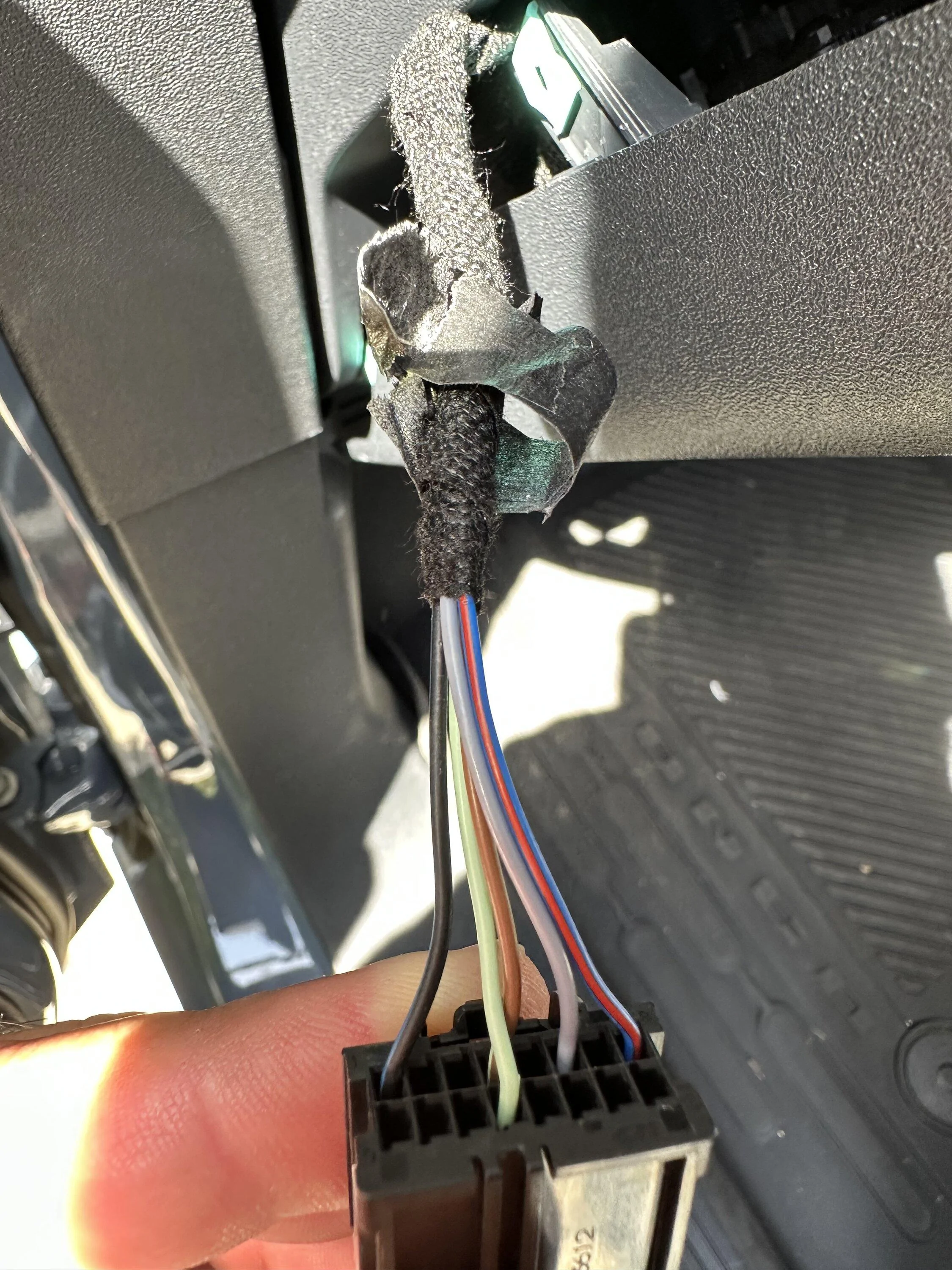

Looks like I found the factory fog light wire so I won’t need to splice in after all now I just need to create a harness to connect the mabbet, taking the wires for both white lights Dorman to factory molex.
Need to replace this female as it’s the wrong size with the factory fog female
Ford Bronco Factory Fog Light Switch imag
Then make a dorman pigtail male. Then pull the white wires from the fog light dorman attach it to the female Dorman and all should work I believe

You have the proximity sensors in the bumper? Sorry guess I should have asked that earlier, yeah, if you have the proximity sensors then you have the fog wires too, and it sounds like you have a good plan that should work.
