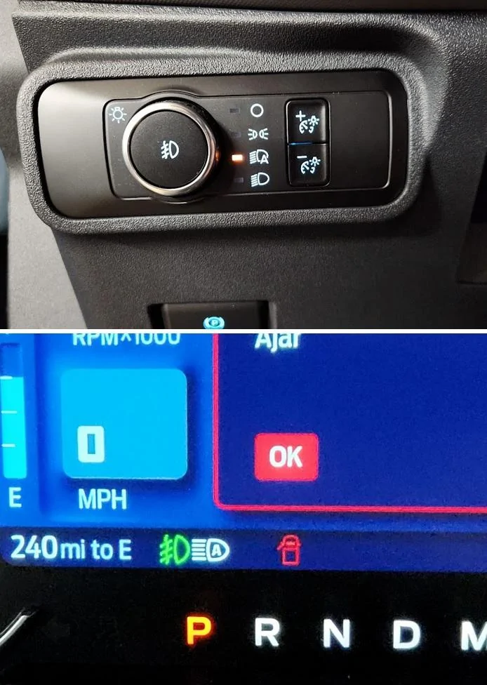

Installed my new Switch, it was so easy. Just pull the lower dash panel and pop out the old one. Plugged it in and popped back in place. Tested out the button and my dash showed the Fog Light Icon since I already made the Forscan changes! WOOHOO!
Now I just need to wire everything up and hook up my fog lights!
*FYI I got my switch from OEM Ford Parts - only took 7 days to get it to Cali.

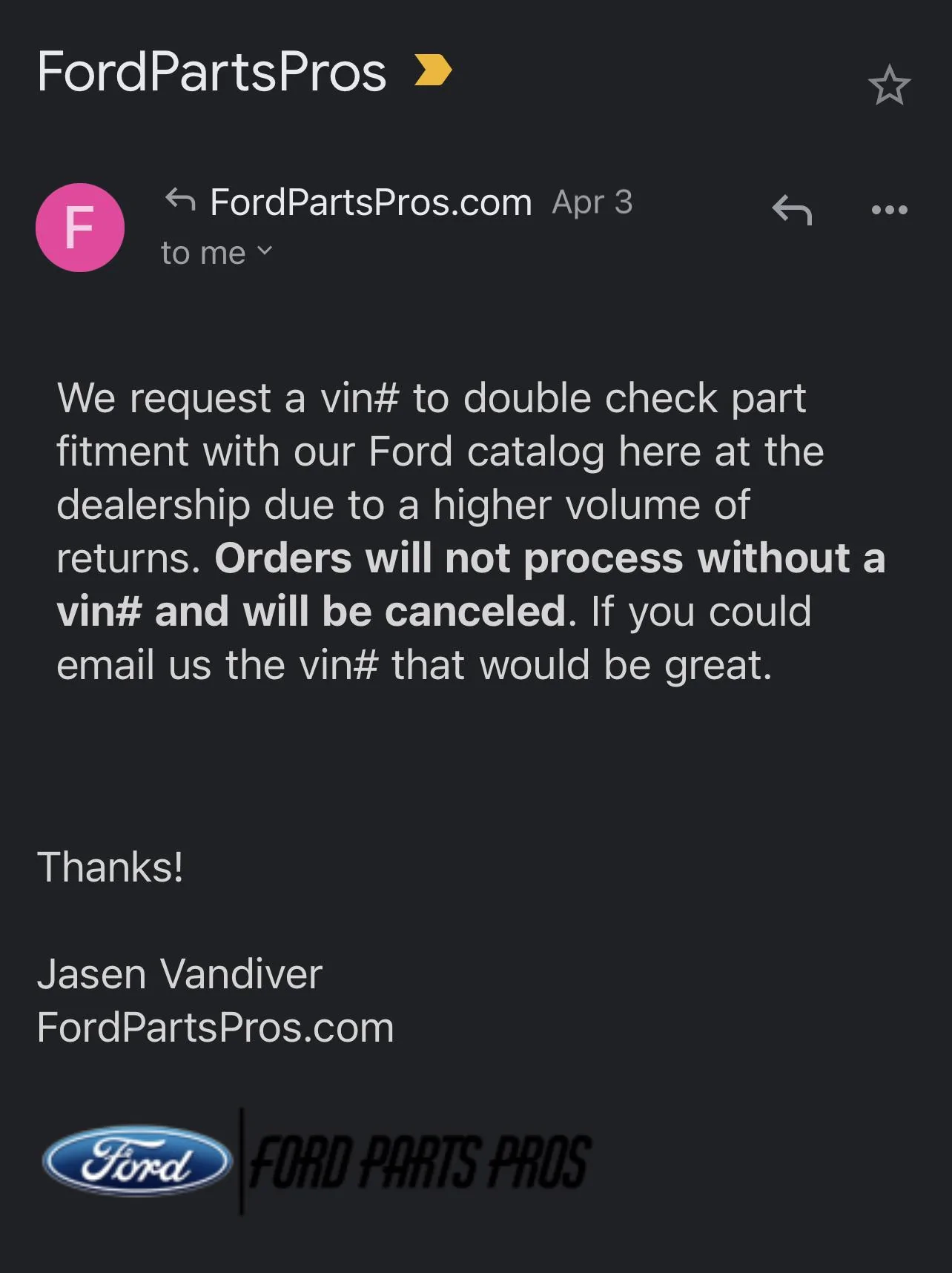

Can someone please advise where to order these from, the ford dealer I placed an order with cancelled it because they said its the wrong part number for me and are trying to tell me i need the HC switch…mofo I’m not trying to add front and rears!!! Just send me what I ordered idiots!!! Ugghhh
Check out OEM Ford Parts - here is the one I got with just Front Fog switch.
https://ford.oempartsonline.com/oem-parts/ford-switch-assembly-headlamps-m2dz11654ac

Yea they’re asking me to enter my VIN too, every site I’ve looked at has asked me to verify my VIN…like wtf just let me order what I wanna order. Did you have any issues ordering with them? I worry I’m going to run into the same thing with them, they’re gonna want my VIN and then cancel when they feel its the wrong part number for me.
No I didn't have to enter my VIN, thats weird though you should be able to buy it without the VIN. I think its just an Optional thing.

Yea when I ordered it there was a drop down box that gave you the option to enter your VIN or you could select to proceed without verifying fitment. I selected that and then the next day they sent me an email stating to send them my VIN or they’re going to cancel my order, like WTF. So I did and they cancelled it anyway, telling me I needed to order the -DZ one.
That's really weird, but is FORDPARTSPROS the same company/website that I sent you where I got mine from?
Also, my switch was shipped by "Sames Kingsville Ford" a dealer in TX. Maybe my order slipped through the radar when asking for the VIN.
They must have gotten a lot of returns after I bought mine and they changed it so you had to give the VIN for them verify its meant for your vehicle.

I haven’t ordered from the site you recommended yet, they said it was going to take 2-3 weeks to get here so i was like eek! The dealership just called me, I kinda lit into him pretty good and he said he’d send me the switch as long as I understand I cant return it, because his “management” has advised them that if the part doesn’t come up in the Ford parts catalog for my VIN they have to cancel it.
