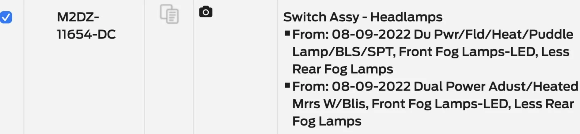

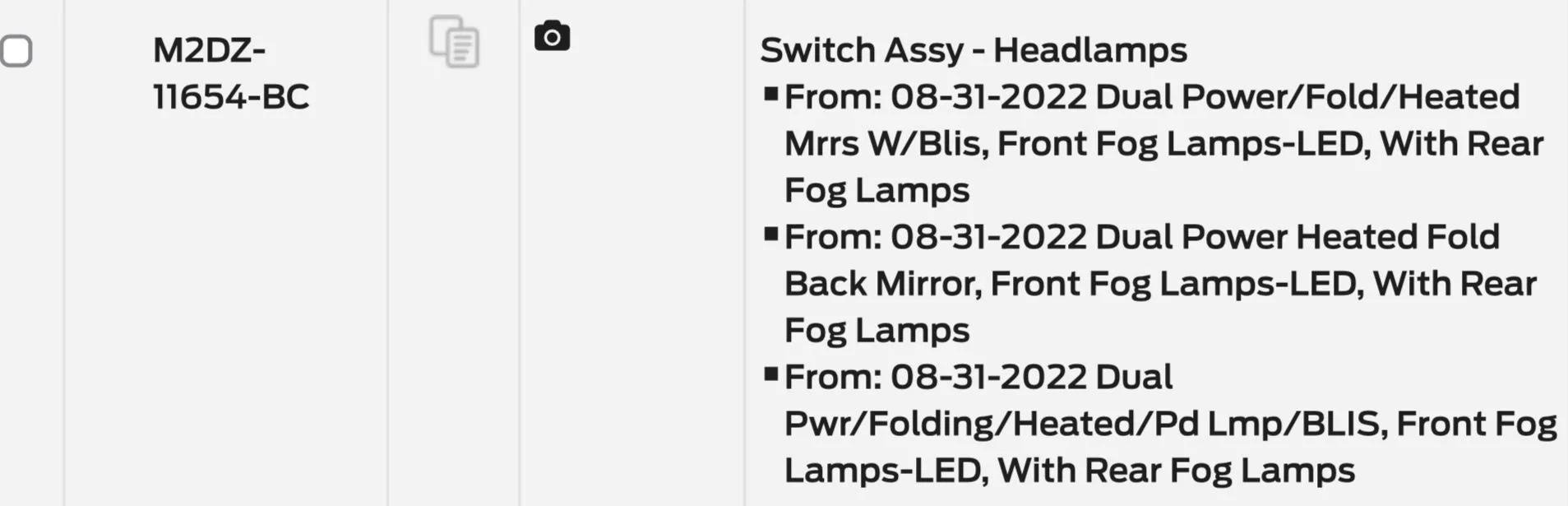

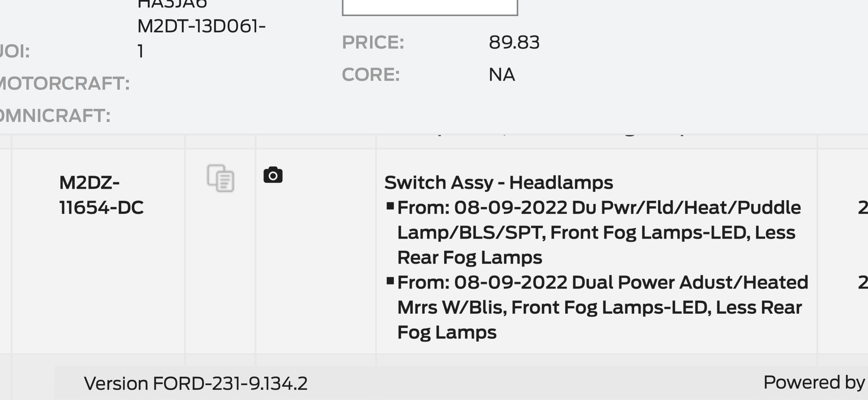

Like I said, that’s not correct. The description from all these places online are saying “without blindspot” which is false.
Here is what it shows in the actual Ford parts catalog. As you can see, they are both for vehicles WITH blindspot. But you are correct about the front fogs only with DC and both front and rear fogs with BC. I didn’t look at the picture in the original post correctly.
Yes sorry!I meant without PUDDLE LIGHT. Not blind spot. Thanks for clarifying. These have blind spot but not puddle light.

Read through a few pages, I'm confused on which switch to get. I have Badlands lux. So Puddle lights, BLISS, etc. People have said -DC switch but all websites say without blind spot. Is that actually the right switch?
Also how has there not been a simplified how to with all the switches, harnesses etc. Its crazy trying to look through 50+ pages lol
Are you looking for front fog only or front and rear?
Not exactly
DC switch is Lux package with front fogs, so it has everything except rear fogs.
BC is front and rear fogs, but does not have spot lamps (the 2 switches on the left side)

Oh man. I’m just screwing it all up now for everyone. BC is what I need though I know that.

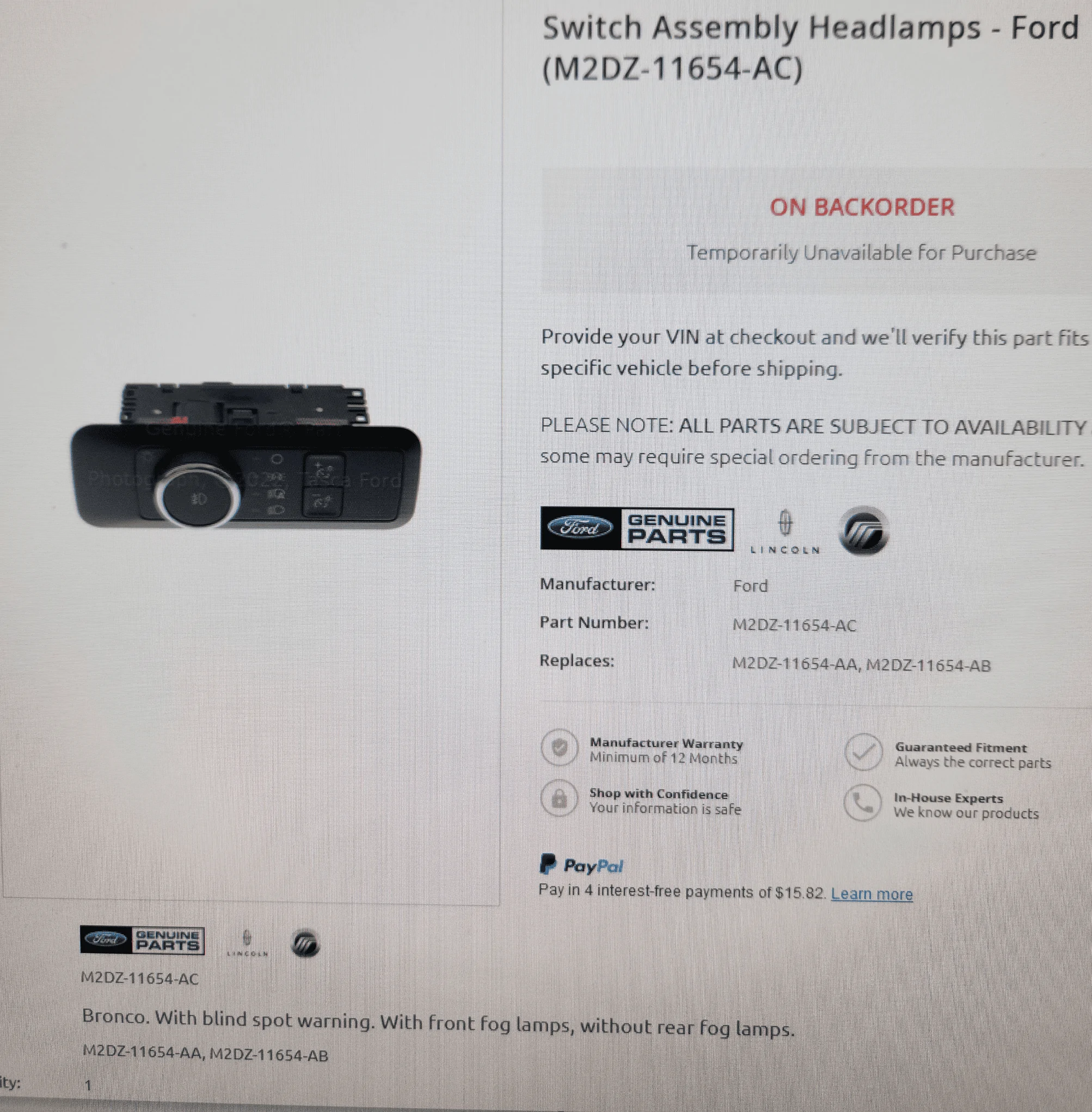

Here is the switch I got, being delivered Monday!😃
M2DZ-11654-AC
*blind spot, with front fogs -nothing else
