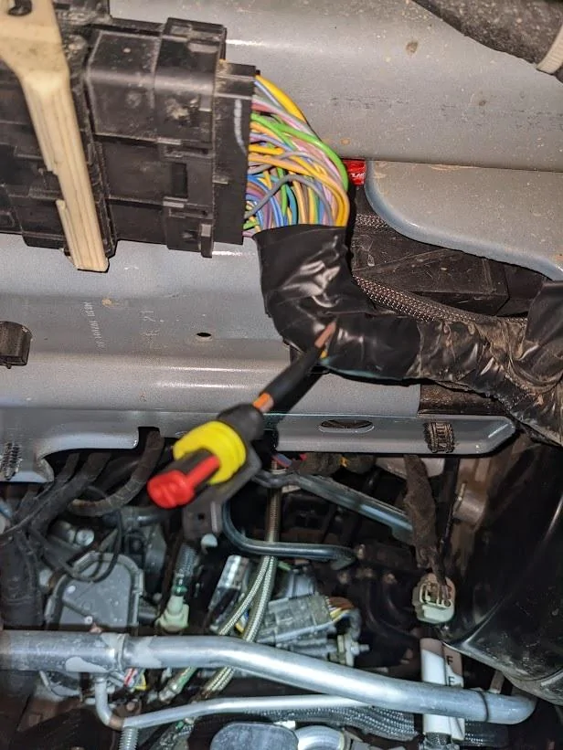

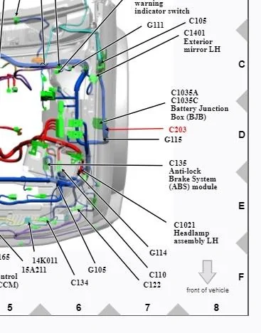

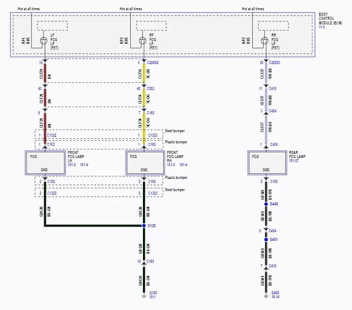

If your bronco didn't have fogs or sensors originally, you're going to have to go back to C203, Wich is a large harness connector inside the driver's fenderwell... Take the liner out of the driver's side, and look up on the frame horn that runs immediately under the fusebox/battery area... the connector is the large one in this photo;

The two wire connector you see is the one I added for mine, you need to splice the wires going to pin 48 and 43 of C203, 48 is a yellow/orange wire to the + right light, and 43 is brown, to the left light. you just need to ground the other wires from the fog lights.

There are no fuses, Power comes directly from the BdyCM (Body Control Module) Which is coincidentally, what you have to change in Forscan as well, if you go to BdyCM in Forscan, There are several options for it, I Used "Fog Only" for it to work the way one would normally expect..

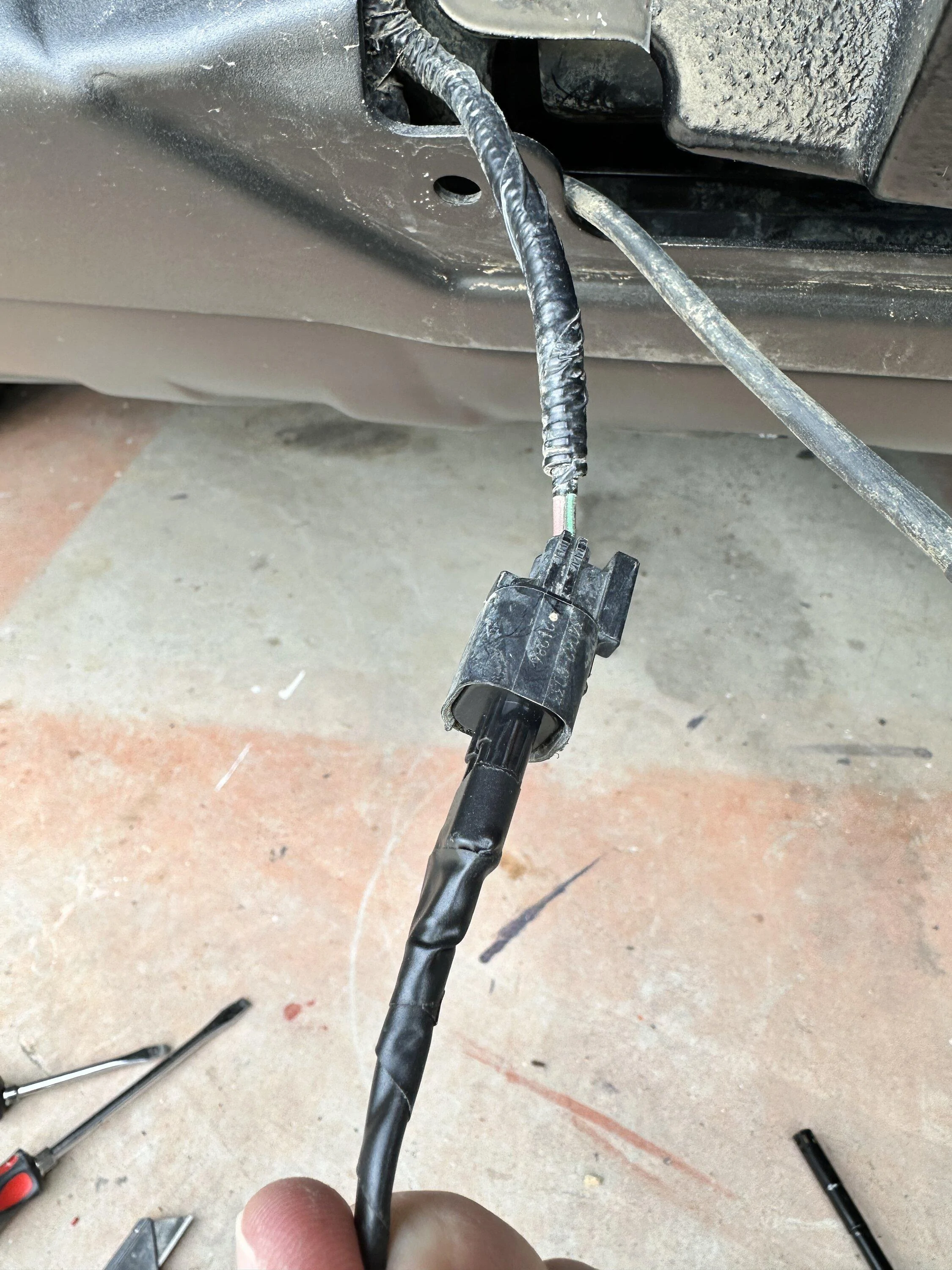

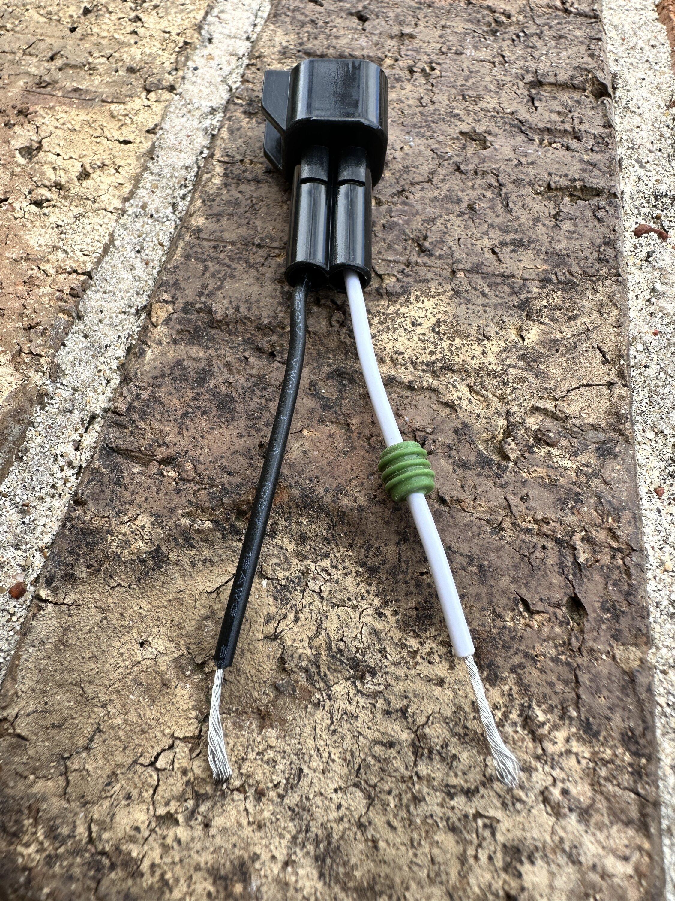

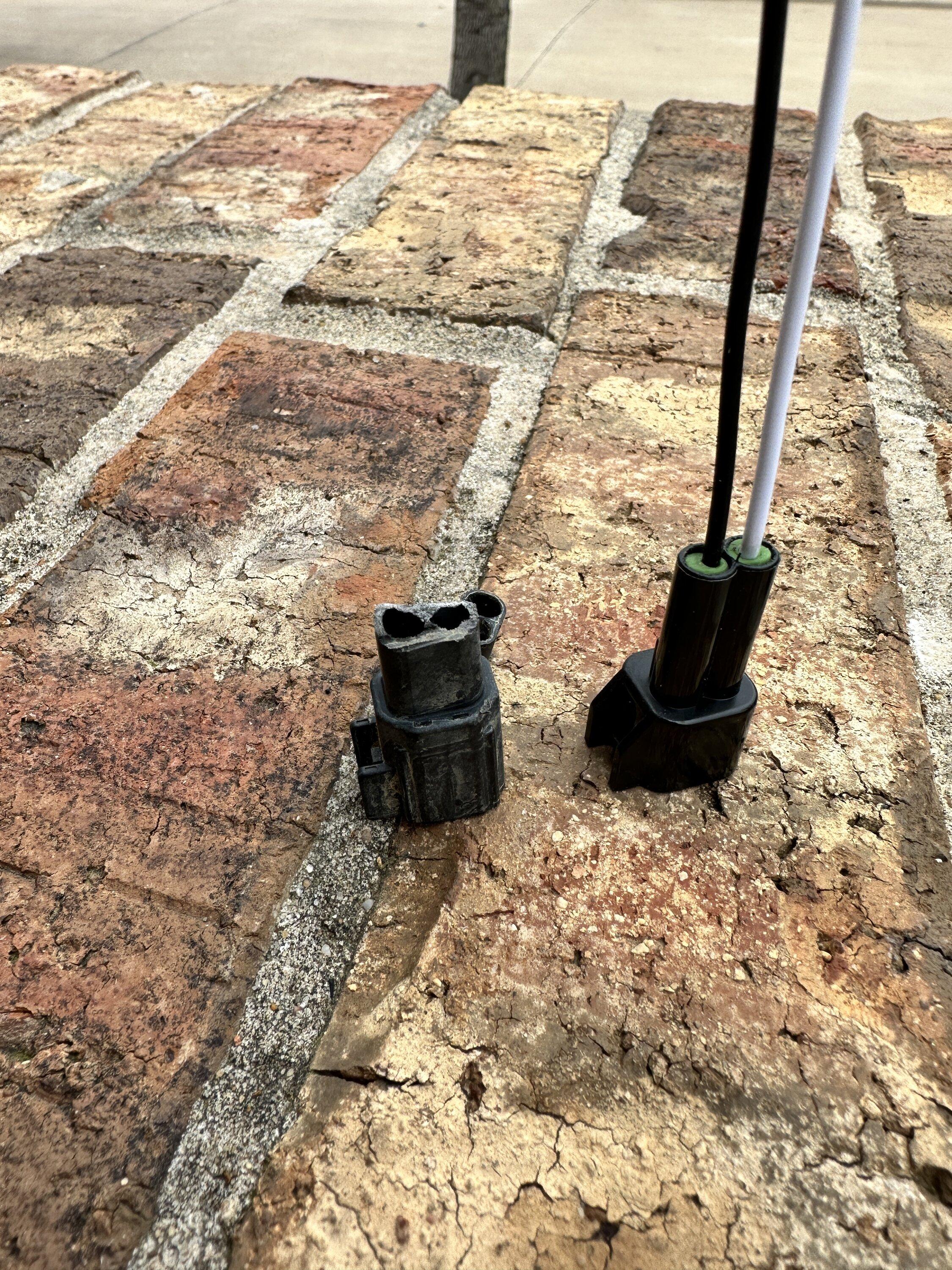

somewhere near the beginning of this thread, someone suggested speaker connectors from Amazon might work. I ordered them dirt cheap and considered filling them with caulk for weatherproofing. Instead, I cut the weatherproof plugs that were in the bumper (protecting the wire harness female plugs) and took the gaskets out, made a hole in the center and slid the wires through. They are perfectly sealed and the speaker connectors are an exact fit. Made all of my FORScan changes and my Rigid lights are working great. I had them on an upfitter switch but wanted to add the cornering function. The Amazon connectors are a great way to go especially if your lights are bare wire with no connectors.
4 Pack Speaker Harness Replacement for Ford Lincoln Chevy GMC Mercury Mazda Models Front Rear Door Speaker Wiring Harness Adapter 72-5600 - Door Speaker Replacement https://a.co/d/8GxJZsk

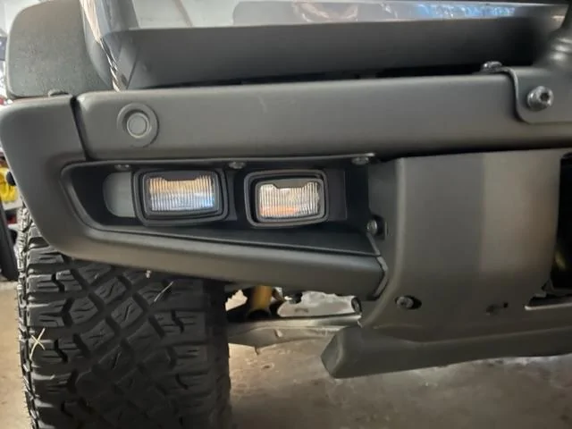

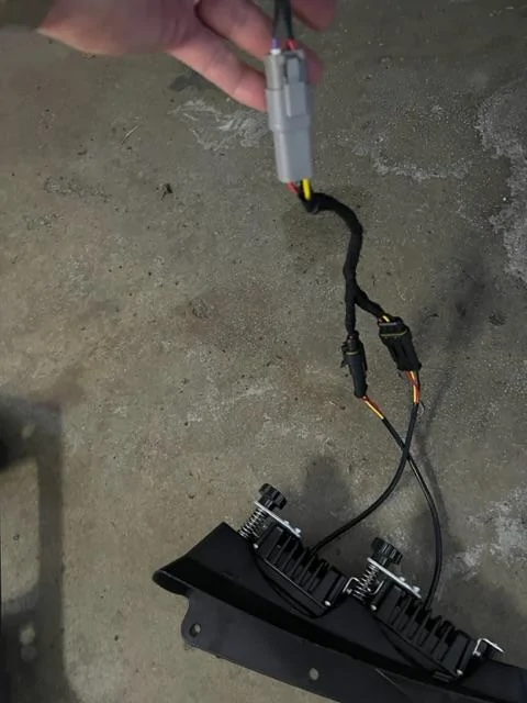

Thanks to all that have contributed to this thread, added my dogs yesterday and everything works great!
