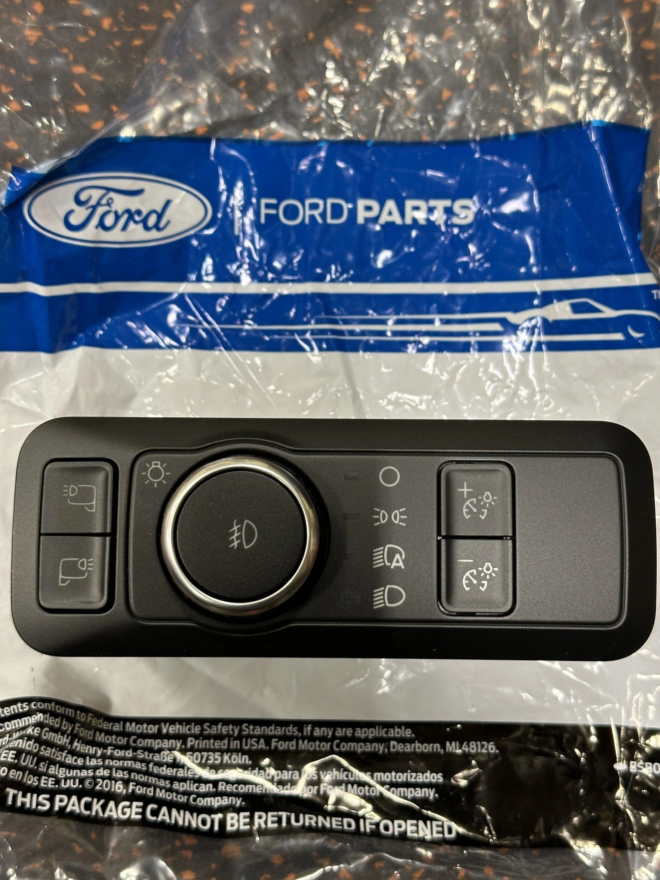

UPDATE SOLD———I have a brand new switch assembly for sale with just the front fog lights. I bought it last year but never installed bc I don't have a PC (all Apple computers) to do the Forscan settings so I installed fog lights hooked up to the auxiliary switches. Message me if interested
$65 shipped
Ford Bronco Factory Fog Light Switch IMG_6452

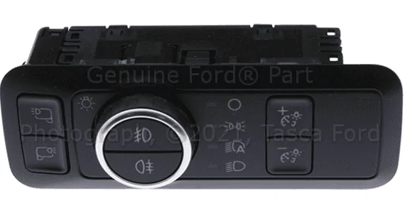

Out of all of these numbers I am still trying to find which part number this is…waiting on my Wildtrak with Mod bumper and LUX. I am sure it is here somewhere can anyone tell me which part this is?
when looking at the various part numbers found M2DZ-11654-DC. I think that is it but it says “without blind spot warning”. Is that something I need to worry about on mine if I order this one?
M2DZ-11654-CC is the correct one for front and rear fogs, heated WITH blindspot, puddle lamps, and spot lights. It’s the only switch that comes with EVERY option
Whatever place you are looking that says without Blindspot, is an incorrect description.

FYI... DC is front fog and no blind spot. BC is front AND rear fog and no blind spot.
https://www.fordpartsdistributor.co...-headlamps-m2dz11654bc?c=cT1NMkRaLTExNjU0LUJB
Like I said, that’s not correct. The description from all these places online are saying “without blindspot” which is false.
Here is what it shows in the actual Ford parts catalog. As you can see, they are both for vehicles WITH blindspot. But you are correct about the front fogs only with DC and both front and rear fogs with BC. I didn’t look at the picture in the original post correctly.
