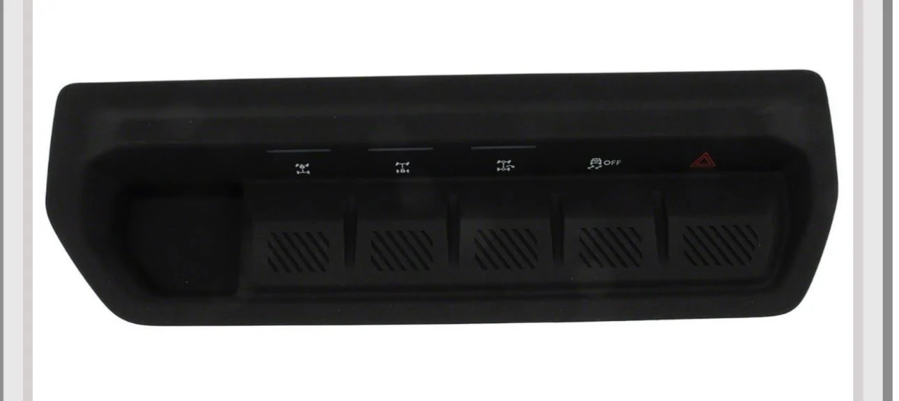

I'm still not sure. I have not ordered the switch yet hoping someone would show a picture and part number but no luck yet.
M2DZ-13D730-GA is the correct one for front and rear lockers and trail turn.

Did you get this new switch module to add lockers to your beast? If so, did you also add the cable harness MB3Z2C011BA to the rear axle, then do some forscan changes?

Hey @Ducati1098, can you see about my initial question, a rear locker, front locker, TCS, & hazard 4 button Hero switch. I want to see if I can get my front locker working with the Hero Switch again. I might just get it working. I think I gave up too early last time.

M2DZ-13D730-HA is what you need.
The parts catalog is incorrect and doesn’t even list -HA which is why the previous information and part was incorrect.

Awesome, thank you! Will get it ordered up!

Nevermind, that’s wrong also, let me keep looking

Anyone who has a Base, BB, or BD with Sasquatch package and manual transmission, is your hero switch front locker, rear locker, TCS, and hazard? I just bought the hero switch and used a Big Bend with Sasquatch package, manual and the switch also has the swaybar disconnect.
I would like to just have the 4 buttons. Does it exist?

I’ll have to see if I can contact Ford about it. The listing is definitely wrong in the catalog, but I can’t find the correct number looking in all the other usual places either.

You should take a closer look at the GOAT modes. That's why they exist, as presets for different types of driving.
I think, if you follow the thread, what Orion is trying to do is add this so it does work with the GOAT modes, since his didn’t come with the front locker from the factory.
Normally if you add a locker after the fact it’s entirely manually activated and the Bronco computer doesn’t know it exists to do anything with in the GOAT modes
