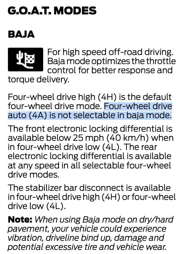

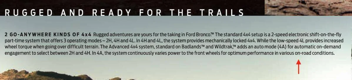

Ford Bronco "Advanced" Sasquatch package - what does it mean? 1744090077781-a
Ford Bronco "Advanced" Sasquatch package - what does it mean? 1744090204850-k
Ford Bronco "Advanced" Sasquatch package - what does it mean? 1744090230717-b6

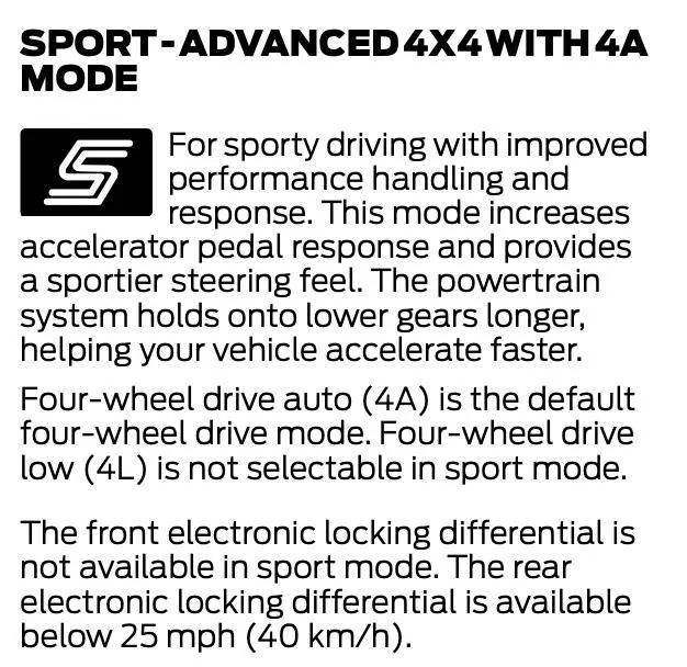

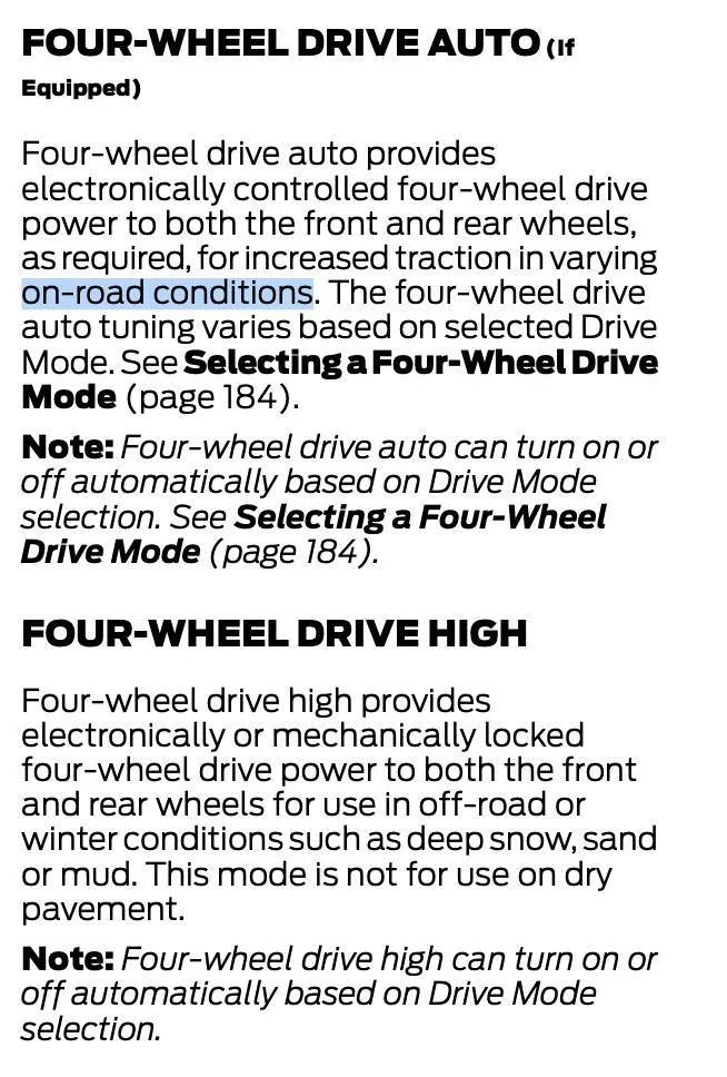

It's stated quite clearly in multiple points of documentation that 4A is for on-road use. It's locked out of Baja mode, and the default option for Sport mode.

I used Sport mode & 4A for a rally across West Virginia last month & I was very impressed with it.
We were primarily on back roads or unimproved forest roads & some pure off road trails. I kept it in sport mode all day (1 exception when I needed 4 Low) and just used 4H as needed in muddy areas. But the response & pull up out of switchbacks on gravel/dirt roads was awesome. As soon as you had the front end pointed right, you could plant the throttle & it just hooked up without any slipping.

Im not disagreeing that its for on road use at all. It is. My point is that is distinctly different than 4H. It also won’t automatically change to from 4A to 4H when the system determines it needs to. It only does this when the driver selects a goat mode as noted in the docs you posted.

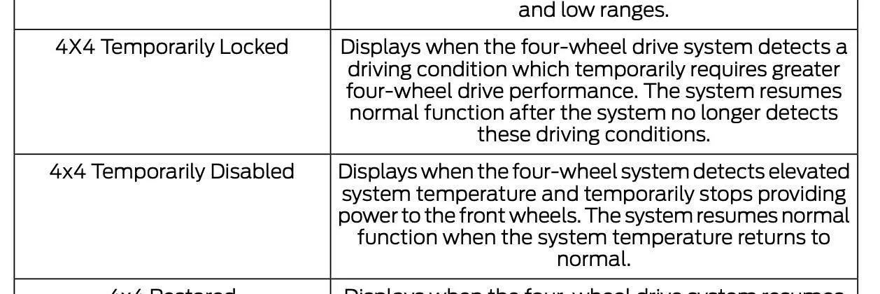

You're saying it will only do the auto-switch if you access 4A through a GOAT mode? Or that it won't do it at all? Because mine absolutely has done it before, I just can't remember how I got there.
EDIT: These are the exact message I saw. I had come off the main road in Anza Borrego in Normal / 4A, air down and just got after it. I wasn't too far into the wash when this came up. It stayed in 4H for quite some time, then back to 4A on its own. I then just went into Baja mode anyway.
