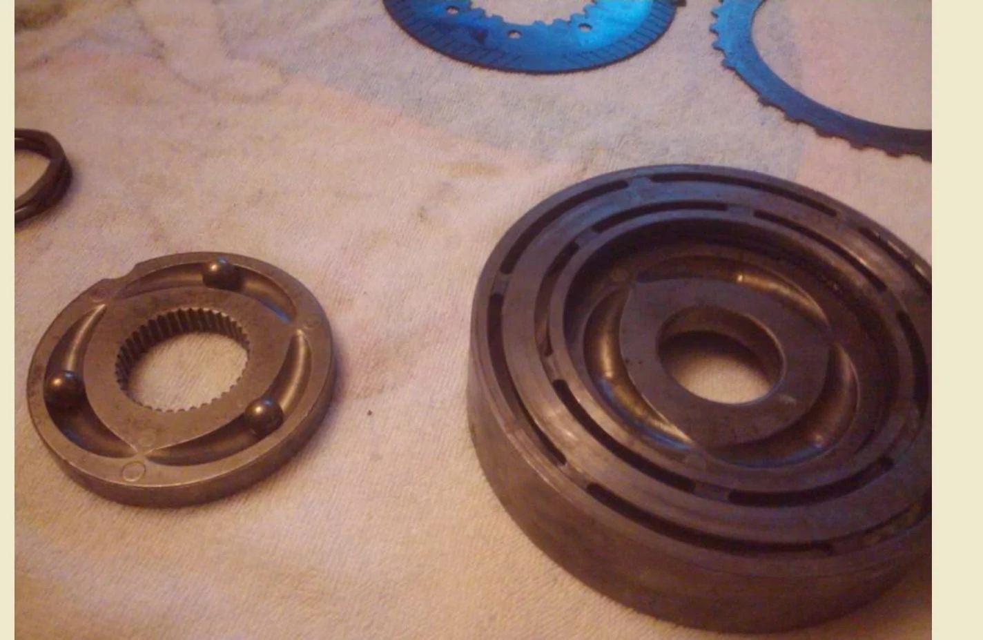

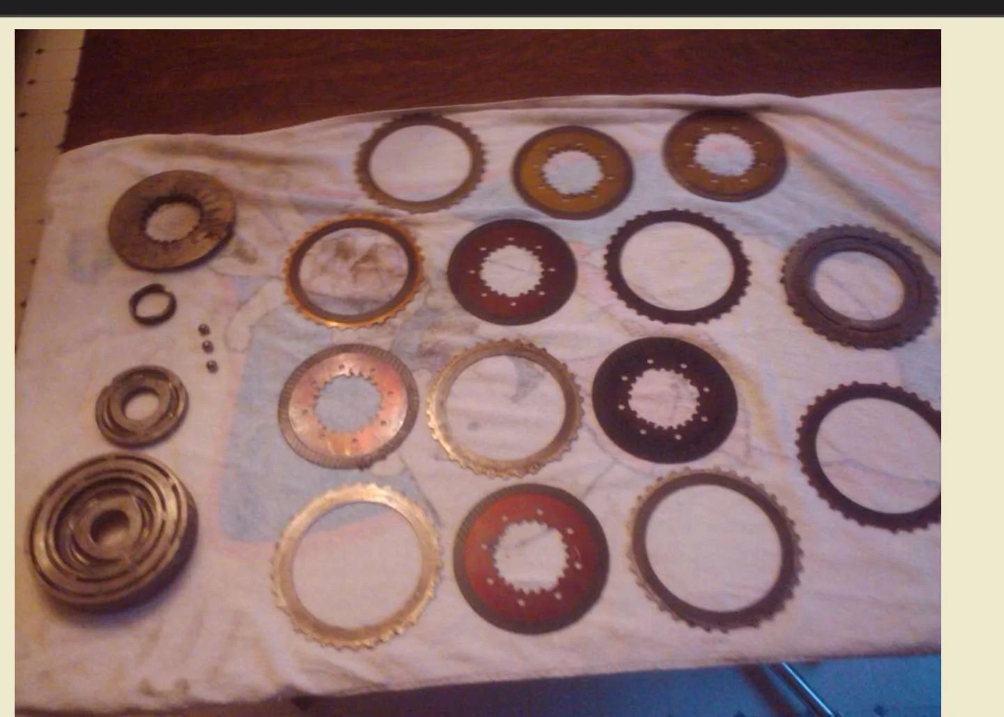

The system has clutch plates, not a diff...
