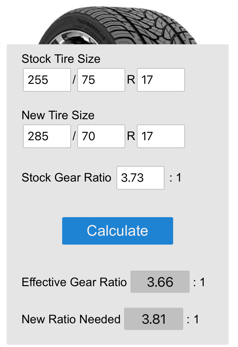

My first guess is rear gearing is matched with 30" with a slim margin.
good info. Looks like base comes with 3.73 gearing, as does the BB and OBX. Thinking BB and OBX on 32.1” stock tires vs. base on 32.7” tires with the same 3.73 gearing would be fairly similar. I definitely won’t go any taller than 33s with the 3.73 gearing, but it should be acceptable for daily driving and light(ish) off-road use. Figure it’s not worth regearing to 3.91 (if it’s even available) for the minimal difference. If I ever do regear, it’ll be to 4.27, but that’s not in the cards for a while. That being said, the Base definitely has less pep that it did on 30s, and the gear ratio certainly sounds like it’s contributing to that.
stock BB vs Base on 32.7s gearing compare
