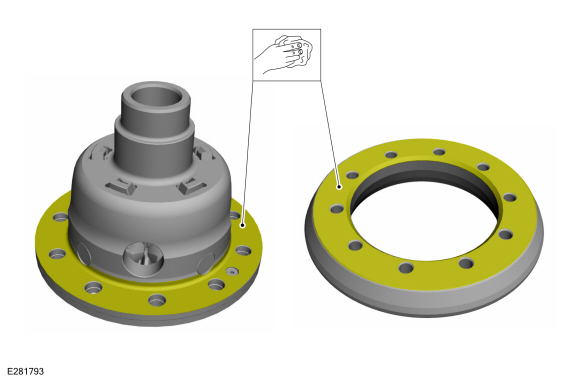

  1. NOTICE: The differential flange and ring gear flange must be free of any old retaining compound material. Make sure both surfaces are clean and free of oil, dust and debris. Failure to clean the surfaces can result in ring gear runout concerns.
    NOTE:
    Use solvent and Scotch-Brite® pads to remove.
    Clean all traces of the old retaining compound material from the differential flange and ring gear flange.
