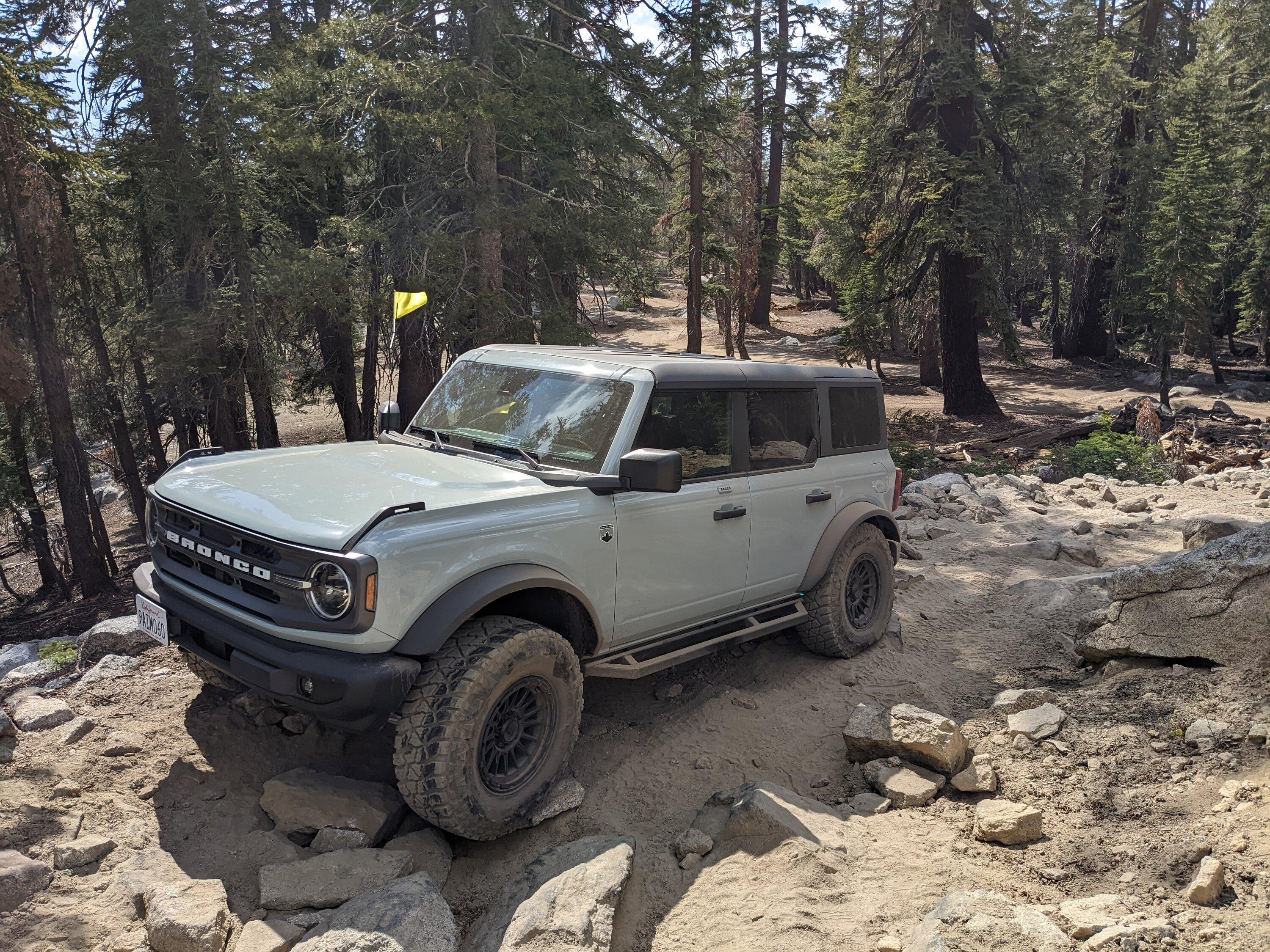

Not having lockers means having to think more about your line of attack. Some of the most fun vehicles I have ever wheeled didn't have lockers. Rocking 35s open/open nothing a little wheel spin couldn't fix.
Ford Bronco Regearing for 35's PXL_20220625_231736724
