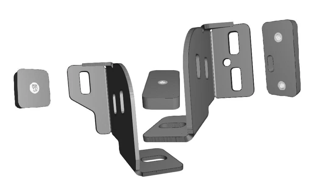

So they’re like a threaded backing plate. Nice!
Are your welding the spacer on the brackets to protect the crumple ridges?
Anything that bolts to the factory horns should bold up with the plates. I wanted to do away with futzing around with nuts, so there's three 1/2" nut plates.
It is designed to be 100% bolt on, but can be welded as well if desired. The only DIY part will probably be painting, I'm leaning towards providing them in raw steel.
The brackets themselves are 1/4", which is still a lot of beef, but the nut plates are 1/2".

The CAD work is done and I'm super stoked, the TrickPlates are going to be bombproof. If I submit the files now there's a chance the prototype shows up before I leave for Moab but I don't want them sitting around a week if they miss me.
The question is before I can commit to a batch, what is the ultimate reinforcement kit worth to you? As it stands now $250 a set is a possibility - raw material costs alone are killing me.
Dusty brought up a valid point about the threaded plate so I might have to revisit that. But I want super tight clearances so there's no deformation.
Yes, the crumple standoffs will be welded. Futzing with washers made that a priority right away.
Love that plate that wraps around the bottom of the frame. I’ve been thinking about welding something similar onto the LOD brackets when mine come in.
I still haven’t got the bumper off for various reasons but now I’m probably going to wait for the brackets to get here so I only have to do it once. I will get everyone pictures and measurements when I do.

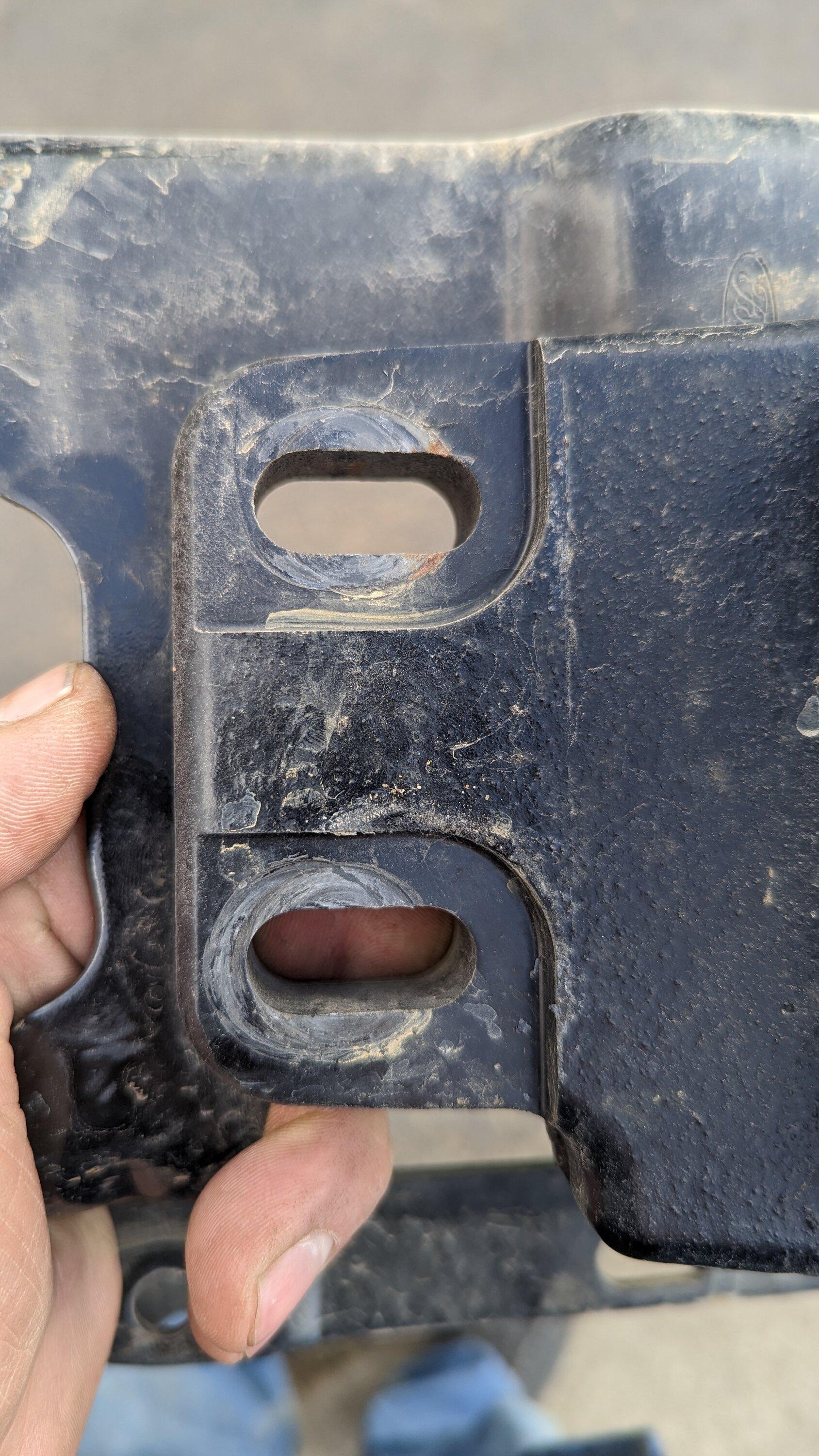

This is the surface the mount ears sit on, without the spacers it's not flat and solid.
Several more pages from here to the end but wanted to say thanks and kudos @Tricky Dick for this post (and the one prior showing the spacers).
My first iteration/install of my mount, I missed them as well.
I had everything on and tight, but it just didn't look right to me.
I didn't like the way the mount sat against the recovery hook plates.
Then (uncharacteristic of us guys) I consulted the directions again, took a look at the hardware and found the mistake.
Unbolting of everything again, but because stubborn is gonna stubborn, I fought to get them in position without a total removal of the bumper or mount, just really loose bolts.
Glad you found the mishap, but in the end a little extra stiffness and support on those horn ends and mount are going to net some strength.
And yes, one of the greatest threads in a while on here.
