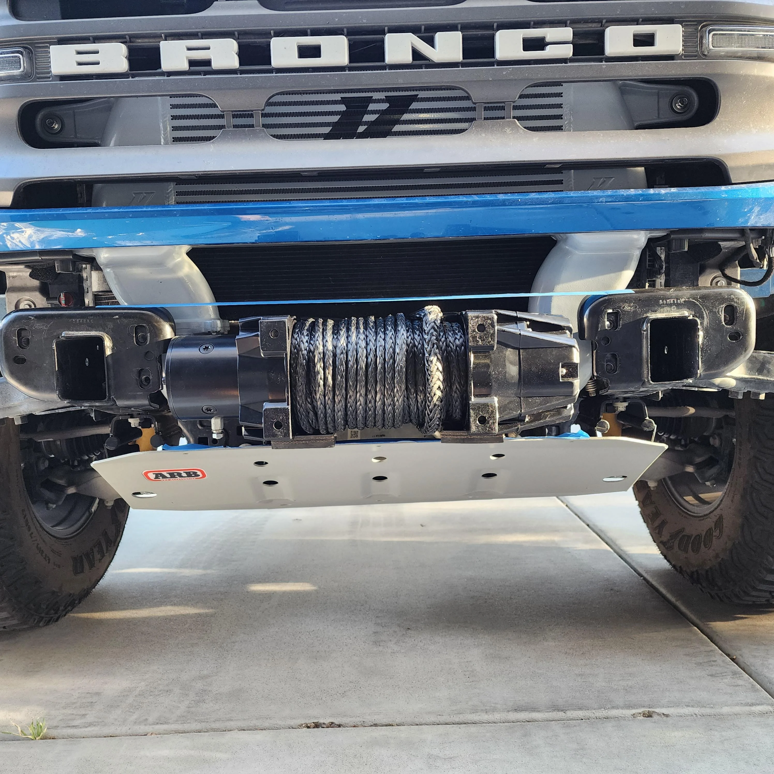

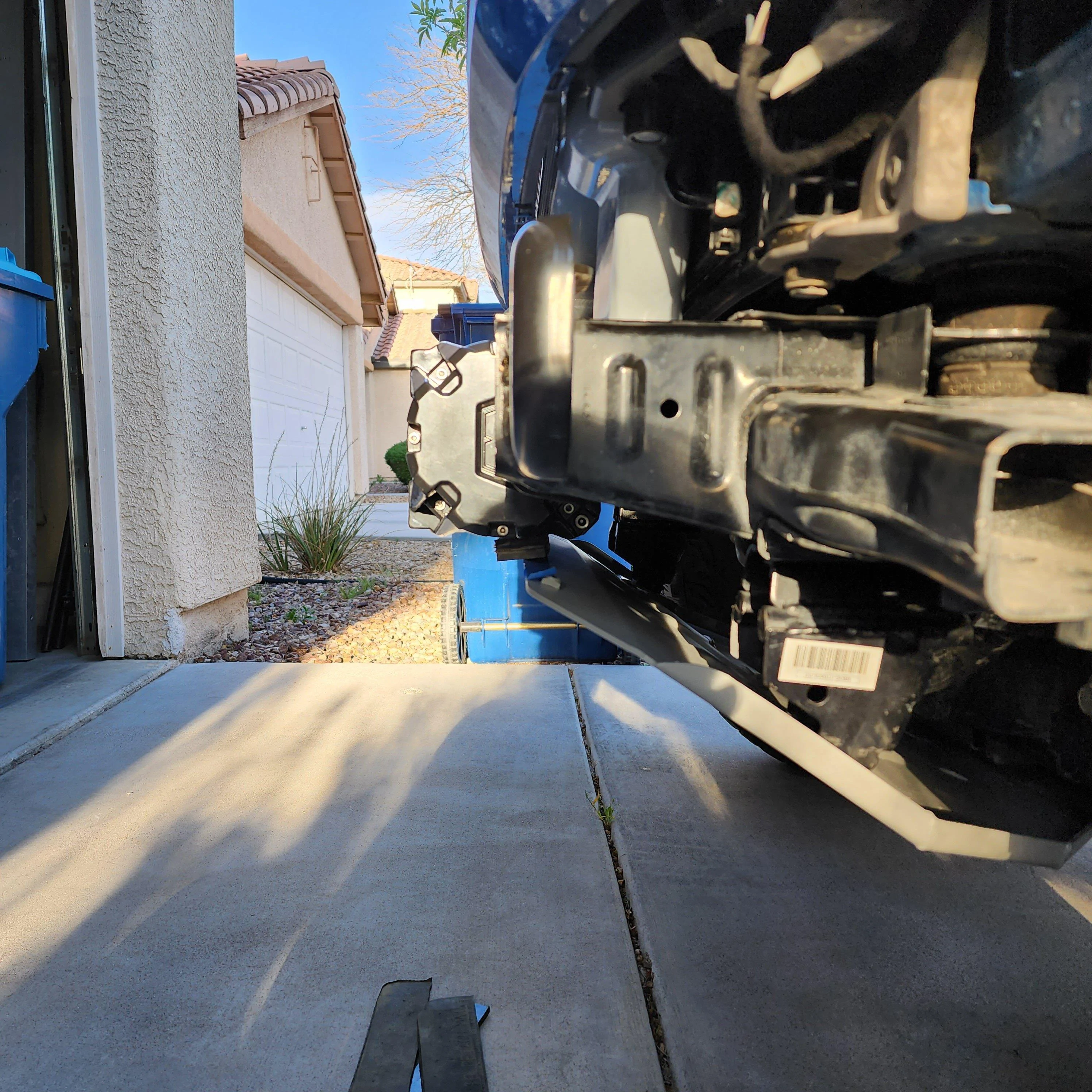

Working on my own contributions, with this download of what else should I gussy up before I start yankin
Ford Bronco Damage while using winch on improperly installed Rough Country High Mount 20230416_180843
Ford Bronco Damage while using winch on improperly installed Rough Country High Mount 20230416_180957
