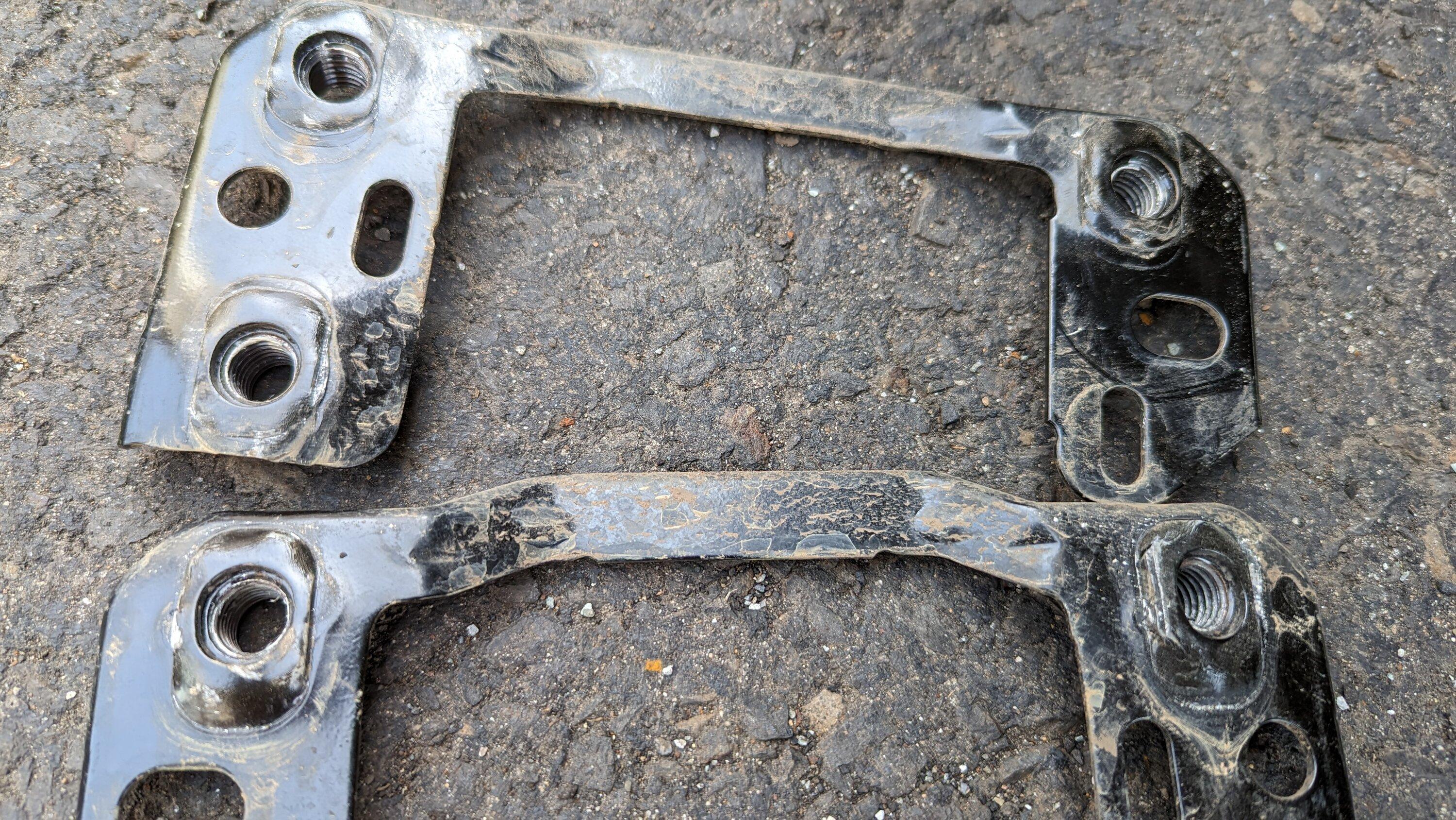

The beating worked pretty well, got it to within a degree. To be perfect I need to pull the bottom out a bit but not sure how that's going to work.
These nut plates went through hell. A couple more pulls and I think they would have ripped through, one already started ripping.
Nice work! (y)

I just used a 18" pipe wrench on the bottom and nearly bent it too far, took almost no effort. All squared up now and waiting for the LOD plates.
I don’t understand how ford expects us to use the recovery points with these mounting plates being so pliable. And they don’t sell replacements, right?
GreyZ
Sep 16, 2021
524
1,166
Gulf South Louisiana
Turbo 350z, Bronco Badlands, Xterra
Can you grab a coke can and rip the top off by hand?
No, but you could crush one hand.
This is the same principle used in designing the frame horns. They need to crush in compression enough to make the vehicle safe in an accident, but also be strong enough to pull straight from the factory recovery hook. (Which they are).
Even Ford adds additional structure when using a winch due to the possible risk of deforming these frame horns that are designed to function as they do.
