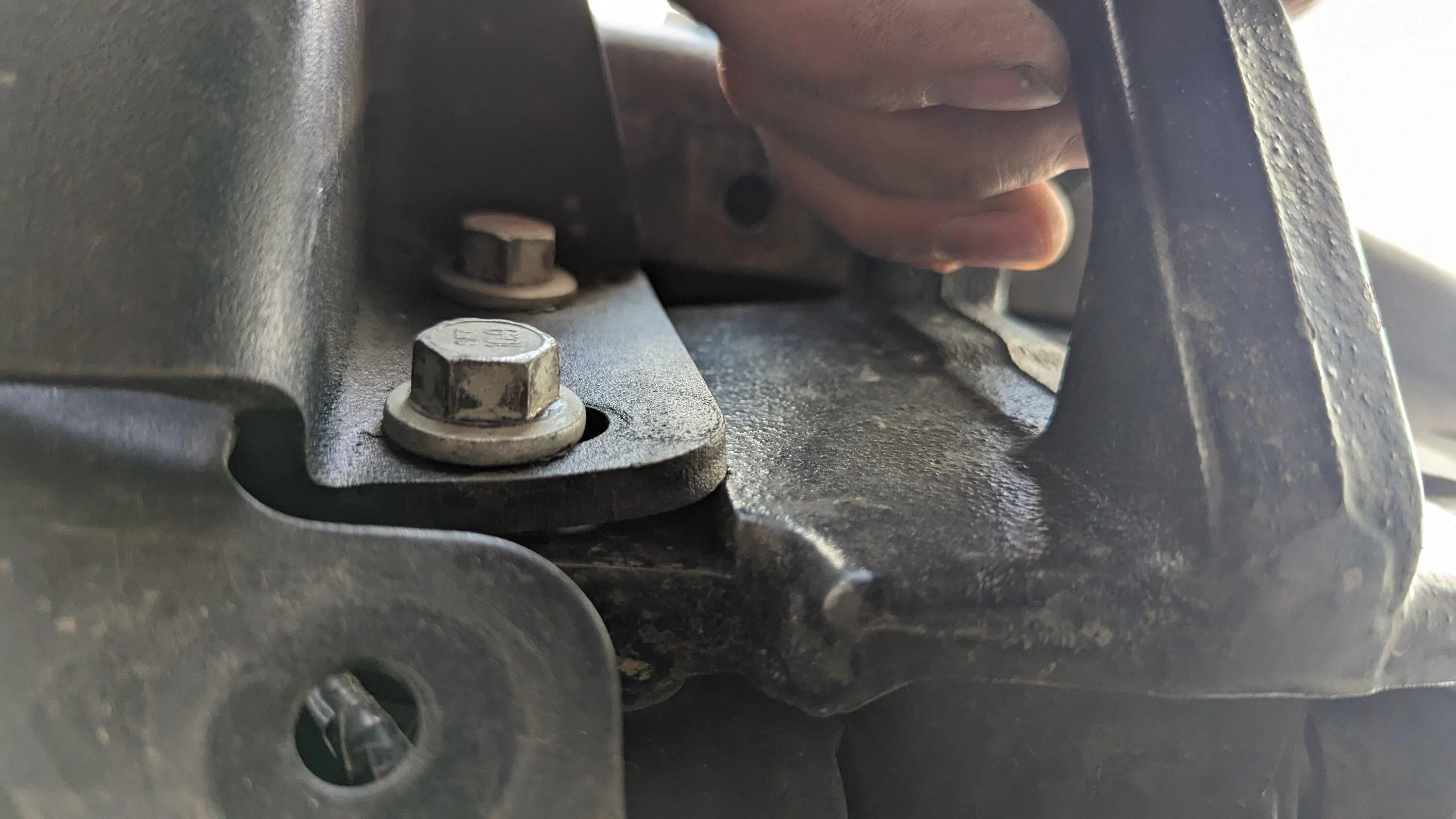

OK....so this is highly embarrassing and I feel like a total idiot but I need to come clean. At least some good discussion became of it and my Bronco is undamaged. I still believe after seeing the DV8 bumper video, this scare, and how Ford does it from the factory, that LOD plates or similar are wise.
I got it dissembled and it turns out this is 100% on me.

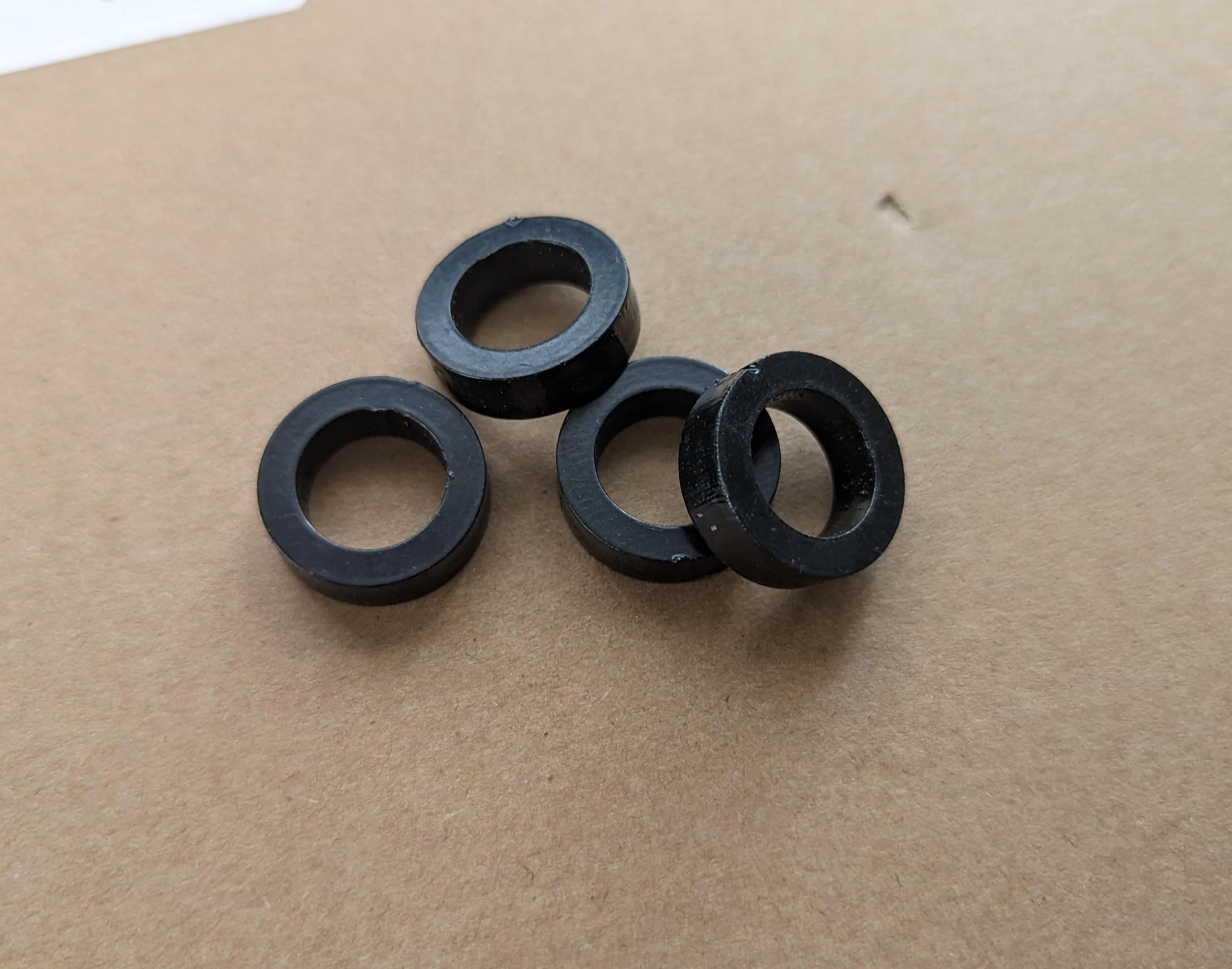

I left out some very crucial parts. I don't know how I missed them, but when I went digging through the old box they were there, shiny and new.
So where do these go and how do they solve the problem you created?

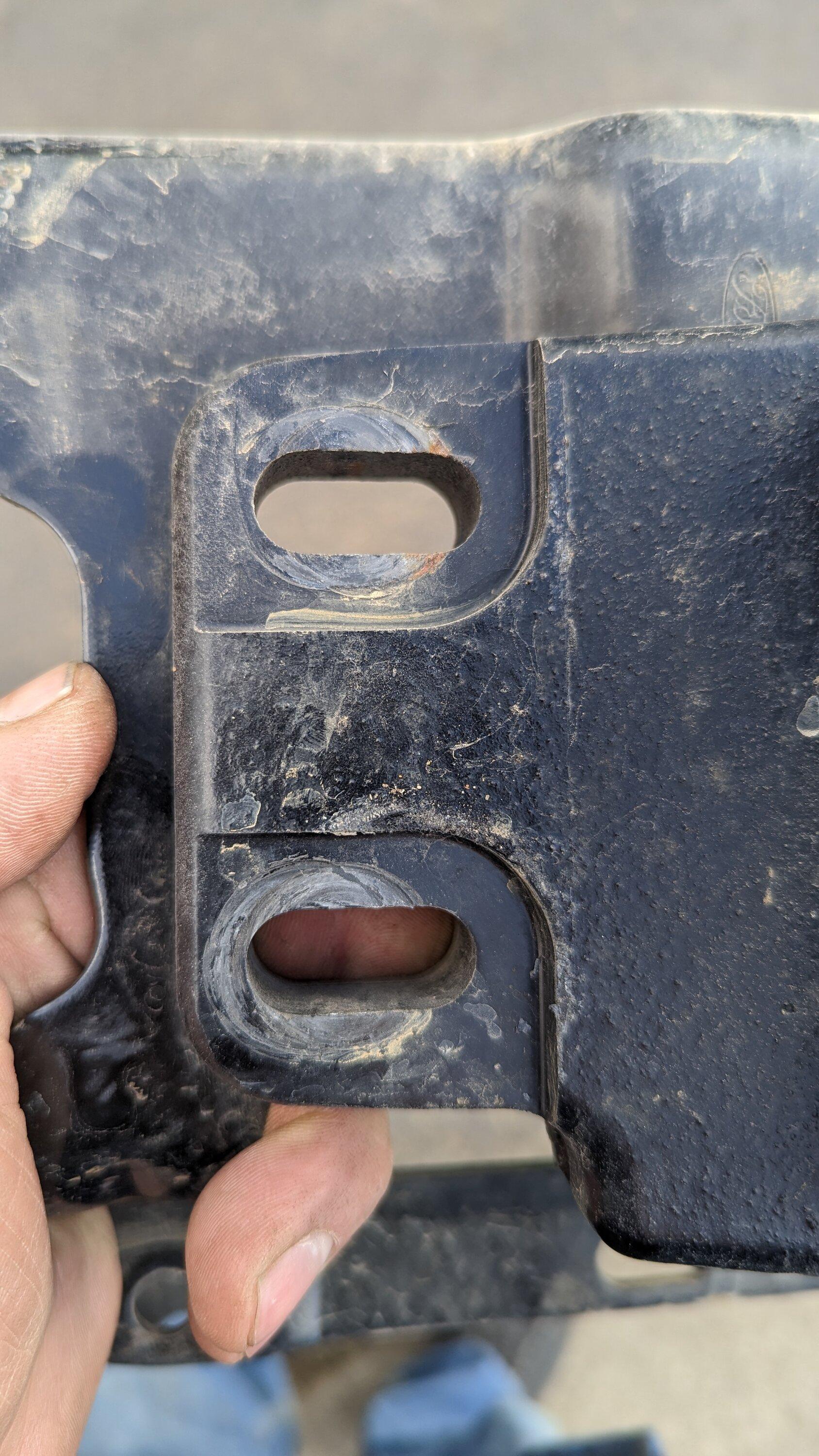

The RC mount straddles the plate which isn't flat. I'd prefer something even more substantial than those little rings and am debating cutting some out.
Gotcha. So in theory, those spacers would have likely prevented the damage to your RC high mount and the frame horns are good? I've been reading through this long thread which seems to be the case. I was set on this winch mount for when the time comes but I'll likely get the LOD reinforcing brackets if they will help.
They would have prevented the RC mount damage I'm sure. Frame? Anyone's guess if it would have still bent. At least the frame tube didn't bend, just the face plates. I *think* the LOD brackets would have prevented that.

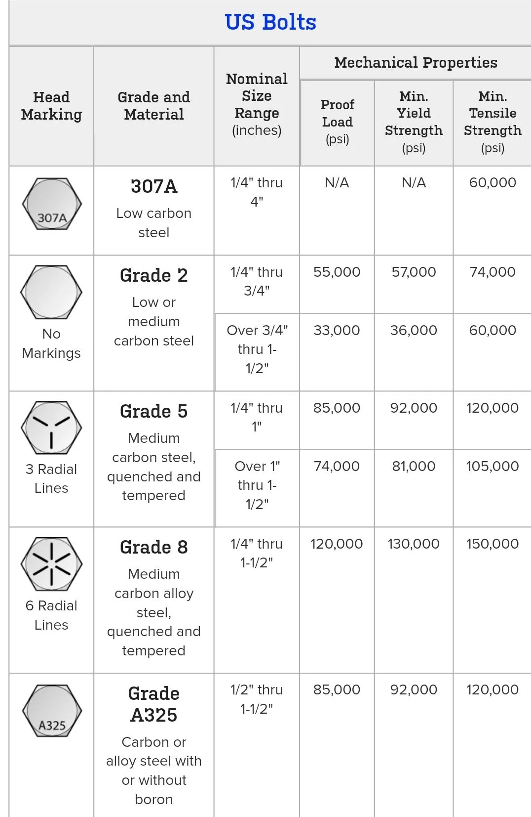

I'm switching to 1/2-13 grade 8.
Why?
You'll create situations where the bolt is so much harder than the surrounding metal it will do its own damage not to mention what it could potentially do if near a pre-designed deformation crease such as a crumple zone.
Grade 2 will work fine in this application, grade 5 for overkill.
