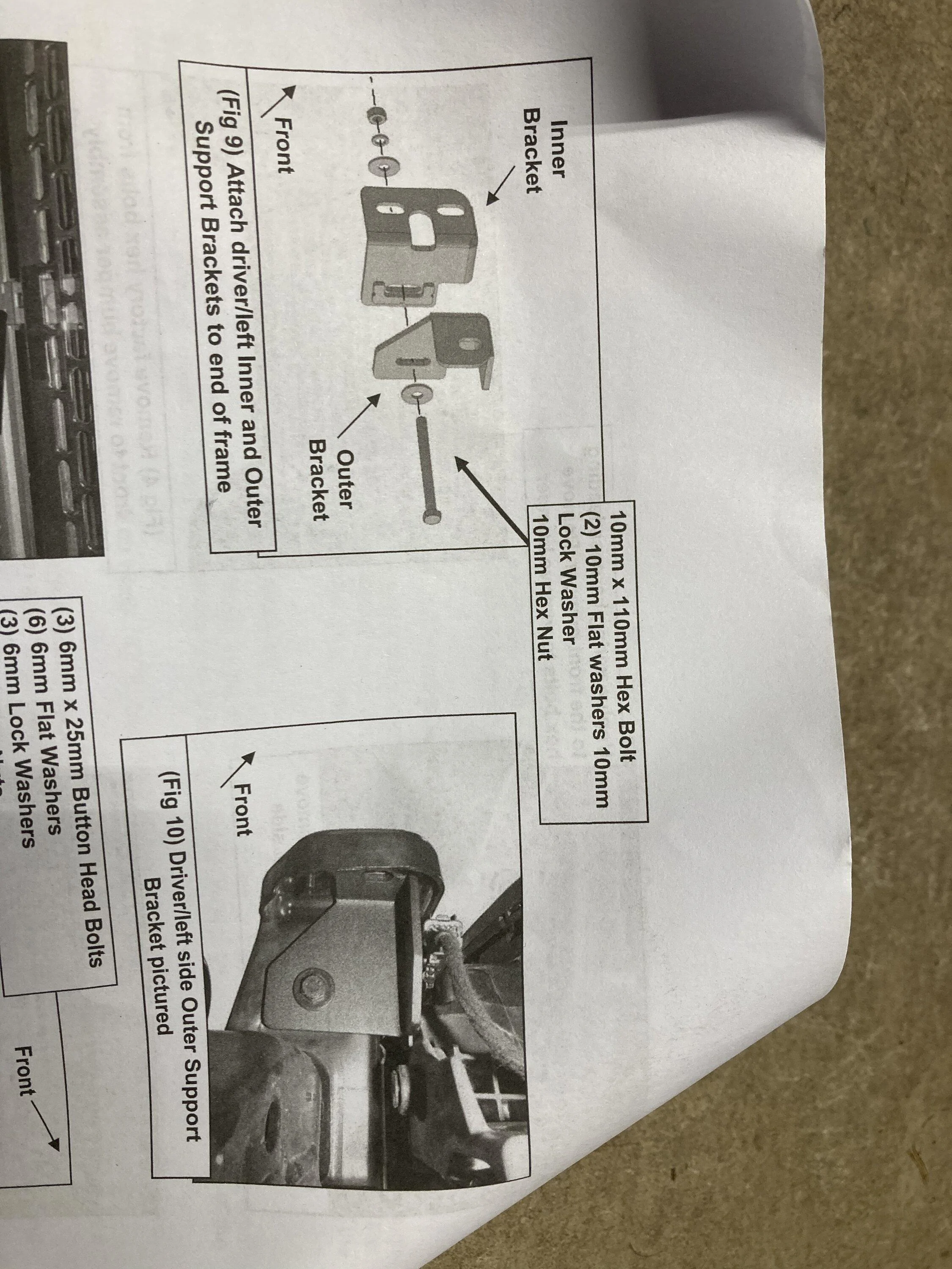

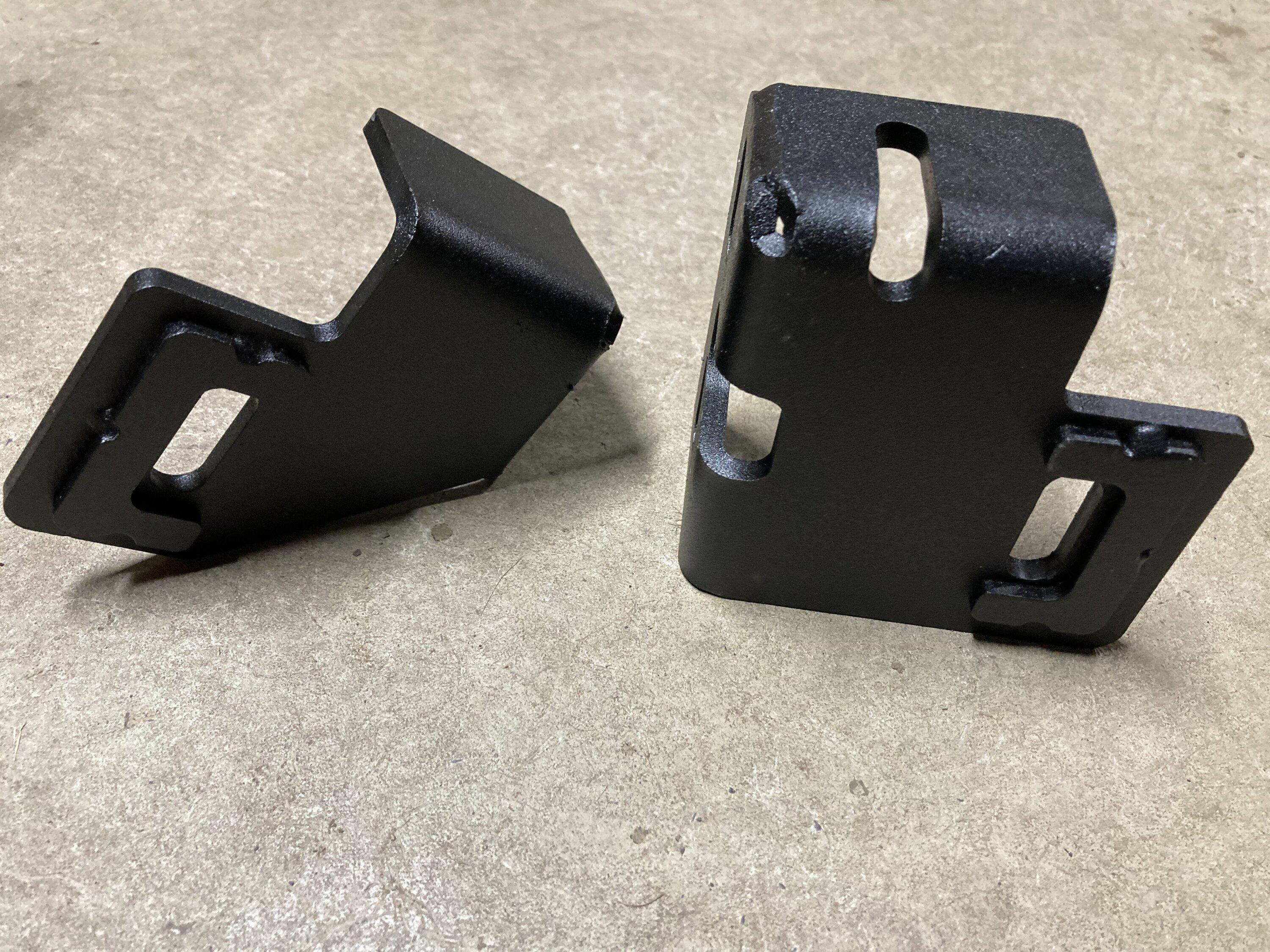

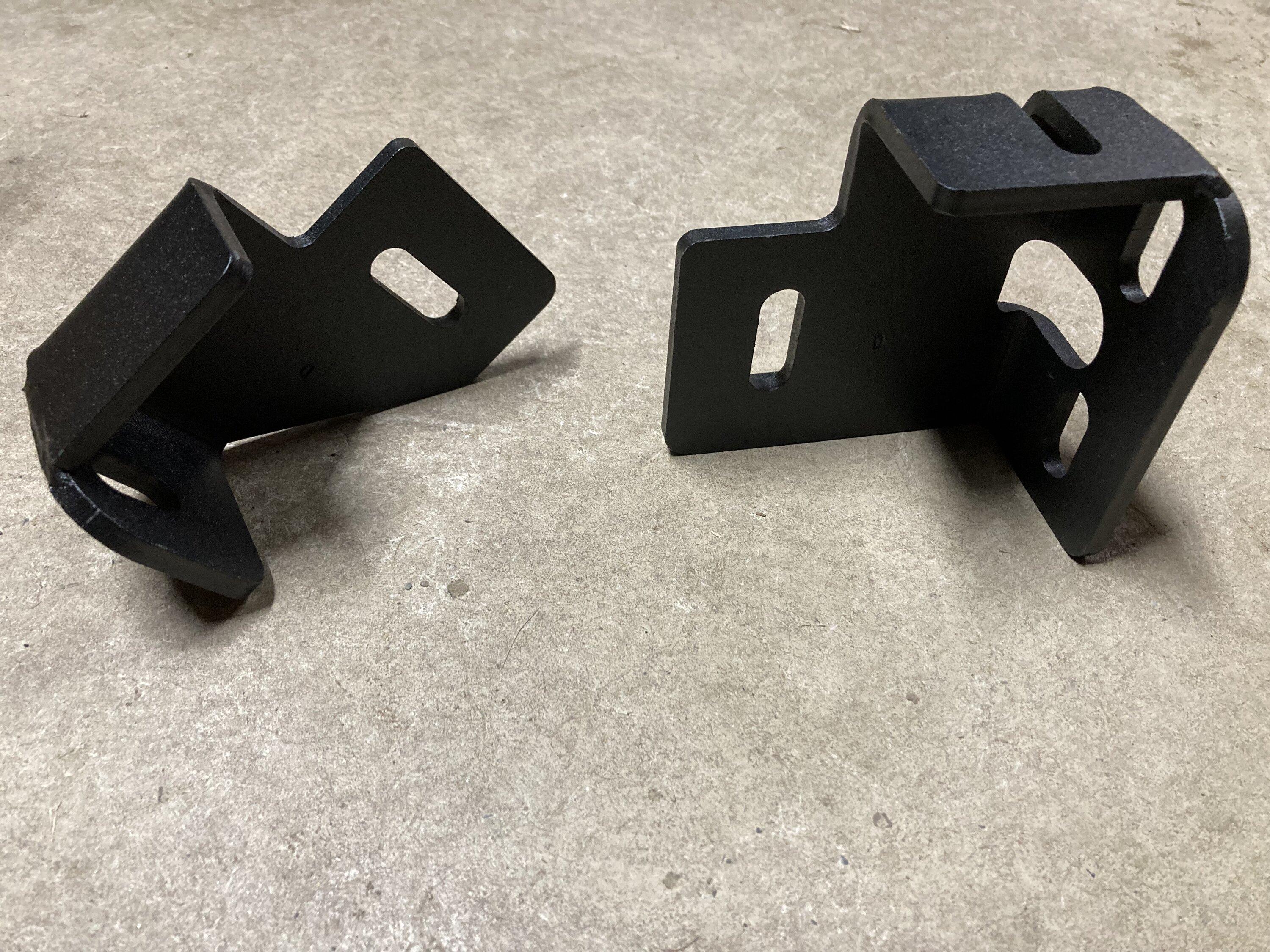

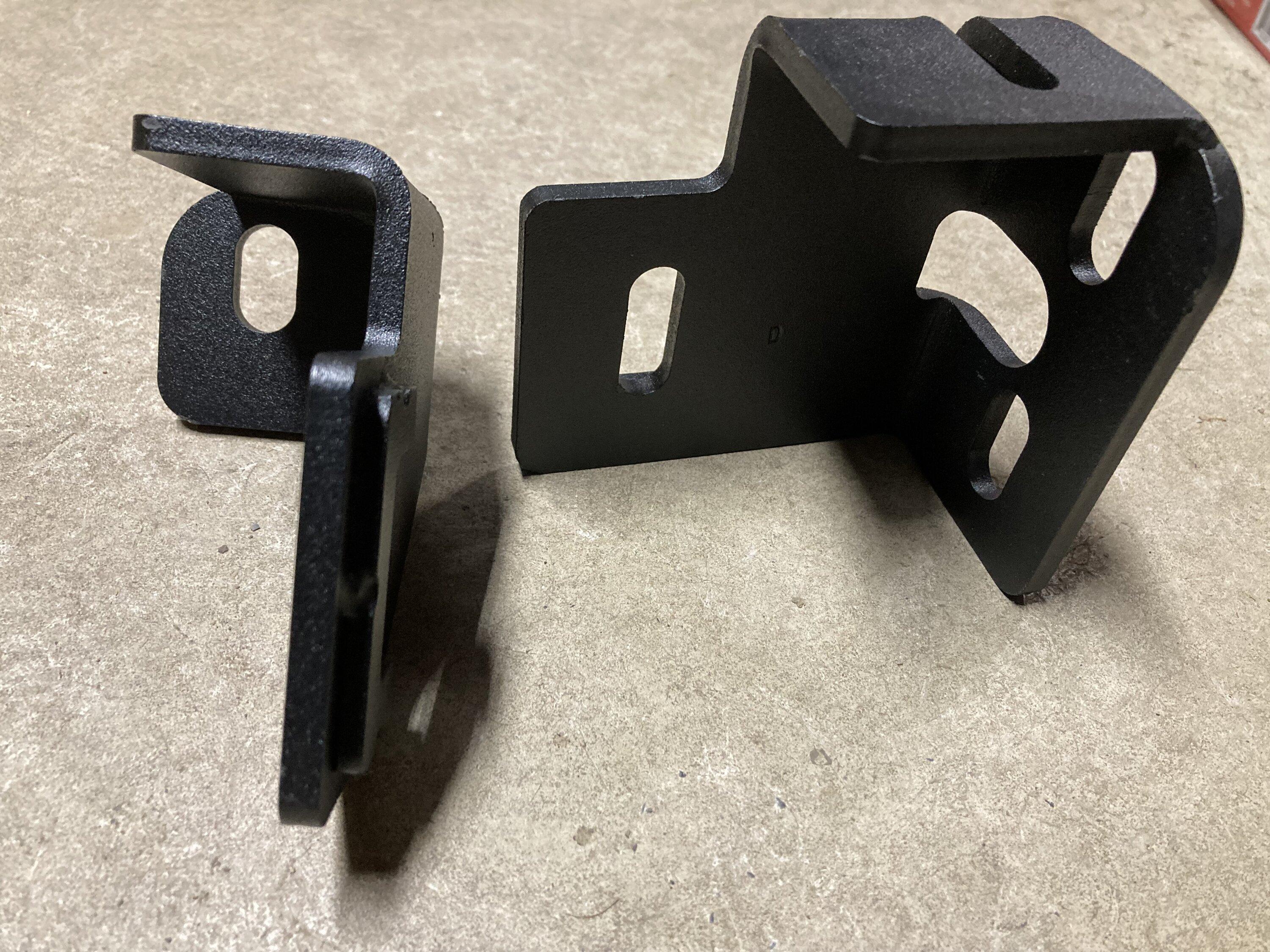

After @Tricky Dick confessional last week I thought I should pull the rest of the parts and directions for my bumper out of the box and check them out. I had previously just pulled the bumper out and started cutting out the parts not needed for the winch to fit, thought I would just figure out the other stuff later.
Low and behold, look what I found. 😮 Even though this bumper is on the "cheaper" side it does not lack in the bumper pad re-enforcement. 😁
Ford Bronco Damage while using winch on improperly installed Rough Country High Mount IMG_0561.JPG
Ford Bronco Damage while using winch on improperly installed Rough Country High Mount IMG_0562.JPG
Ford Bronco Damage while using winch on improperly installed Rough Country High Mount IMG_0563.JPG
Ford Bronco Damage while using winch on improperly installed Rough Country High Mount A322DC4D-1A43-44AC-BCEC-FE7AA712D59A
1/4" thick, "spacers" for the "crumple zone" only down side , for me, is the top of the inside one will need to be trimmed a bit because it will hit the pipe on my HMIC. They should still help quite a bit, and I don't have to make them now. 😁
