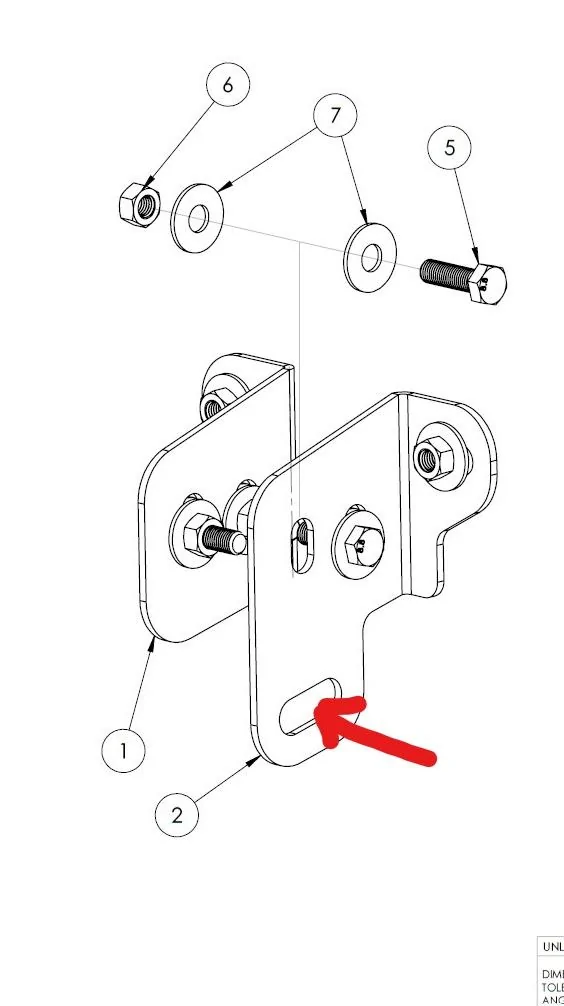

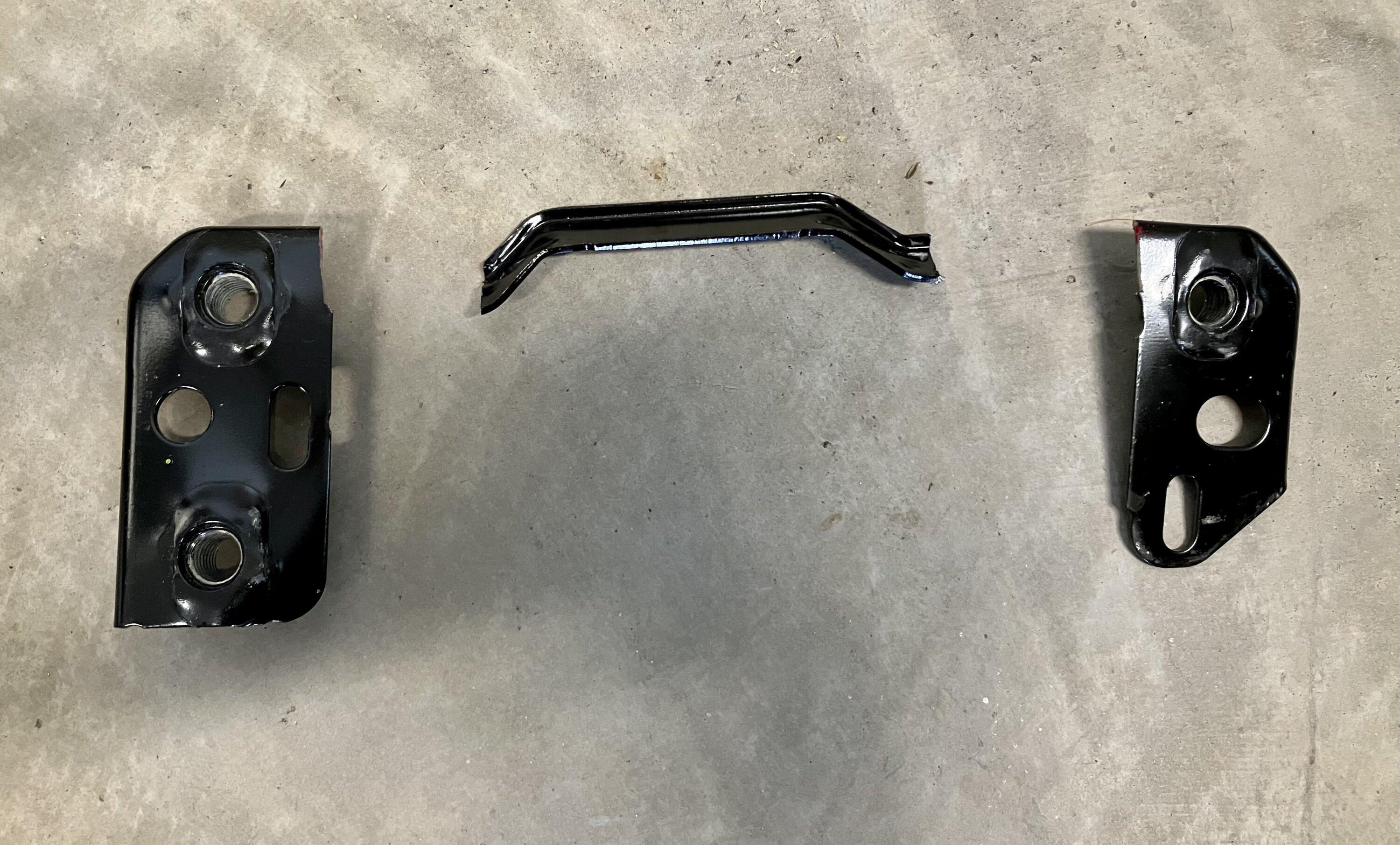

Does anyone know what this slot is for in the LOD brackets? It sticks down below the bottom of the frame rail, but doesn't match up with anything.
It was talked about a few pages back. Have to cut them off to work with the mod bumper.

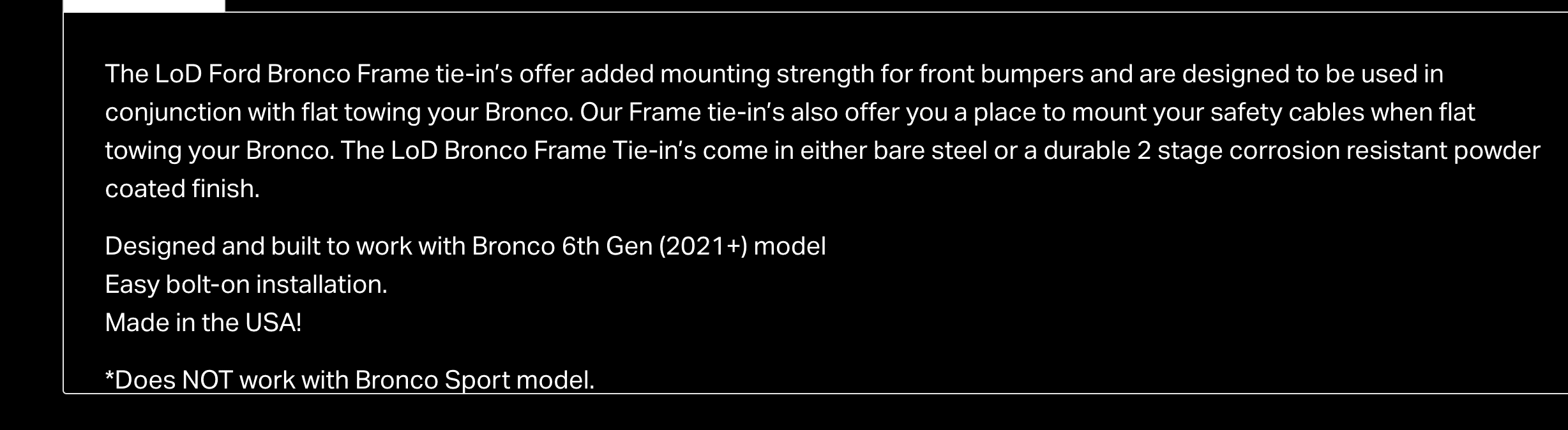

Thanks, so apparently they're for flat towing safety chains.
They appear to fit with my JKS max tire kit front body mount, and my JCR Vanguard bumper and skid plates, so I'm debating about keeping them.

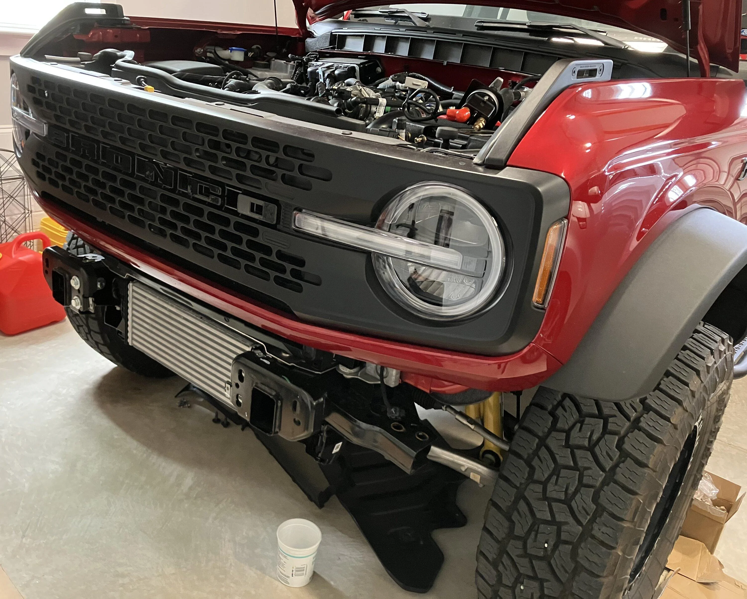

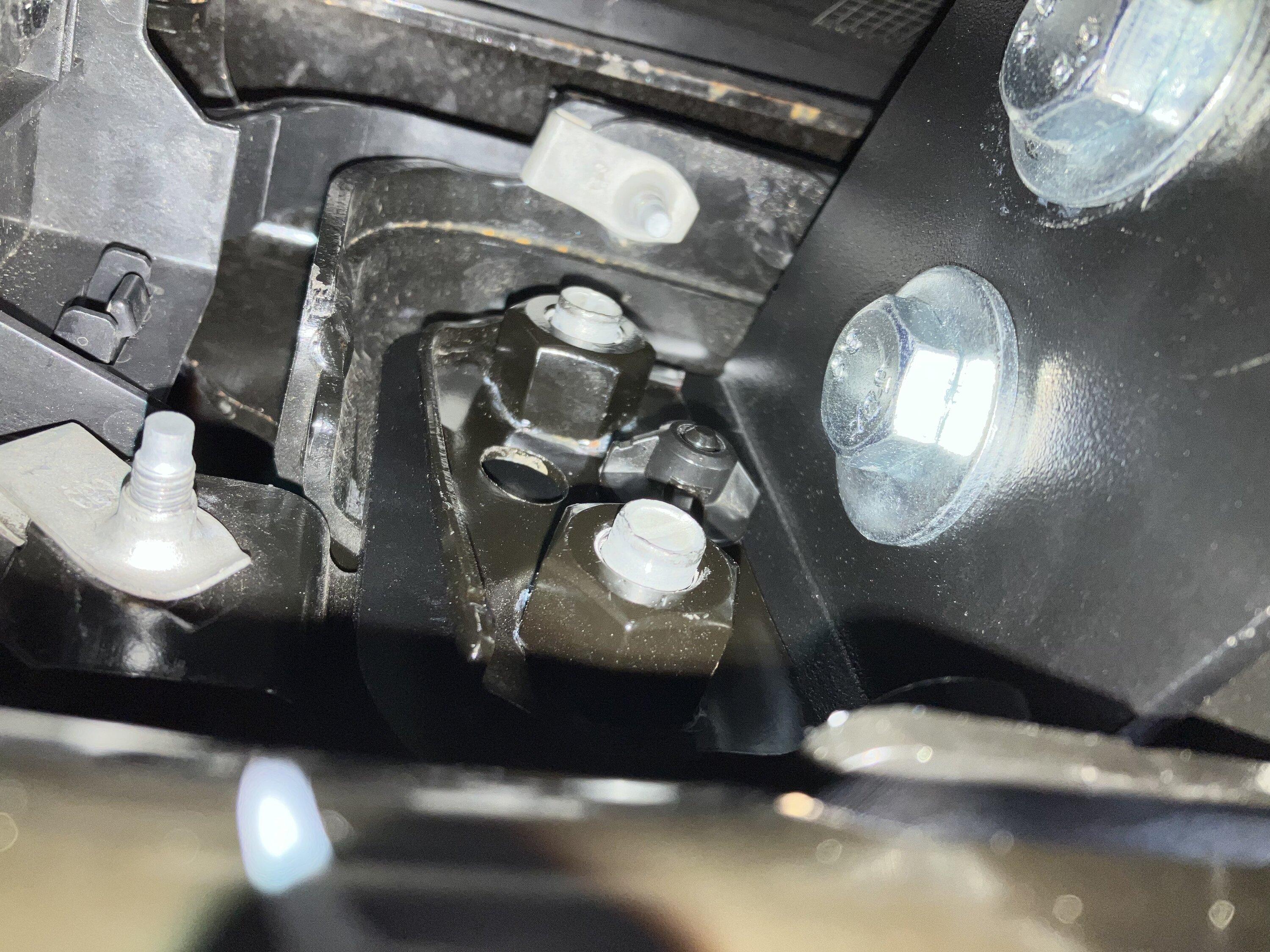

Installed my LOD brackets last weekend and reinstalled mod bumper. Still need to reinstall the winch that I put on 2 months ago. Here’s a pic mid-install …

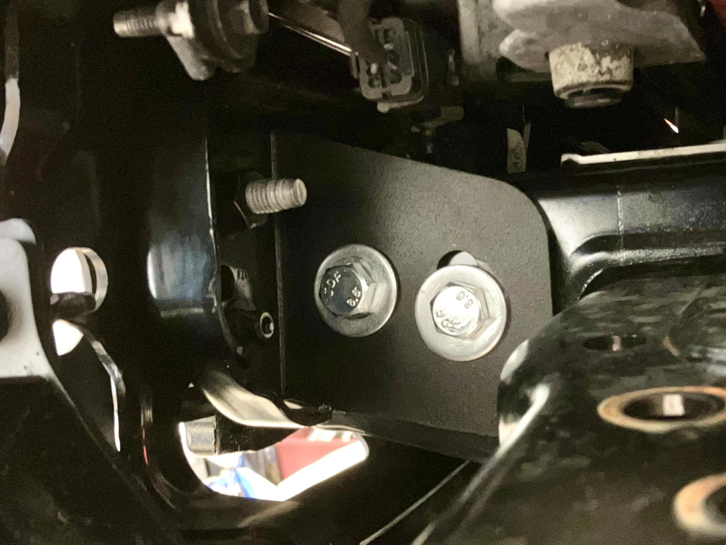

I finished installing the LOD plates tonight. I ended up doing it without removing my JCR Vanguard bumper and Warn winch. It took some manipulating of my arm at weird angles in order to get the washers and nuts tightened onto the bolts inside the frame rails, but in the end it was far easier to do it that way than to remove the bumper, winch, camera, etc. I'm not totally impressed with the LOD plates - I'll definitely swap them out once the OP offers his beefy solution. But until then, the LODs should give me some additional peace of mind when I need to use the winch.

Could the LOD brackets be installed with some sort of sleeve throught the frame so the bolt could go all the way through instead of having to get inside the frame just for a nut?
Also, what did you guys end up concluding about the crumple bumps in the frame as to not smash them when sandwiching the brackets?

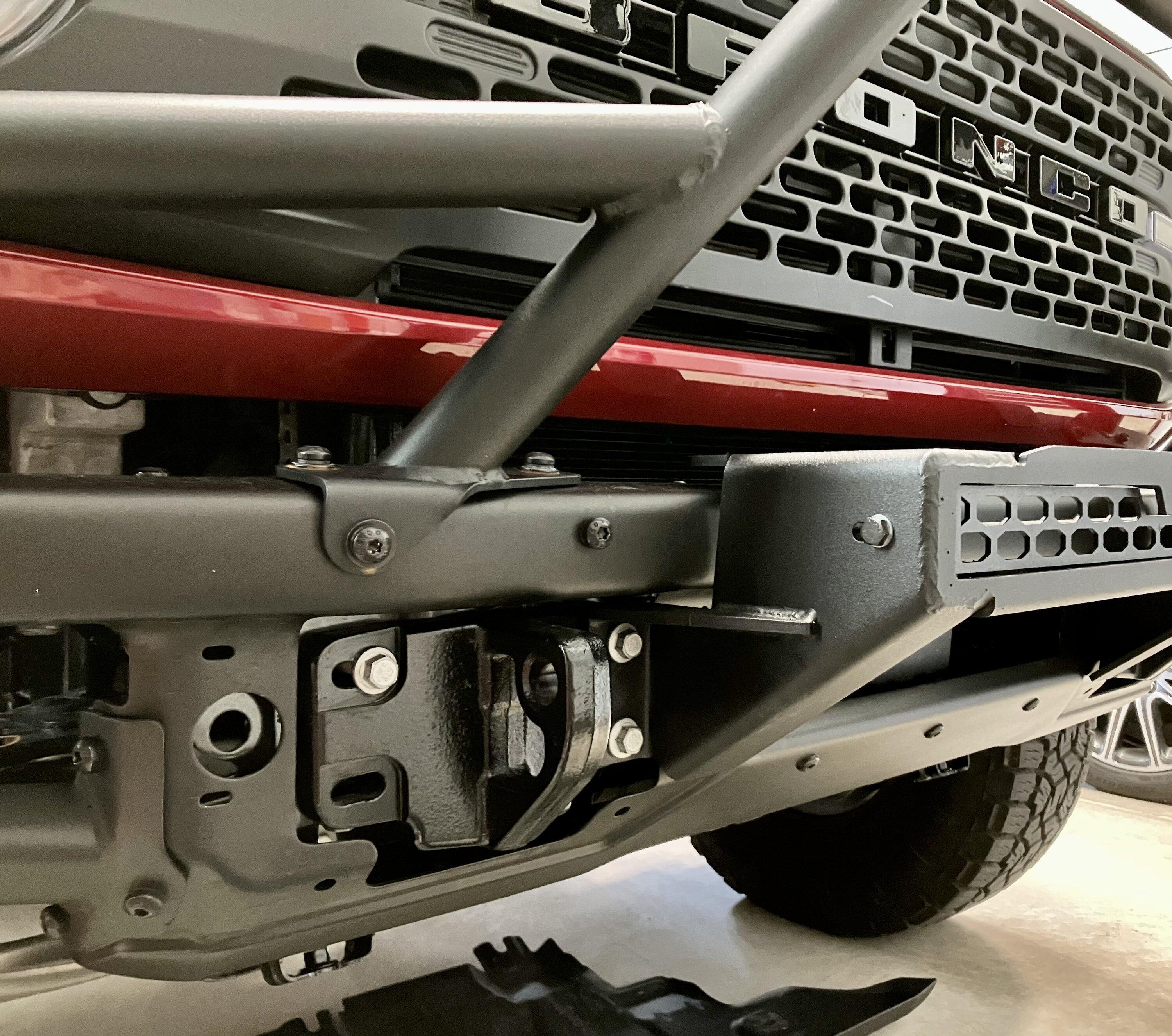

I decided to cut the factory nut plate so that I could use them for reinstallation of my bumper and winch mount. Remember these factory nut plates don’t work with the LOD bracket kit. It’s because the piece that connects the 2 parts contacts the LOD brackets.

The crumple bumps did not deform when I installed the LOD plates. Instead, the LOD plates bent around the bumps. Which is why I'm not overly thrilled with the LOD product. I'm sure it will help prevent the OP's situation, but they are certainly FAR from being a bombproof solution. They need to be made out of 5/16" steel, rather than the 3/16" that they are made from.
And I added a couple final pics
Hopefully with the LOD plates everything is more solid, but my nuts were tearing through the plate, it's just not thick enough.
Wow ok. That’s concerning. I bought high grade washers and nuts (better than what LOD supplied) to go with factory bolts, but chose to use the factory nut plates as I figured that would give more surface area than 1.25” washers. But it’s easy enough to swap the plate with nuts/washers.
