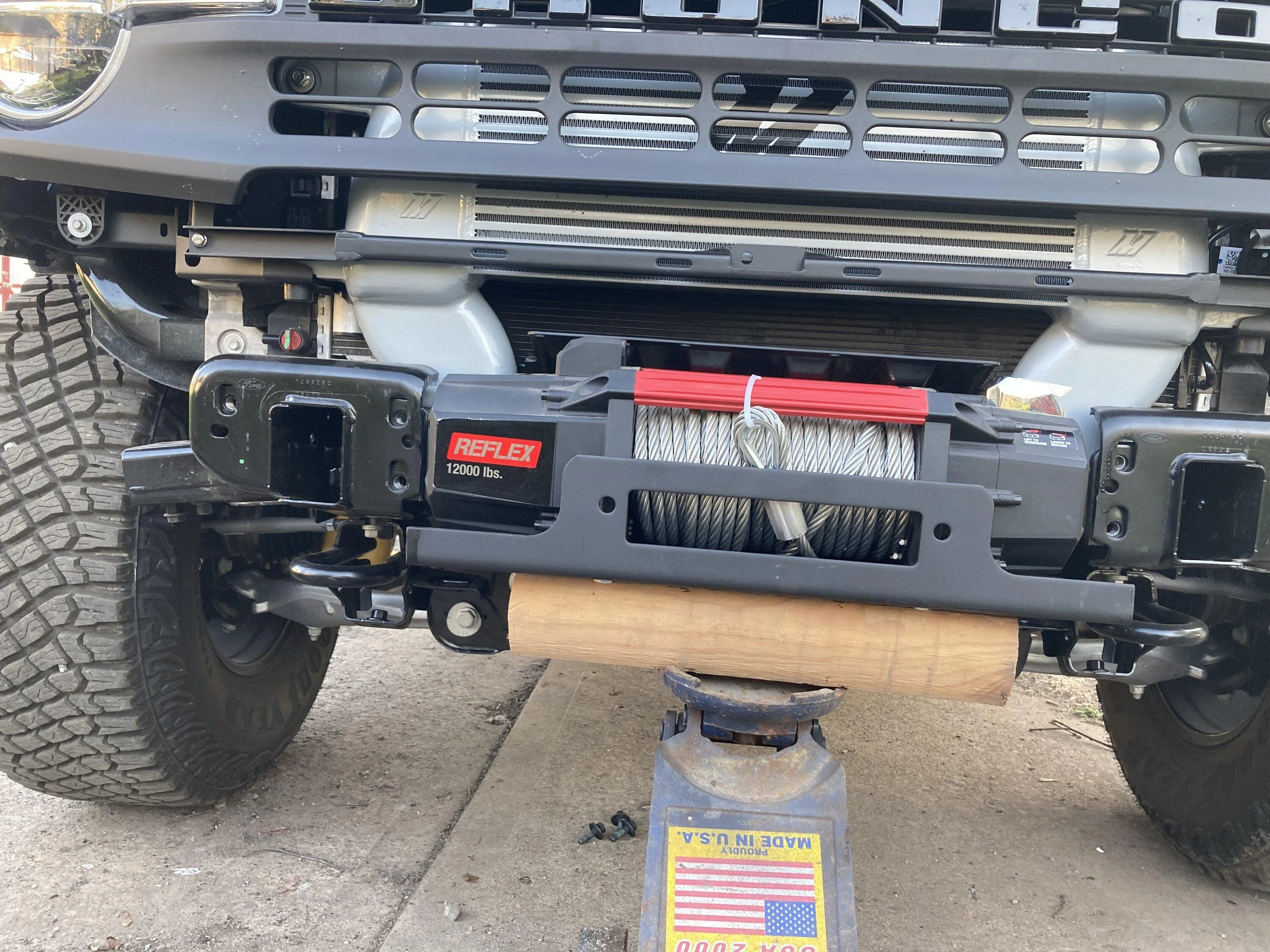

Full investigation and report after I get home, but it appears I bent the mount or horns again. Came down hard on the fairlead and now the mount points upward more and the winch is smashed into the grill a bit.
Well shit
I suspect it was more the mount bending this time but last time I jumped to conclusions it didn't turn out so well.
I'm about over this and will probably ditch the RC. Or gusset the hell out of it.

Wow. This is starting to make me consider one of the hidden skid plate mounts instead because they don’t depend on the frame horns. I would rather have access to the cable release and to see the cable spooling, but it seems Ford made the horns out of tissue paper.
I'm starting to think about that intercooler that mounts higher to set the winch between the frame rails then build my own bumpers front and rear. Getting real tired of banging my rear tow hooks off rocks too.
Maybe even bumpers I can sell...🤔

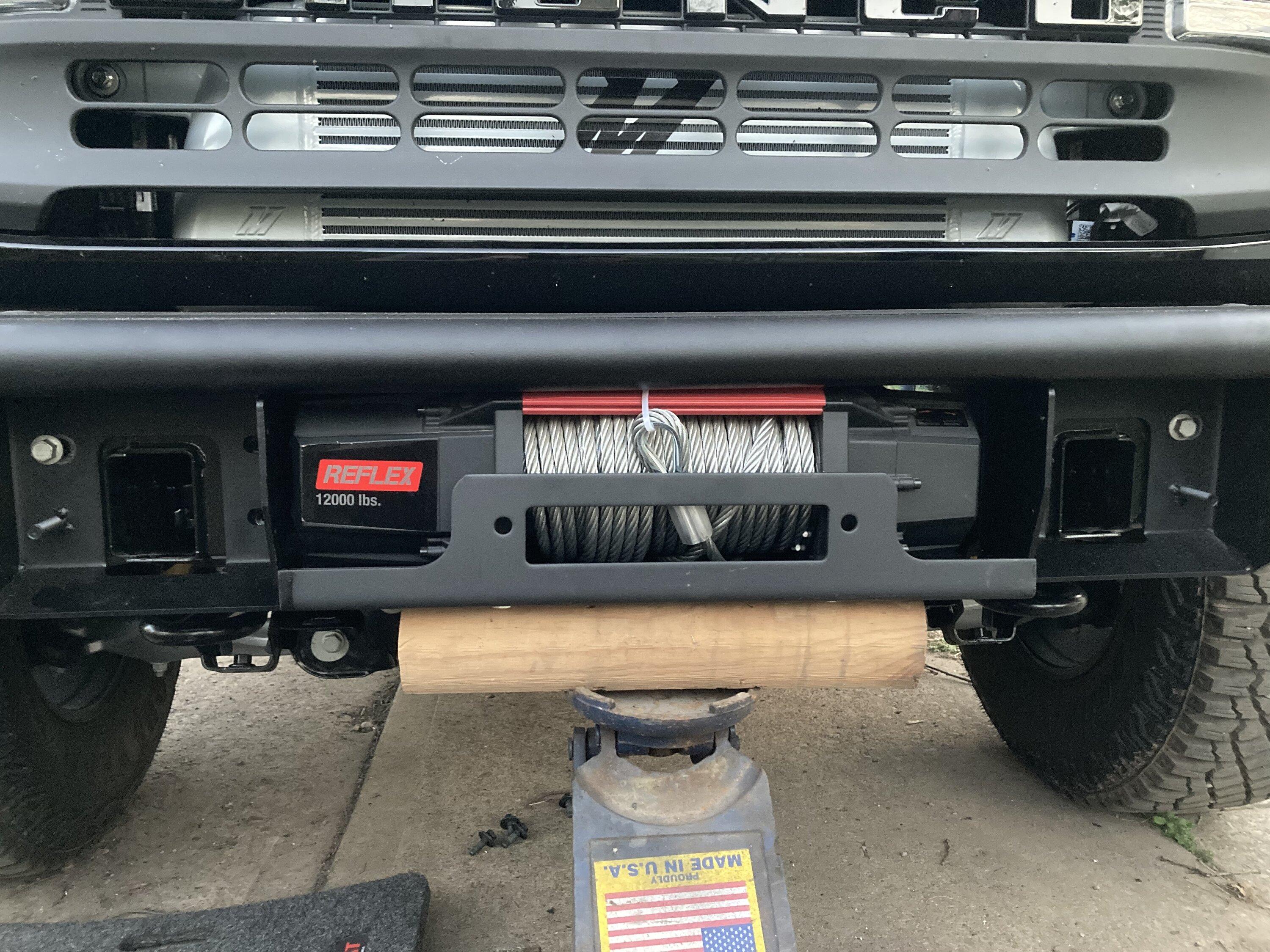

That is likely the best plan, something that centers the pull within the frame and also doesn’t block the front camera would be awesome. I’m not super excited about replacing the intercooler due to potential warranty implications later.
I like the look of the cradle behind the Lobo WNC winch bumper and it doesn’t require moving the intercooler, but I don’t care for the aesthetics of the outer shell and my new in box M-8000S wouldn’t fit. I’m not sure if their cradle triangulates to somewhere beyond the frame horns. Something like this cradle that could keep the mod bumper would be interesting.
I like the look of the cradle behind the Lobo WNC winch bumper and it doesn’t require moving the intercooler, but I don’t care for the aesthetics of the outer shell. Something like this cradle that could keep the mod bumper would be interesting. I’m not sure if their cradle triangulates to somewhere beyond the frame horns.
I think there's a demand for a functional bumper that doesn't look like origami gone wrong.
