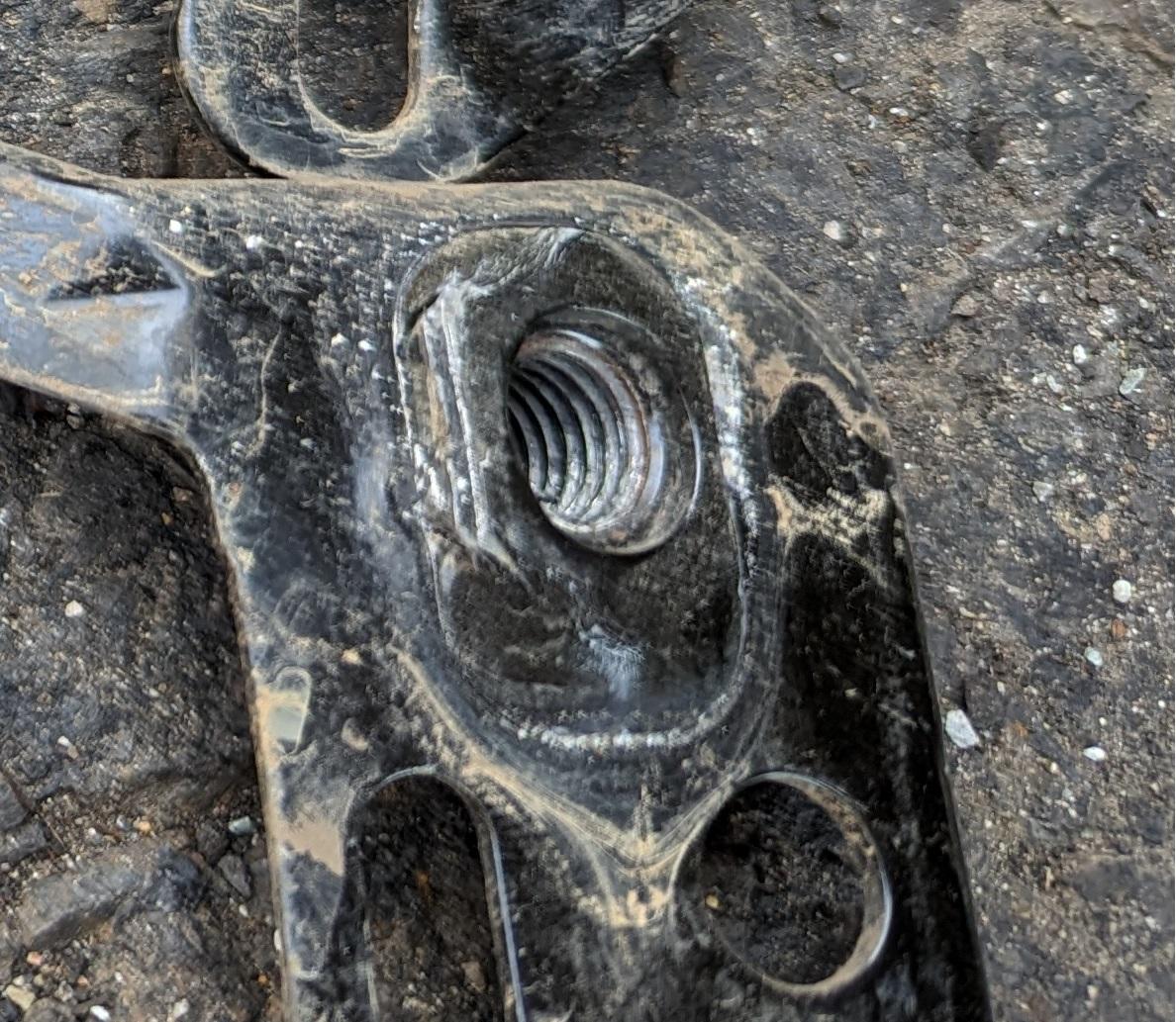

Wow ok. That’s concerning. I bought high grade washers and nuts (better than what LOD supplied) to go with factory bolts, but chose to use the factory nut plates as I figured that would give more surface area than 1.25” washers. But it’s easy enough to swap the plate with nuts/washers.

I discarded that nut plate and went with some thicc fender washers behind the new nuts.

All this talk about nut plates had me wondering what I did with mine. I have the BAMF winch bumper And I don't remember keeping these.
Sure enough I looked at my garage in those nut plates are laying on top of the factory bumper. The BAMF has a solid flat metal plate (aka the bumper) that uses the factory holes but with huge grade 8 bolts, washers, and nuts.

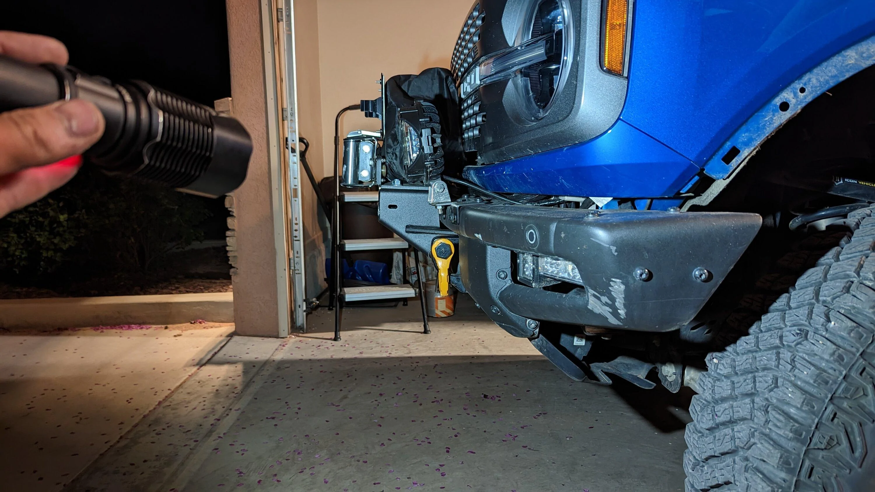

Full investigation and report after I get home, but it appears I bent the mount or horns again. Came down hard on the fairlead and now the mount points upward more and the winch is smashed into the grill a bit.

The lighting wasn't great but I wanted to get something before running trails tomorrow and possibly bending it back out.
Wow. This is starting to make me consider one of the hidden skid plate mounts instead because they don’t depend on the frame horns. I would rather have access to the cable release and to see the cable spooling, but it seems Ford made the horns out of tissue paper.
