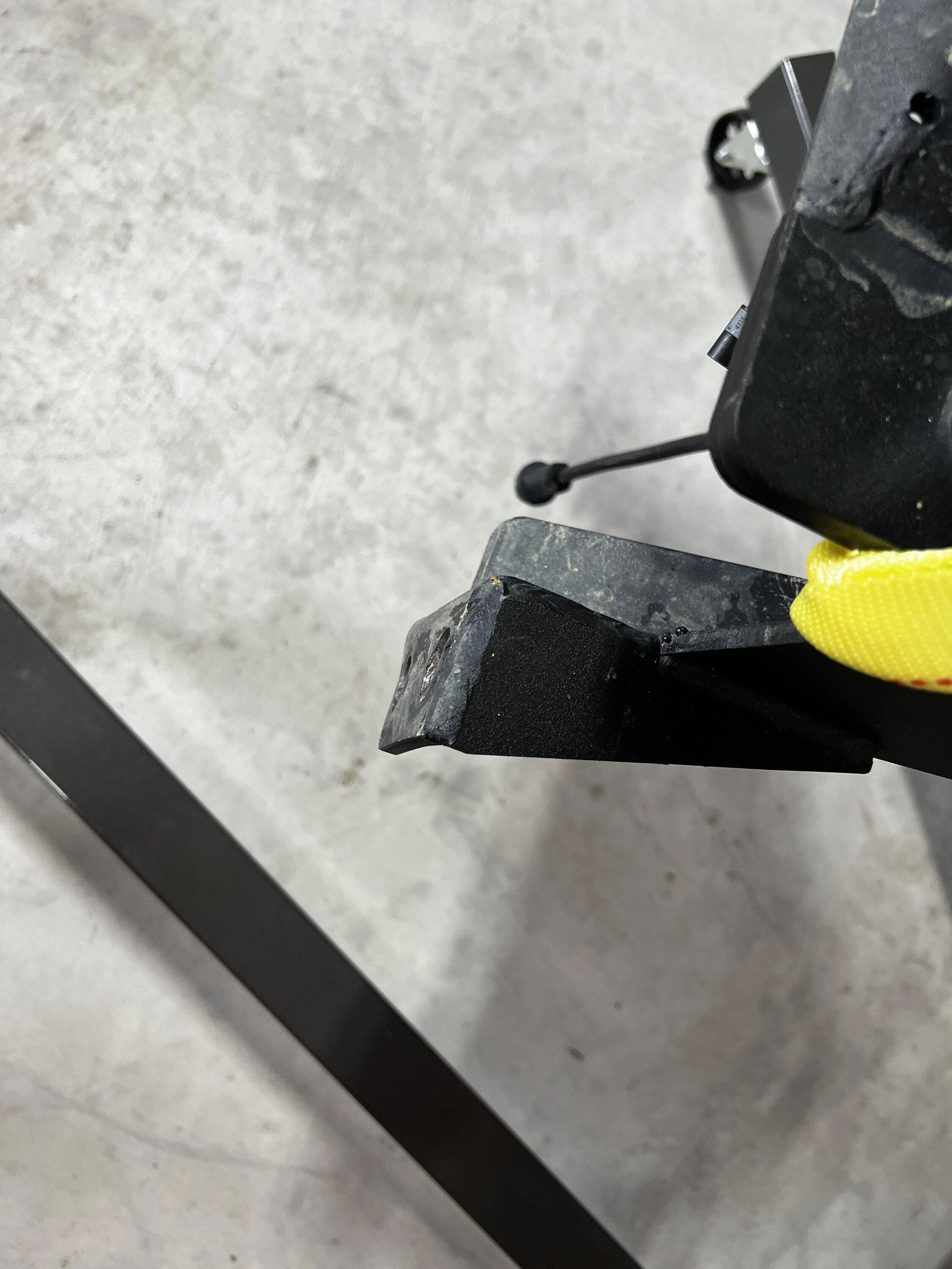

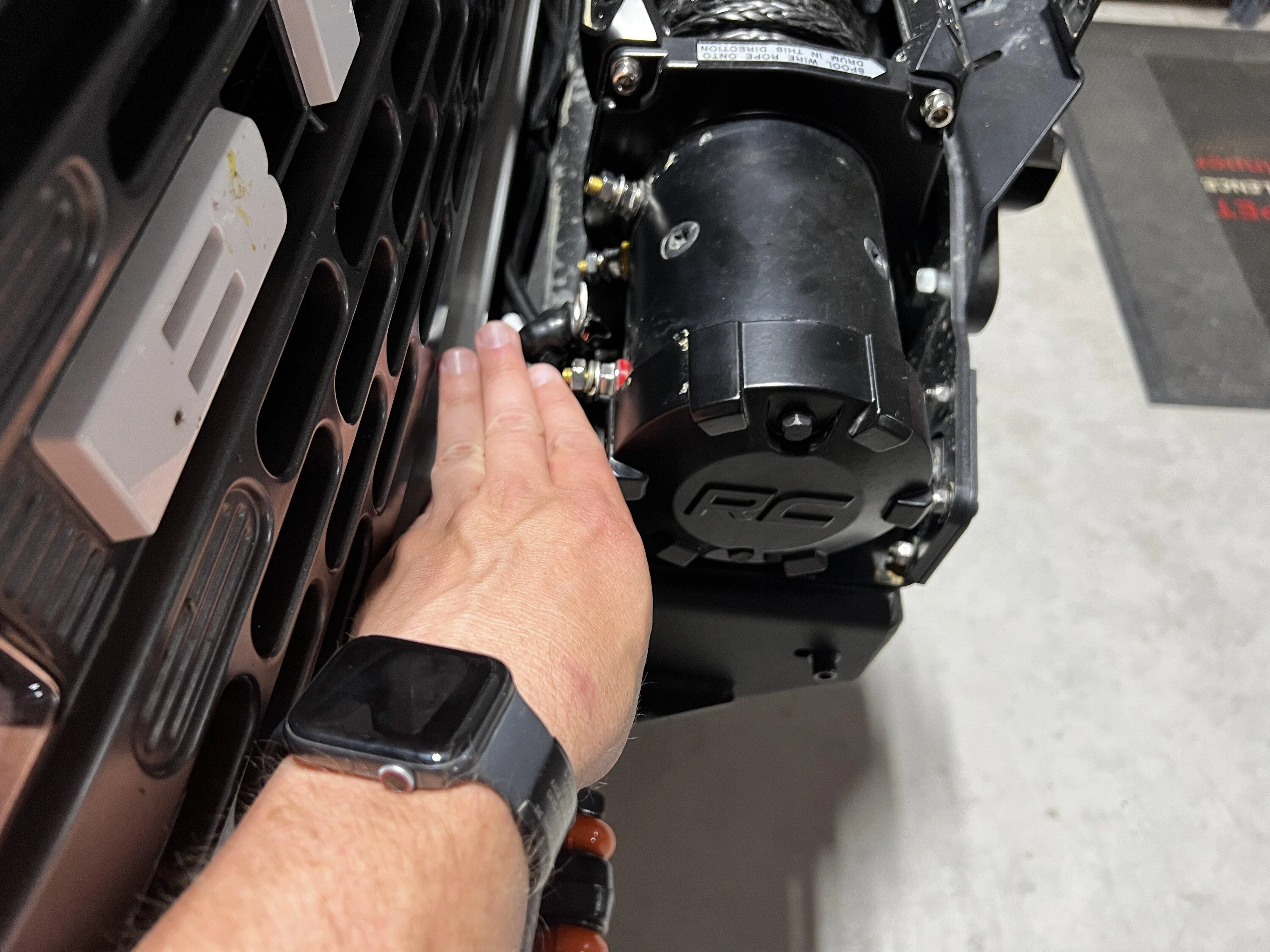

as you can probably tell from the pictures, my mount is pulled forward and twisted a little bit. I planned to take everything off tonight to bend the plates back and mount the brackets. However, after catching up on this thread, I’m afraid that the slots on those brackets are a problem. Those should be holes and not slots. TD will be able to tell us after he gets his off again, but I would bet that the slots slid over the bolts and allowed the bracket to move. Now I’m considering welding the washers onto the bracket to try and help hold it in place. That’s probably not a heavy duty enough fix, but I’m not sure what else to do other than build my own brackets or weld the whole thing on. I’ll think on this more today and try to do something tonight.

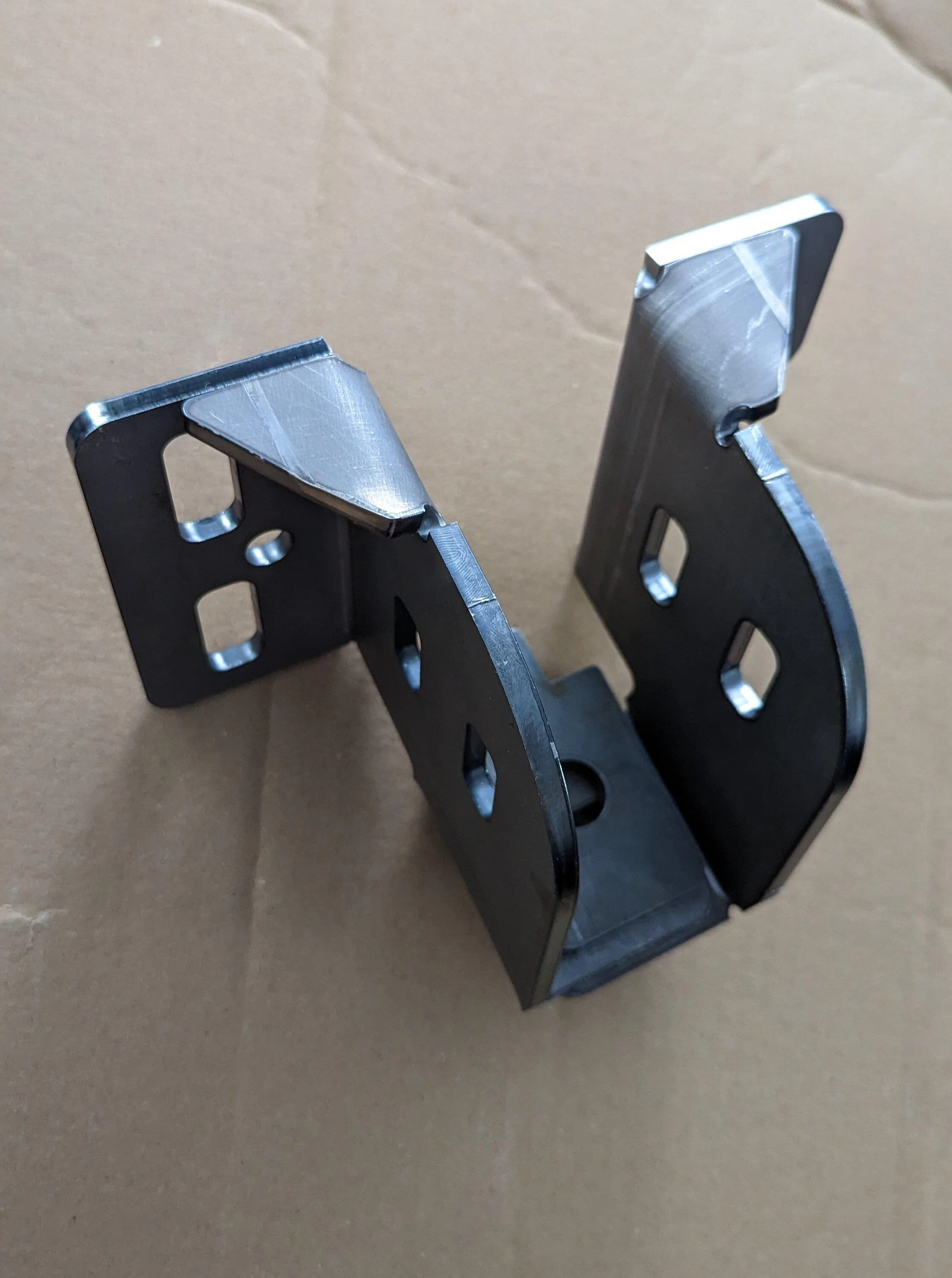

What would make this a super model of the year is if it had the same dog ears at the bottom as is the top.
It's on the table depending how the prototype fits. I forgot to order the weldnuts so I won't be getting into it until this weekend now.
I think just my mount is tweaked this time, one corner definitely is twisted up higher than the other. I'm going to run with it a bit longer while I plan out a bumper but I'm going to beef up the RC mount a bit because it's too light duty.

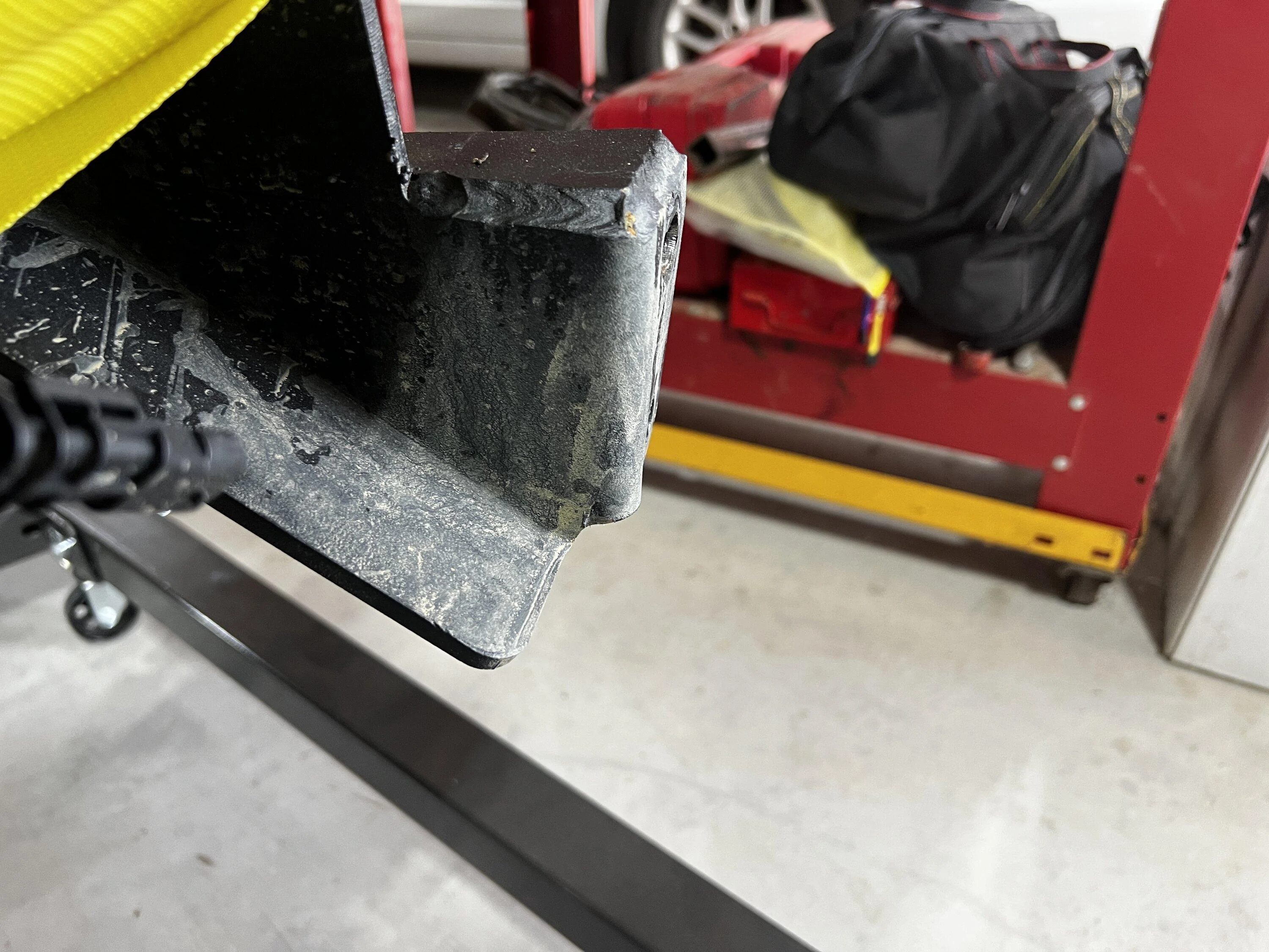

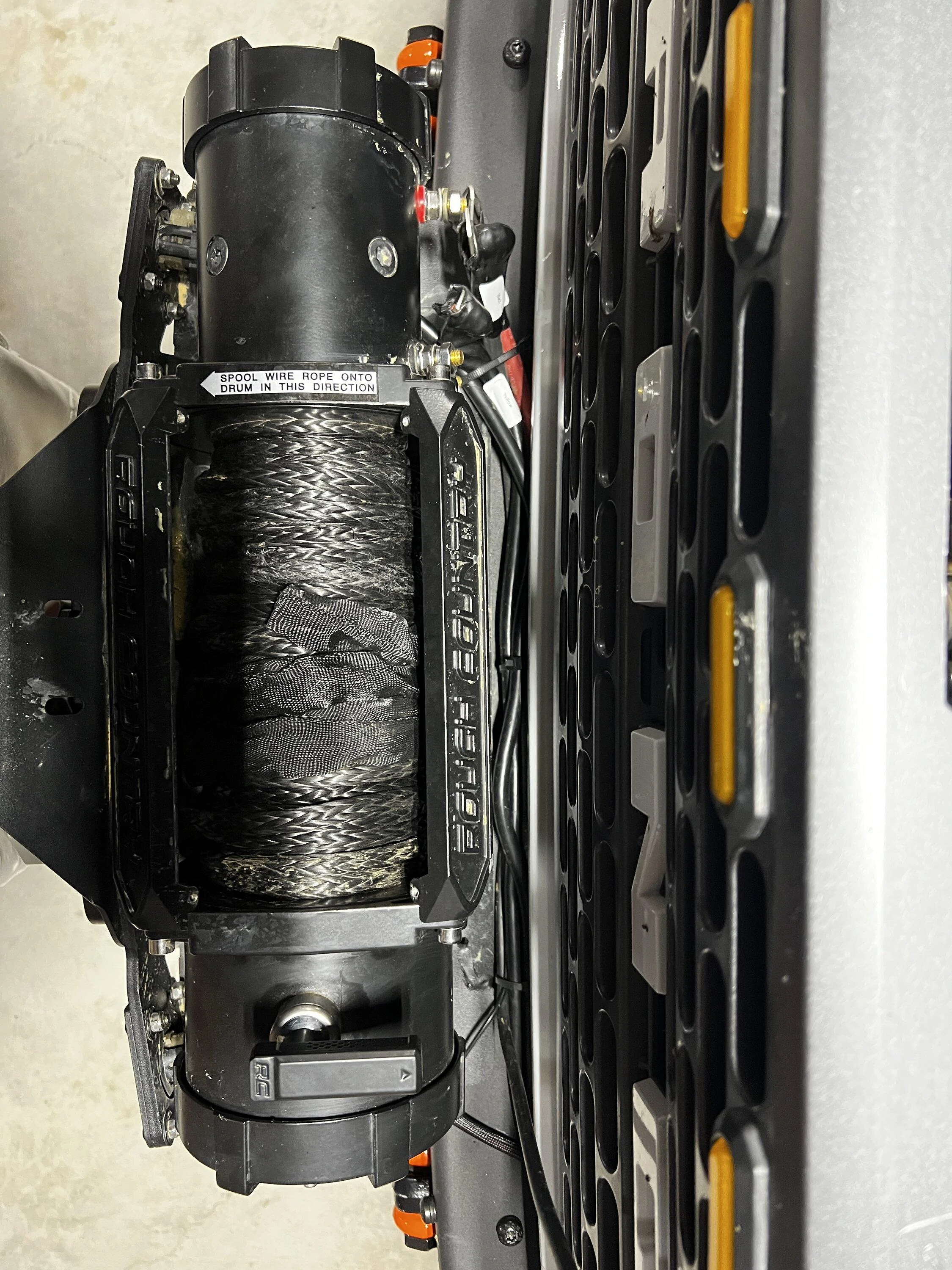

Well it was a little worse than I thought. The bumper plates are off a bit on the passenger side especially but the bigger problem is the winch mount.
Ford Bronco Damage while using winch on improperly installed Rough Country High Mount 429EF050-A9D6-495B-A2A4-3218DEC767CB
It’s twisted pretty bad. No fixing that.
Ford Bronco Damage while using winch on improperly installed Rough Country High Mount 89F821E5-A01D-4F91-BF64-95A328F6F4FA
However, I called Rough Country, they answered right away and they’re sending me a new one tomorrow. Just wanted pictures of the bent mount. Service was much better than I expected.
The bumper plates were pulled out on that side too. I bent them back as best I can but to get them all the way back I’m going to have to use the frame brackets to pull them back and hope that works.

The prototypes are welded up and ready to test fit tomorrow. I'd love to have a first run to sell at the Stampede in 2 weeks but it's going to be tight.
